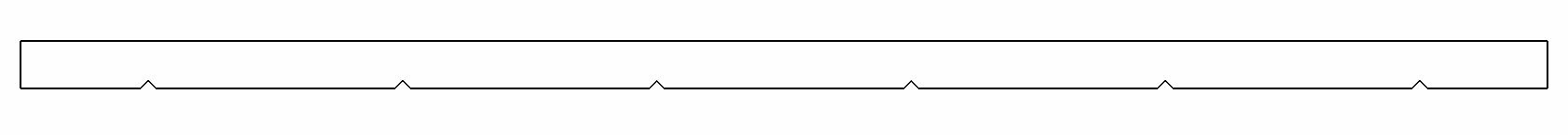

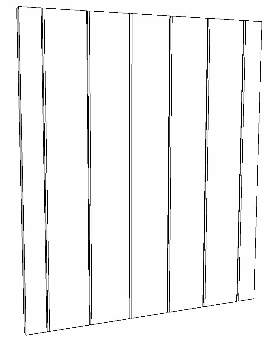

Looking for advice on the best approach for a client who wants painted slab cabinet doors with a vertical v-groove. We have always built 5 piece doors so this is new territory for me. We use a CNC in the shop and my initial thought is to cut MDF for the doors on the CNC, but I have never produced 100% MDF doors with no rail/stile. We use MDF for our paint grade 5 piece door panels so working with MDF isn't new, but I am worried about the durability of the edges as well as the finish quality. Any advice?

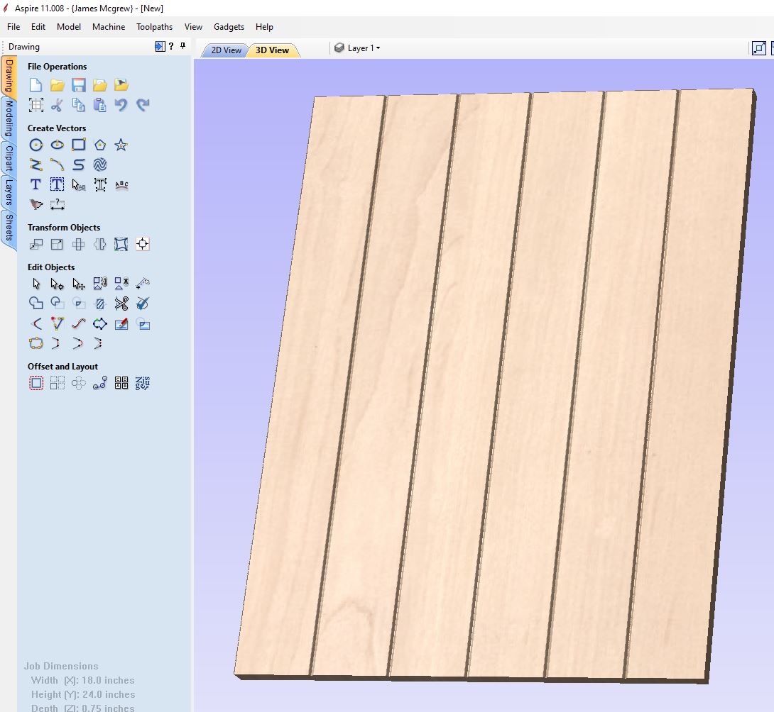

Simple enough, I use Vectrics Aspire yet the lower tier Vcarve pro or any software capable of following a single vector line will do this. you could cut all the doors including the v bit work from full size sheets it you have a cnc
Take a look at Vectric .com vcarve or vcarve pro, no need for aspire unless you intend to make and work 3d (2.5d) files
