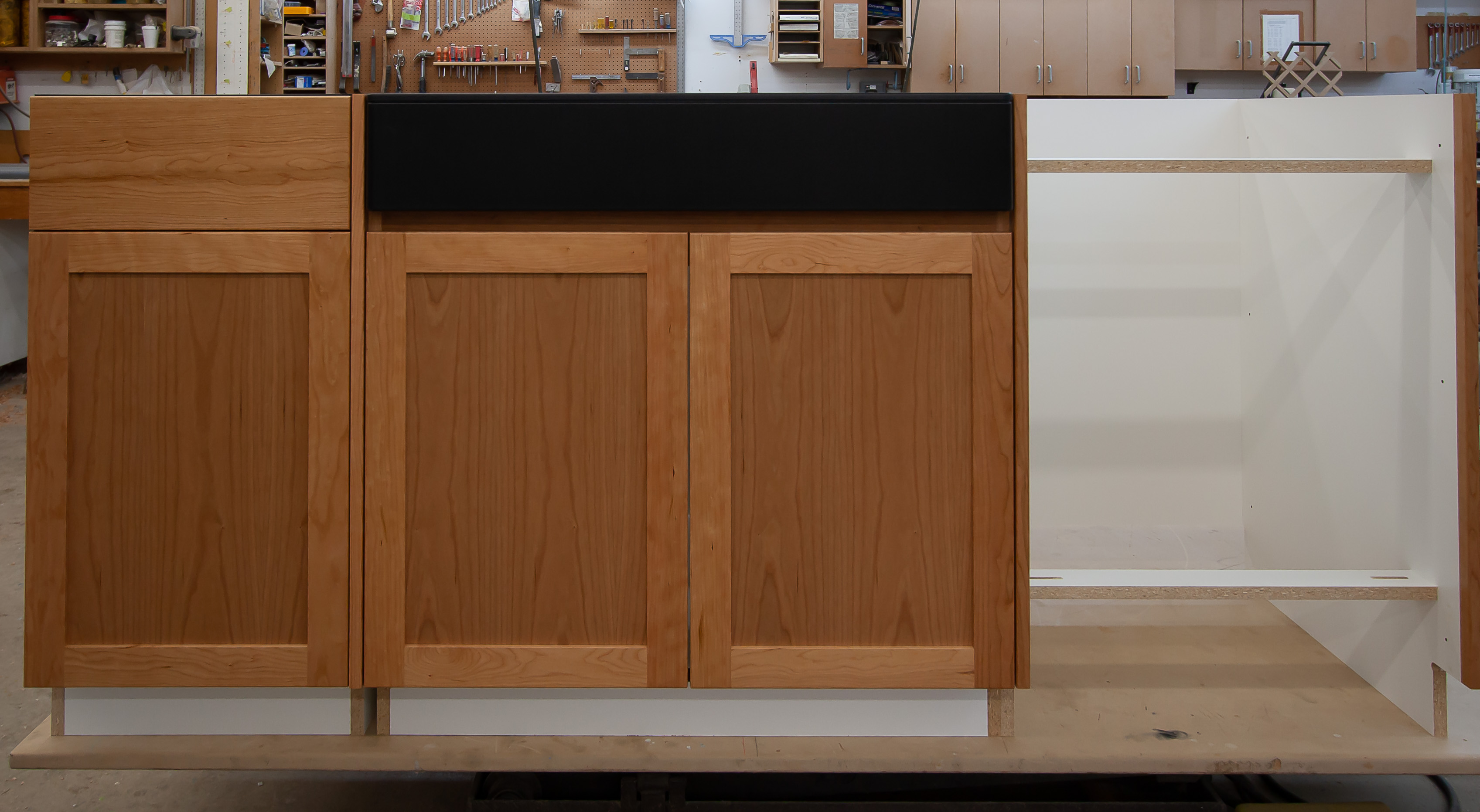

Bruce H
Keep it simple. I make a base cabinet the width of the sink and short the cabinet height for the sink height. Apply a trim panel each side. I have a top rail just under the sink which allows the doors to be within the 32mm spacing.
View higher quality, full size image (3394 X 1863)
