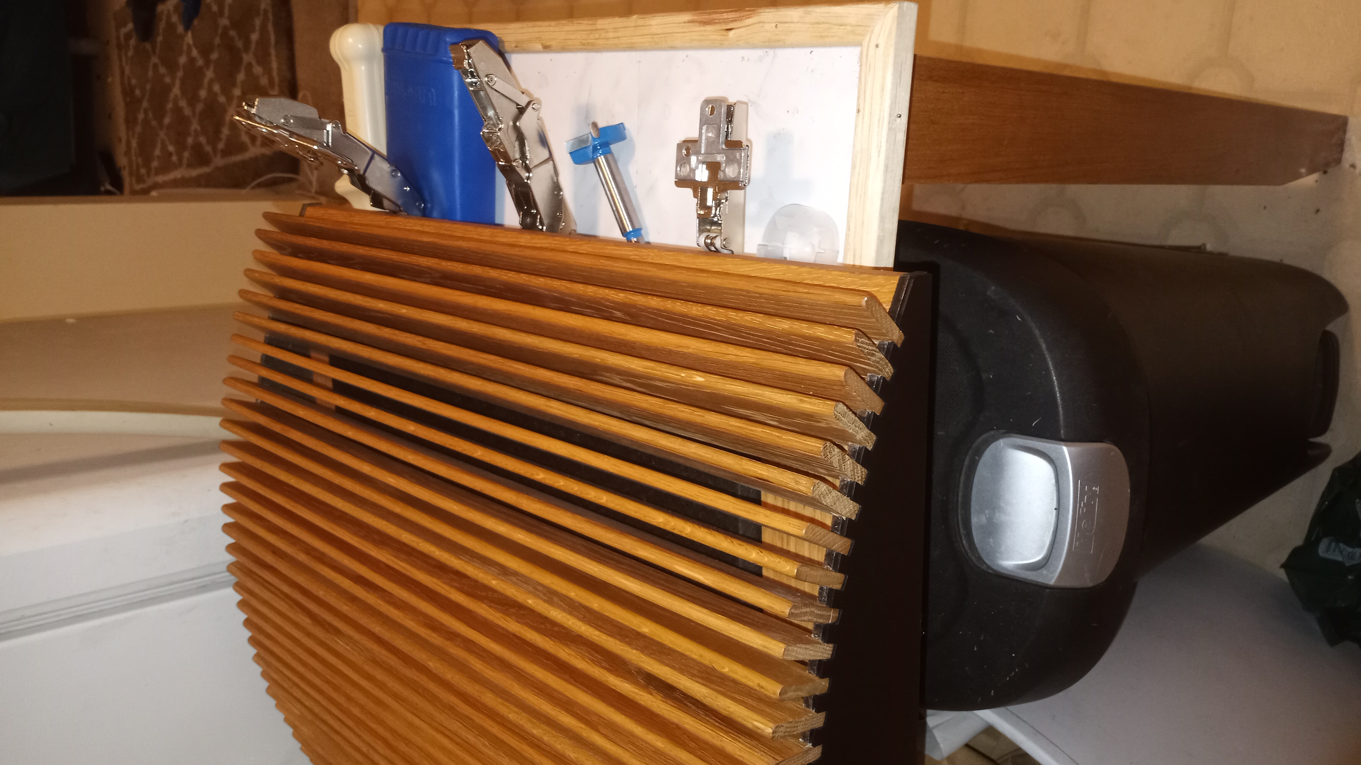

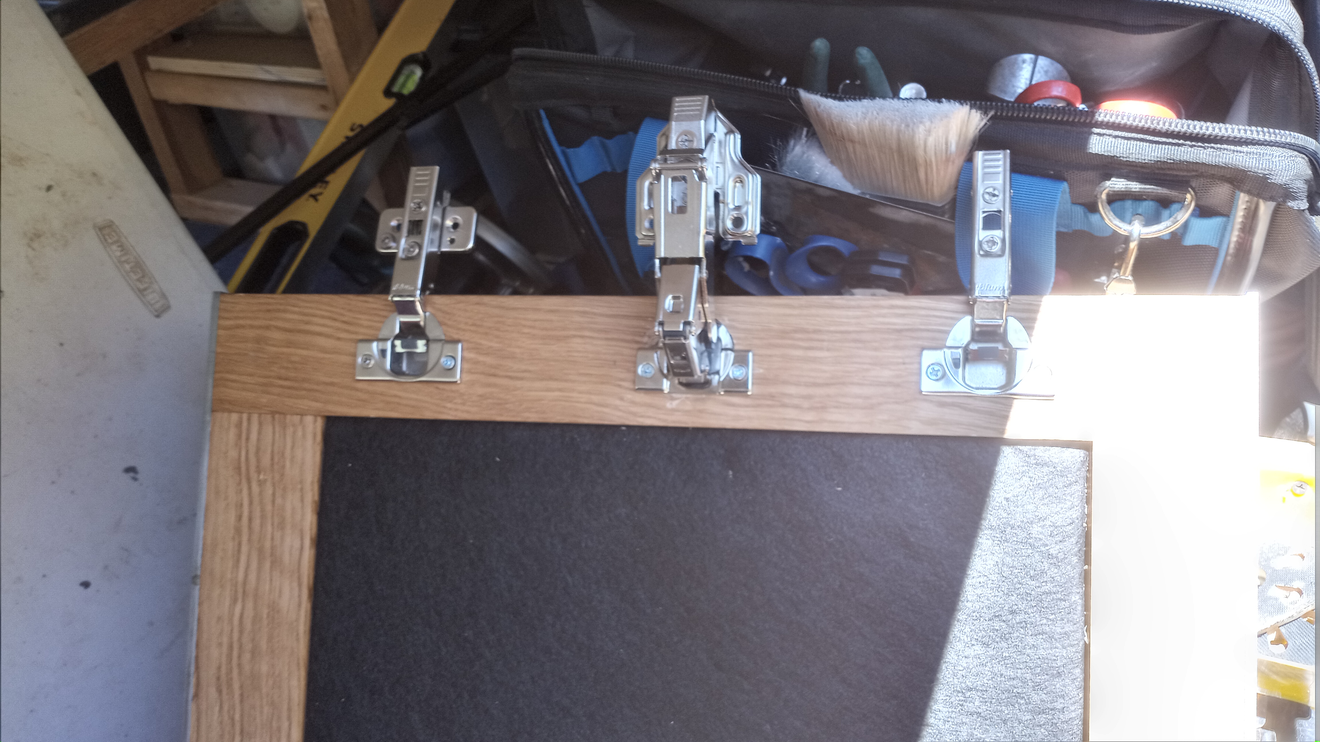

I need to find a jig for a concealed hinges where the edge goes out further than standard . I have a kreg jig that goes only to 6mm...most online are the same. I need 8mm at least

I have a drill press, but this isn't going to work with this particular job. The cabinet door is rounded for a stereo.

Come on guys, there are a thousand jigs out there, isn't there any out there that have more adjustment for in and out edge depth? Yes, I can make something as a one off, just be simpler if I could buy one that gives me a 8mm edge and be done with it.

Ray,
I would just measure 25.5mm from the edge and that will be the center point for the hinge (and your bit). (17.5+8). Be sure to check that these Blum hinges can accept an 8mm Edge bore. For some, the maximum is 6mm.

I was going to echo Dennis' post.. you'd better drill a mock up first and make sure your hinge will work with 8mm or larger. You may shoot yourself in the foot.

I've done a mock up, found different hinges with more adjustment and should be ok. Not sure the original hinges needed to be as wide edge bore. I assumed they were wide for a reason, but maybe not so. Chasing another person's work.

It's called a tab distance. Most hinges this distance is either fixed or has a small variable. An 8mm tab would be considered a large distance. You may have clearance issues on the back side of the door with a distance that large. If you are trying to achieve a larger overlay there are hinges designed for this however their tab distance is usually 3.5mm. The overlay is made up in the mounting plate.
