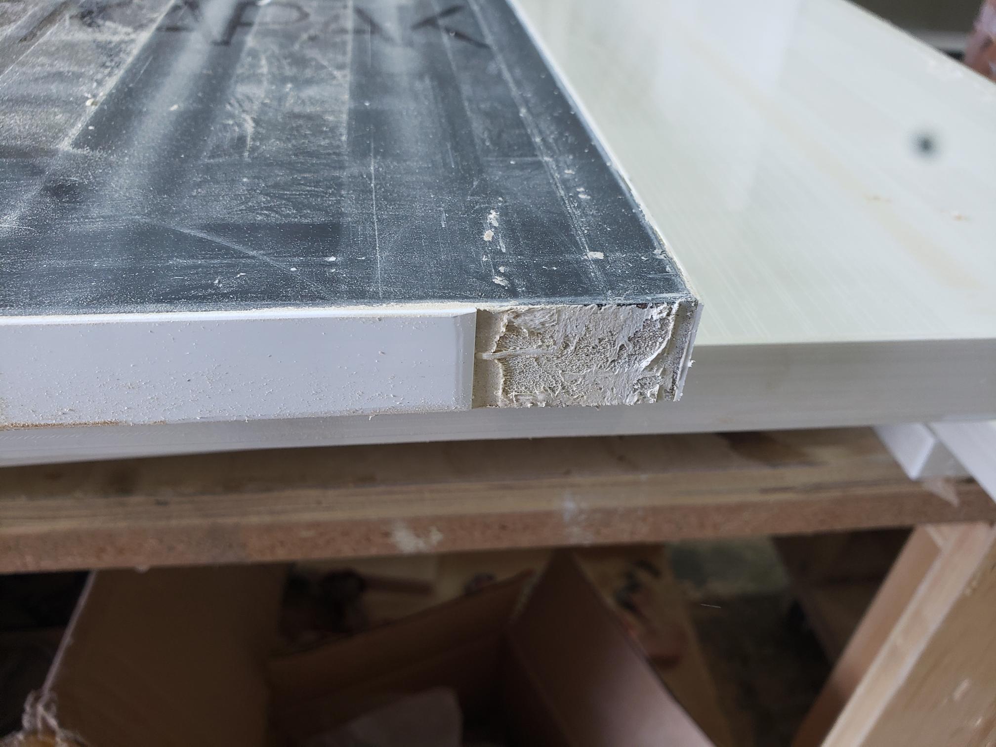

Hi,
I am currently experiencing issues with my edge taping. Every time I push a piece through, the beginning of the tape does not start at the beginning, but rather similar to how it is in the picture. I cleaned everything out and that did not help. I do not see anything under settings to adjust this.
Does anyone have any recommendations on how to fix this? Please see the picture attached.
Thanks,
Bob

Bob,
I don't have a Biesse Akron, but I have experienced similar issues with my smaller bander. Our problem was caused by the infeed fence being out of alignment. This caused the panel not to apply enough pressure to the edgebanding so it would slip along the first inch or two before it caught and started being applied.
My first call would be to Biesse though. Whenever I have any issues with my CNC or widebelt, their techs are almost always able to troubleshoot and diagnose the issue over the phone.
