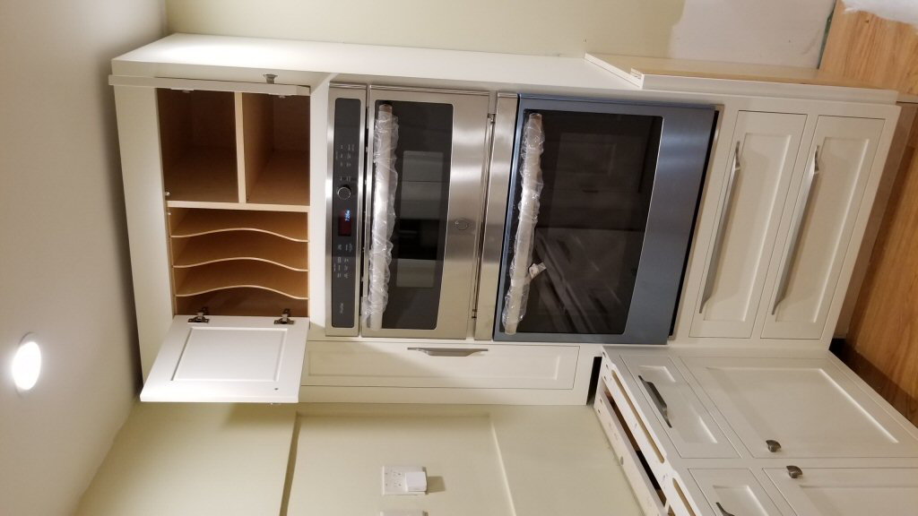

I did this recently for a job. See the pic.
The partition is 12 mm baltic birch. The build is via eCabinets CNC, the joints all lock-tenoned with zipR screws at the tenon gaps, except that there was no need to screw into the partition, which tenoned into the back, the deck, and the 4.5 inch stretcher under the drawer opening.
I know there are wire fixtures that will handle the tray divider job, but I like the look of the wood.
If you do this in wood, do you go 1/2" as I did, or thinner, or thicker.

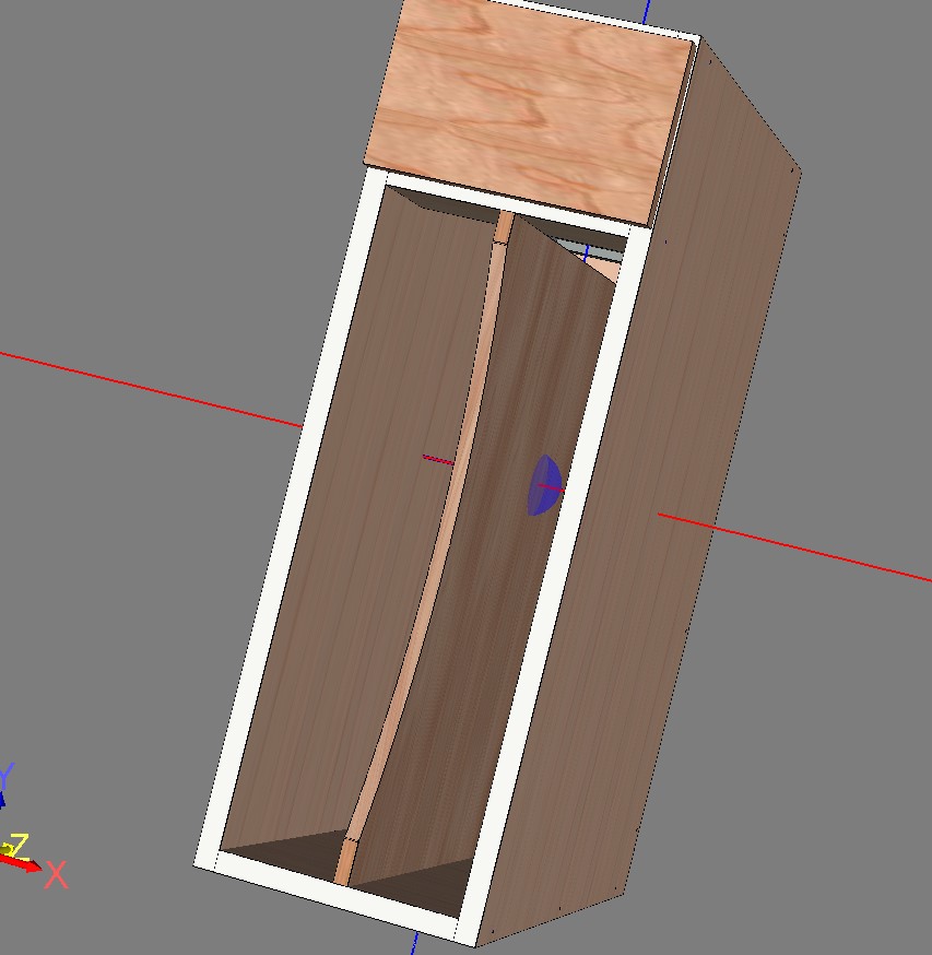

Here is the pic.
View higher quality, full size image (853 X 874)
9/20/22       #3: Frameless base with tray compartmen ...
Thomas Gardiner
Consider not bringing the spacer all the way to the front. It will make it easier to fish a shallow tray out that might be pushed to the back.
The trick would be how to resolve the top support on the stretcher
9/20/22       #4: Frameless base with tray compartmen ...
I do mine with dadoes and 1/4" veneered MDF. You can pull them out to make a bigger space or clean.
