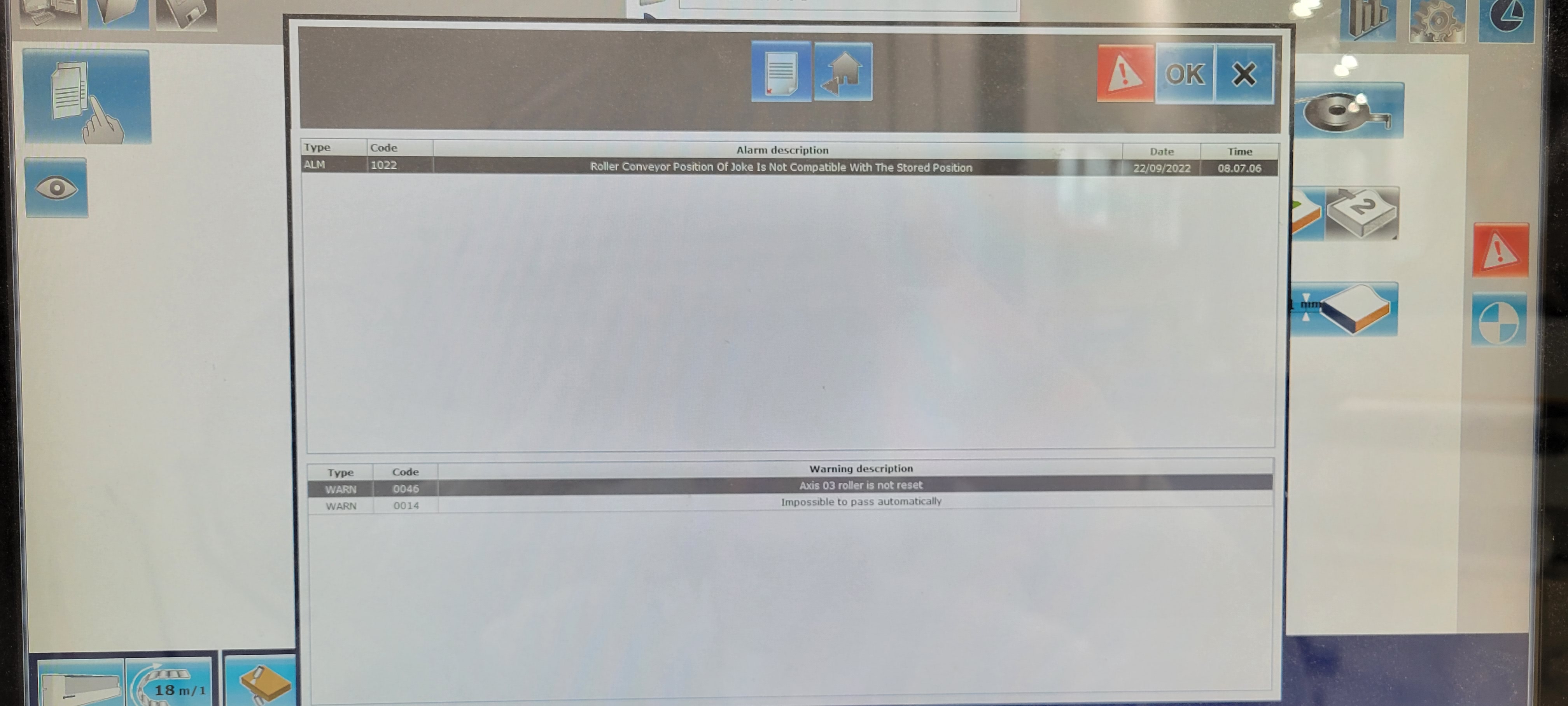

9/22/22       #12: Troubleshooting SCM Edgebander ...
Bernard
Website: http://mastermillworks.com
I have an scm stefani md edgebander and it is throwing a code 1022 roller conveyor position of joke is not compatible with the stored position!! What's wrong?
9/22/22       #13: Troubleshooting SCM Edgebander ...
Bernard
View higher quality, full size image (4032 X 1816)
