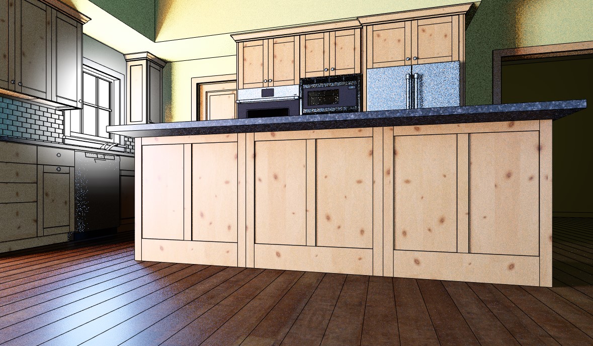

The view shown here is the concept for a build that will go in about three months. New construction.
The rear face of the island is paneled over a wood-framed ponywall built behind the cabinets on the other side. So, the panels (I made them three rather than one big) fasten to the framing.
I do my base cabinets always with a 3/8 top margin and these panels will have that same reveal at top.
What kind of magic would you do to make the center panel readily removable? We want it that way so as to access the mechanicals of the downdraft hood behind the cooktop.

Can you use push latches? they are invisible but just push the panel in and it pops off

Hafele Keku fittings

Star hanger zeros. see starhanger.com

Hafele, Keku clips.

What about some large diameter rare earth magnets on the four corners?
