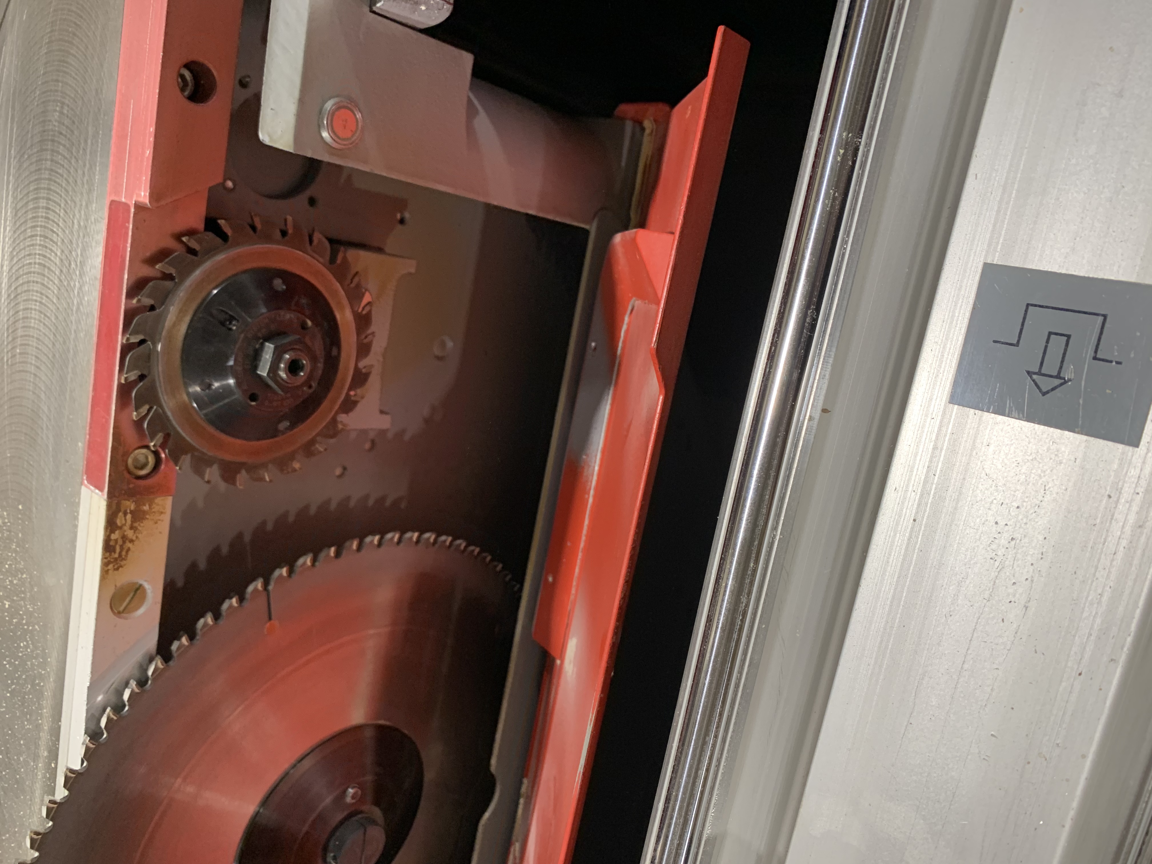

Hi everyone,

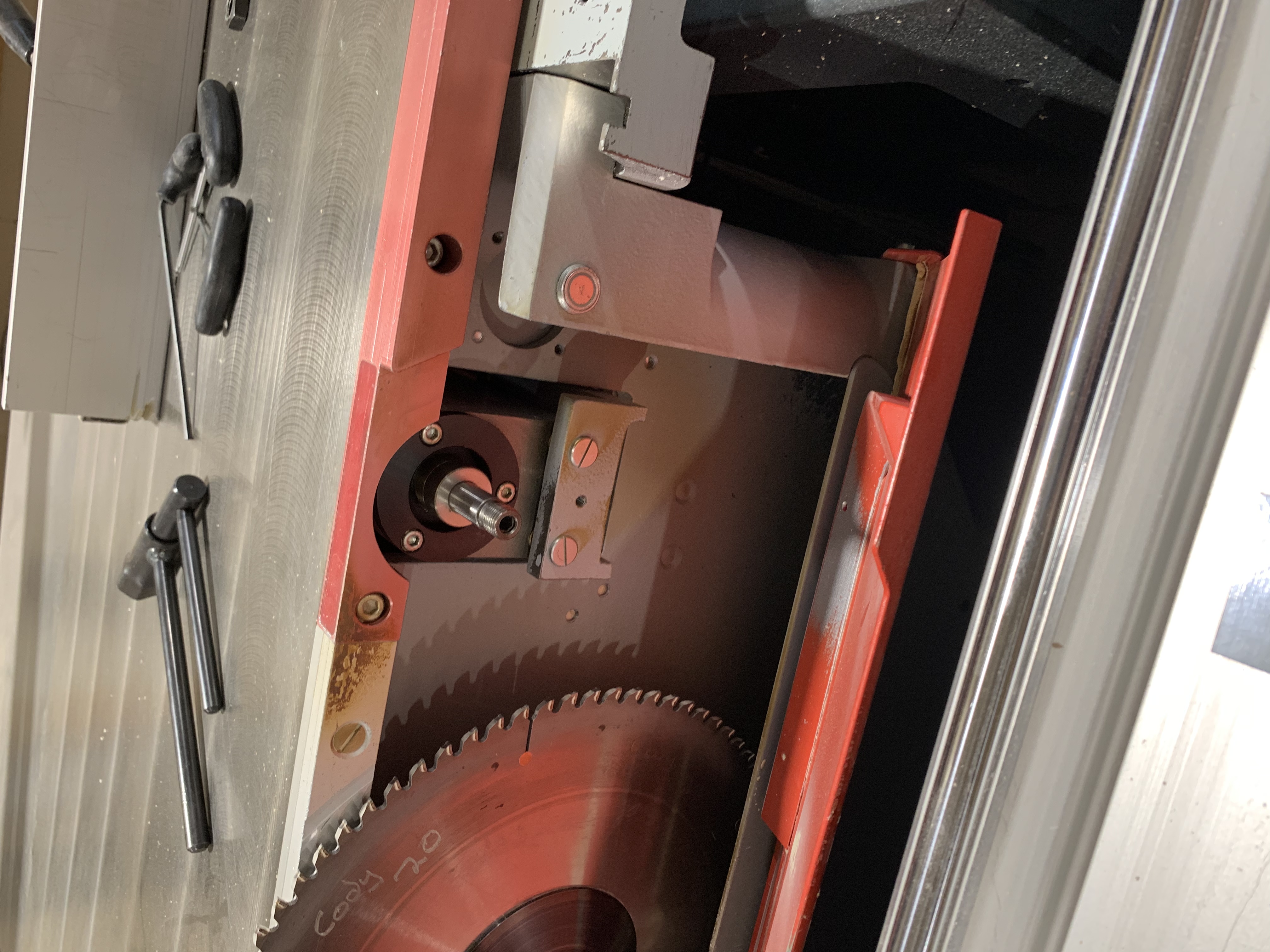

Our shops Altendorf F45 scoring blade doesn’t retract once it’s turned off. The blade stays out even after lowering it all the way down, although it’s supposed to retract all the way once the machine it’s turned off.
I appreciate any advice about how to solve this issue

possibly wrong size scoring blade?

If its cable driven, the cable may have stripped out of the eccentric wheel that lowers it, if its electronic, they have a control card that sometimes fails
