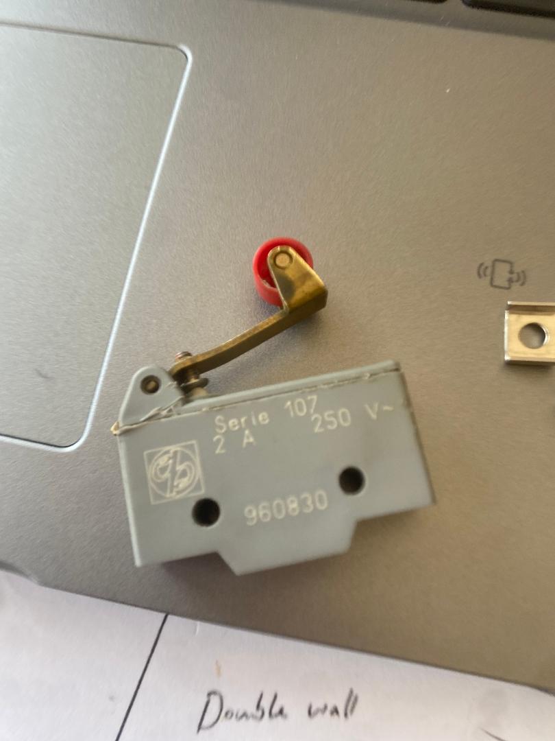

hoping someone can help me out with a faulty microswitch for my brandt kd84-c from 1997. the switch tells the machine to advance the coiled tape for the next workpiece. it is a hartmann 107-2270 (2a 250v). I know this is a shot in the dark but the replacement part from the big guys is $1400.00.

Try McMaster Carr and search for a snap acting switch. You're after a roller lever actuator style.

The two things you need to search is if your switch is normally open or normally closed. And then getting the correct voltage.

Another good option is Automation Direct (Online). They have good tech support that may be able to help you over the phone, with some Emailed pictures.

Can you open it. Had one n a bander that was similar and it had filled with dust and didn’t allow it to move properly inside. Opened up and cleaned out and it worked fine.

check with Mouser Electronics, Homag charges whatever they want.
