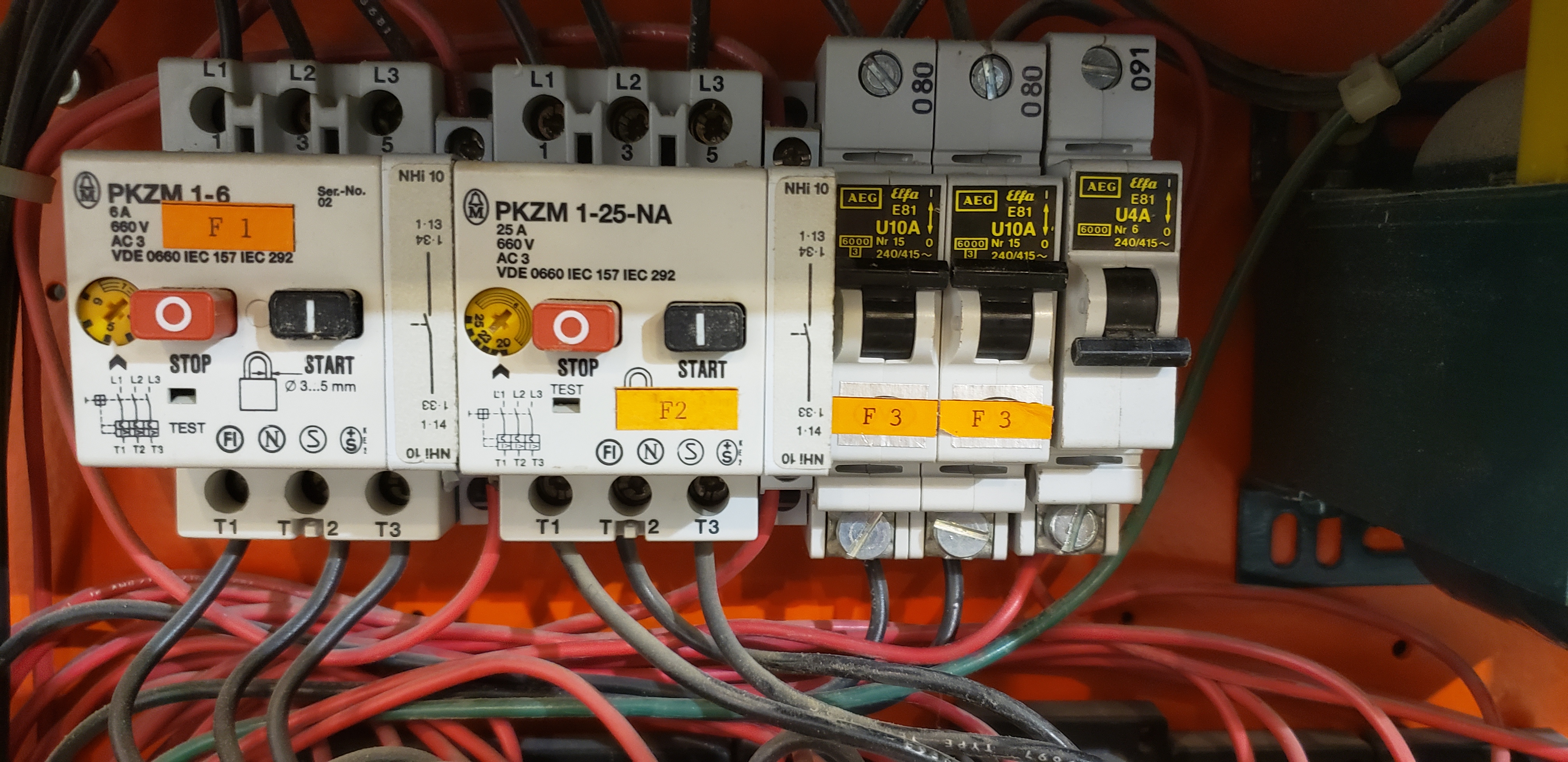

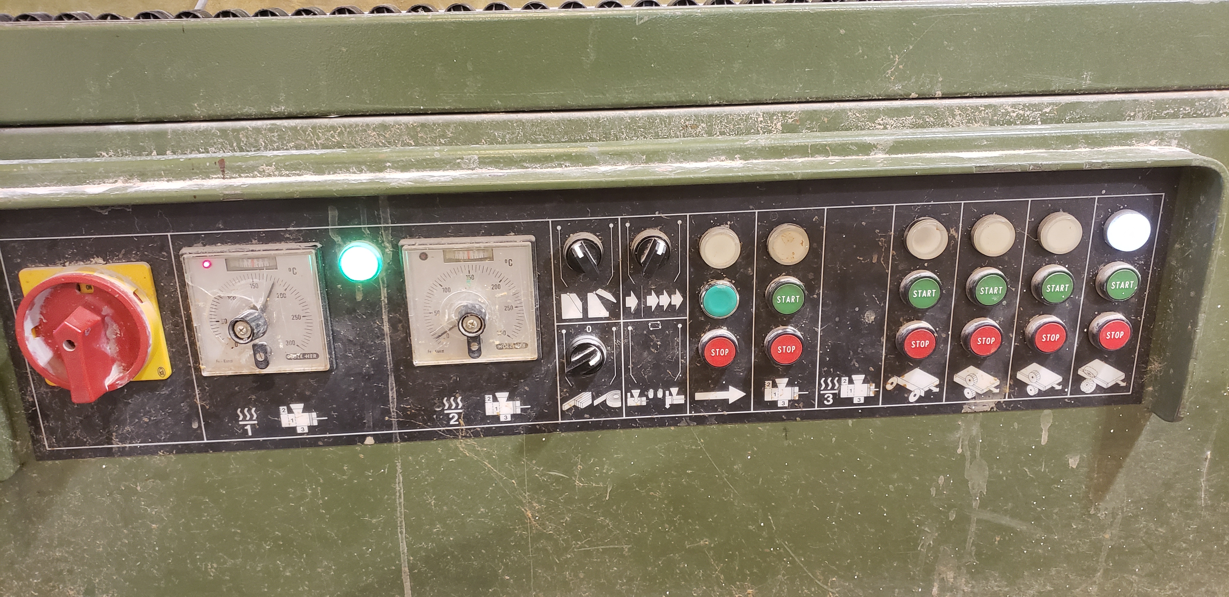

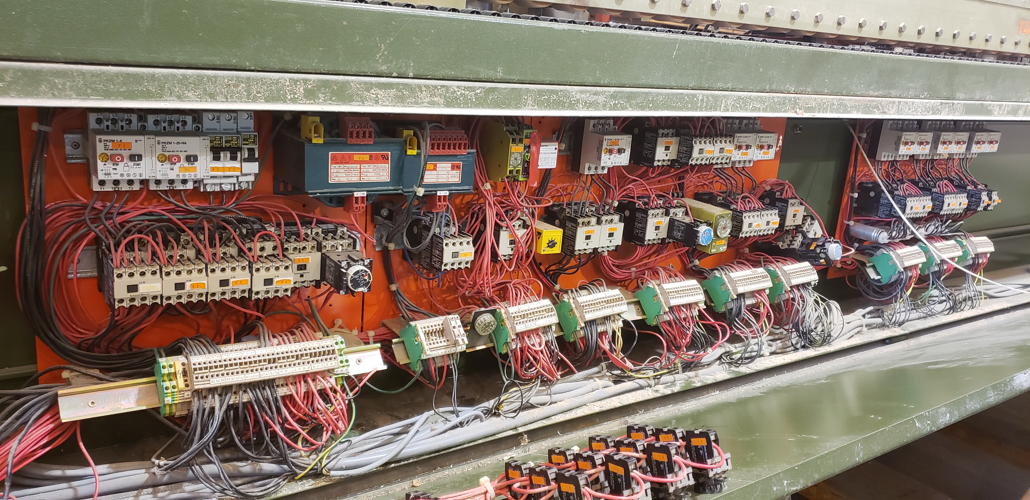

We own a well used Holzher 1437 edgebander that has work perfectly until recently. There are 6 different stations on this machine and each time the glue station button is pressed on, the internal breaker 091 immediately trips, shutting down the complete machine. I've tried disconnecting all leads coming from each station at the main panel area but the breaker still trips.
Any clue where I should look next.

Take a look for a ground short to bander chassis. It was operating then suddenly started tripping the breaker.
Use a good flashlight and look around well before tearing all kinds of things apart.
A lot of great engineering went into that bander and over time things vibrate loose.

the breaker you are tripping is the F5 which protects the 110 ac control voltage that runs throughout the machine.
since it trips when you start the glue station then i suspect it is a shorted out coil on one of the 1906 K1, K2 or K3 relays. (it is usually the K2 because it works the hardest)
the easiest way to determine which one is to remove, AND IINSULATE while you are working on it, the wire in the A1 terminal, one at a time, on each of the above relays and then turn on the glue station. when you find the one that doesn't trip the overload then you've found your culprit.
