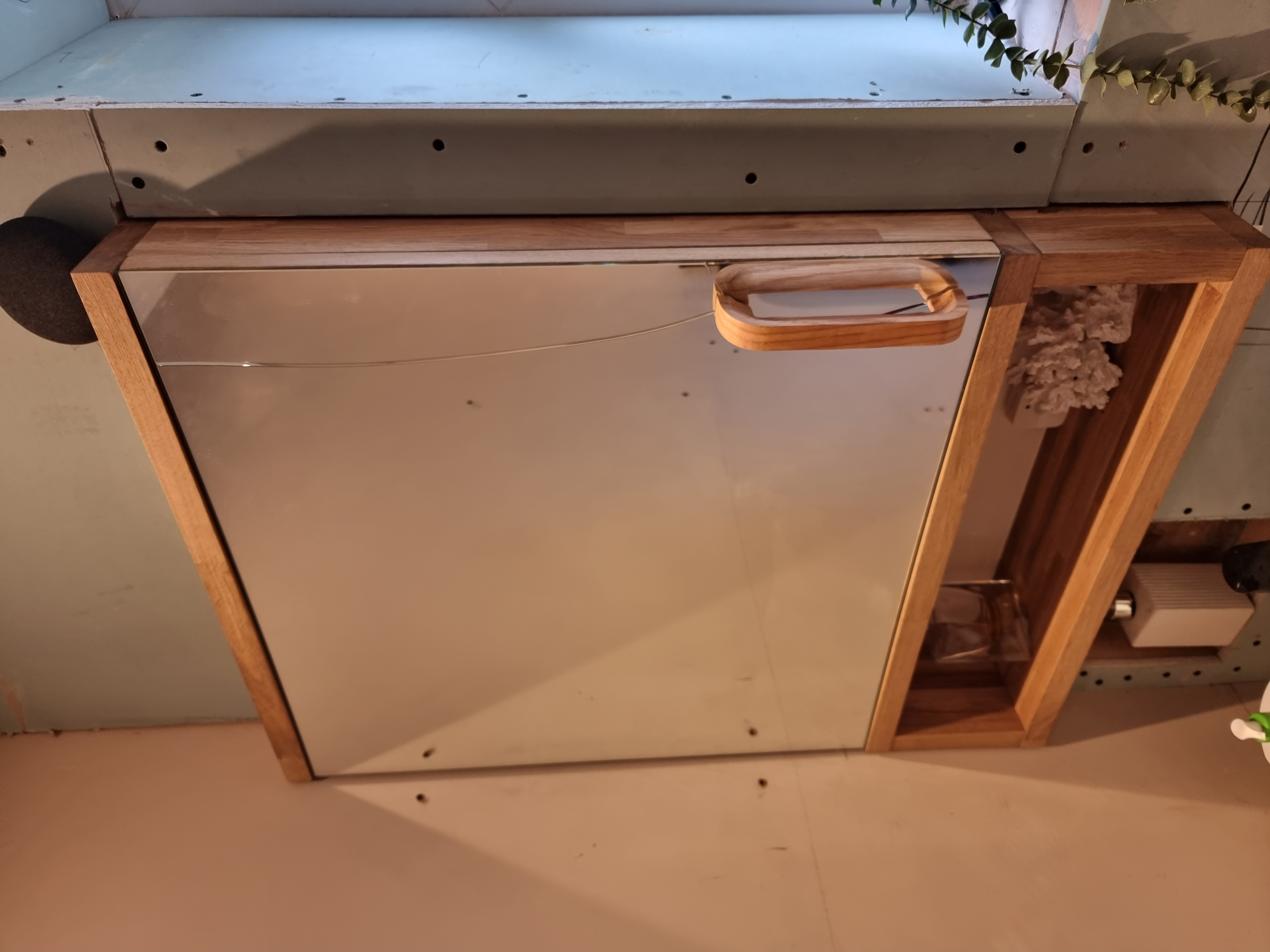

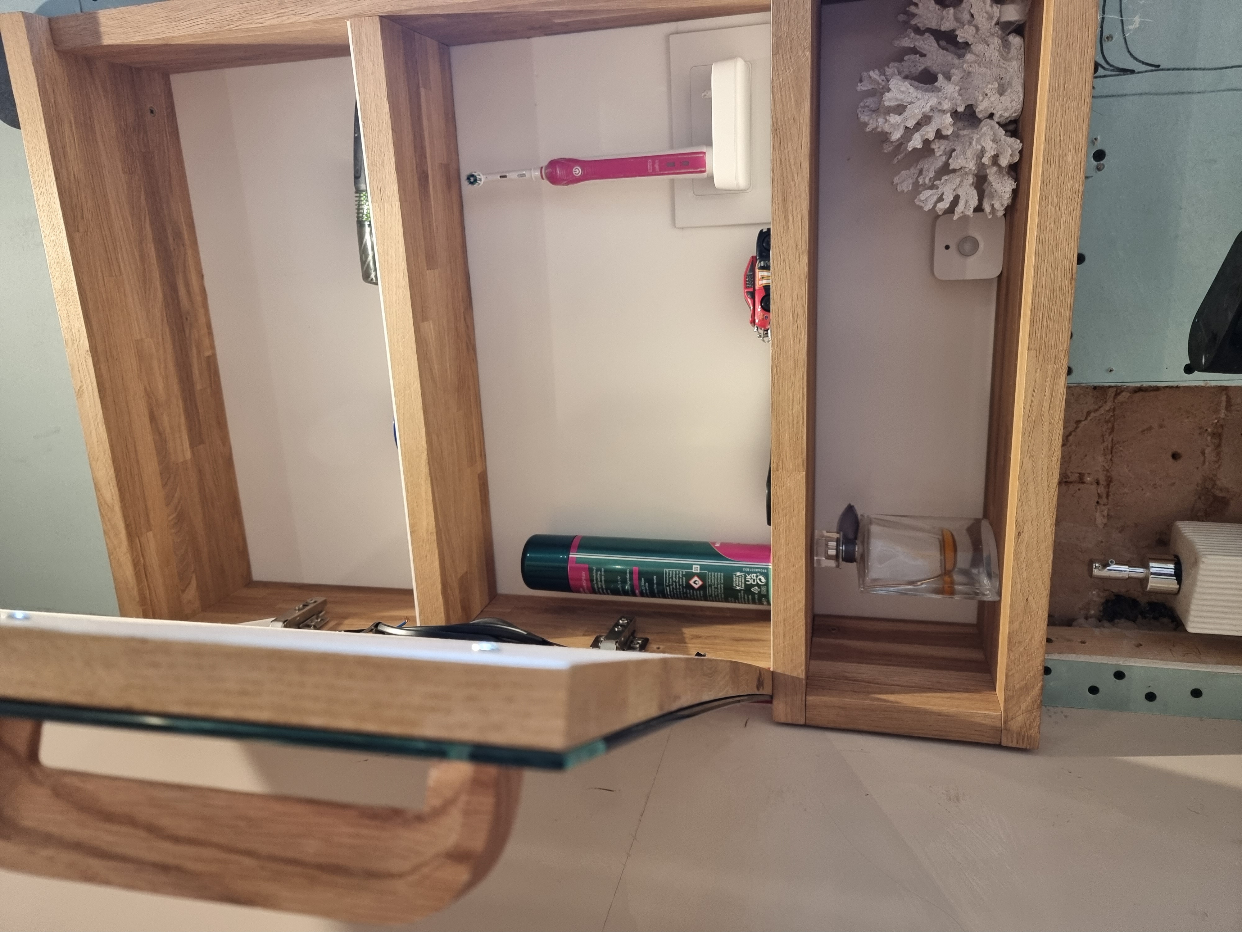

Hi. I'm not a pro, but love making things out of wood. Rcenetly renovated a bathroom and made a custom cabinet from some oak block worktop (26mm). I bought some thinner oak block furniture panel for the door. Oiled the inside, and edges with 2 coats of osmo pilyx. The other side I have attached a demister par and then on top of this a 4mm mirror, using mirror adhesive. I haven't even tried the demister doad yet, but the door has sttds to bow significantly.
I'm sure I've done some rookie mistake here and will have to re-do the door. Can anybody advise me what I've done wrong, and how to prevent this with the next version please?

Good morning, I will jump in here before the forum police scold you for not being a "professional". Your issue is moisture based. You have a solid wood door panel that you then applied different materials to the front & back of. Your door panel is constantly trying to find its equilibrium and will absorb & release moisture based on time of year, site conditions, relative humidity etc. Adding some type of oil or sealer can help, but in the end this process can't be stopped 100% as much as we try. The materials you have attached to your panels are not allowing the wood panel to absorb/release moisture evenly and at the same rate thus causing the panel to warp.
IMO a solid wood panel is not the correct material or construction style for this type of application.

Thank you for your response, and apologies if I have misused this forum. I am planning to re-make the door with oak veneer plywood. Would this be suitable?
Many thanks
11/17/22       #4: Oiled/sealed oak mirror door bowing ...
Bruce H
No, plywood will not work. you are applying a mirror to only one side, it will warp. make a frame door cut for glass.
11/23/22       #5: Oiled/sealed oak mirror door bowing ...
Yes, plywood will work. But, use conventional picture framing techniques to float the mirror. Finish all wood similarly.
