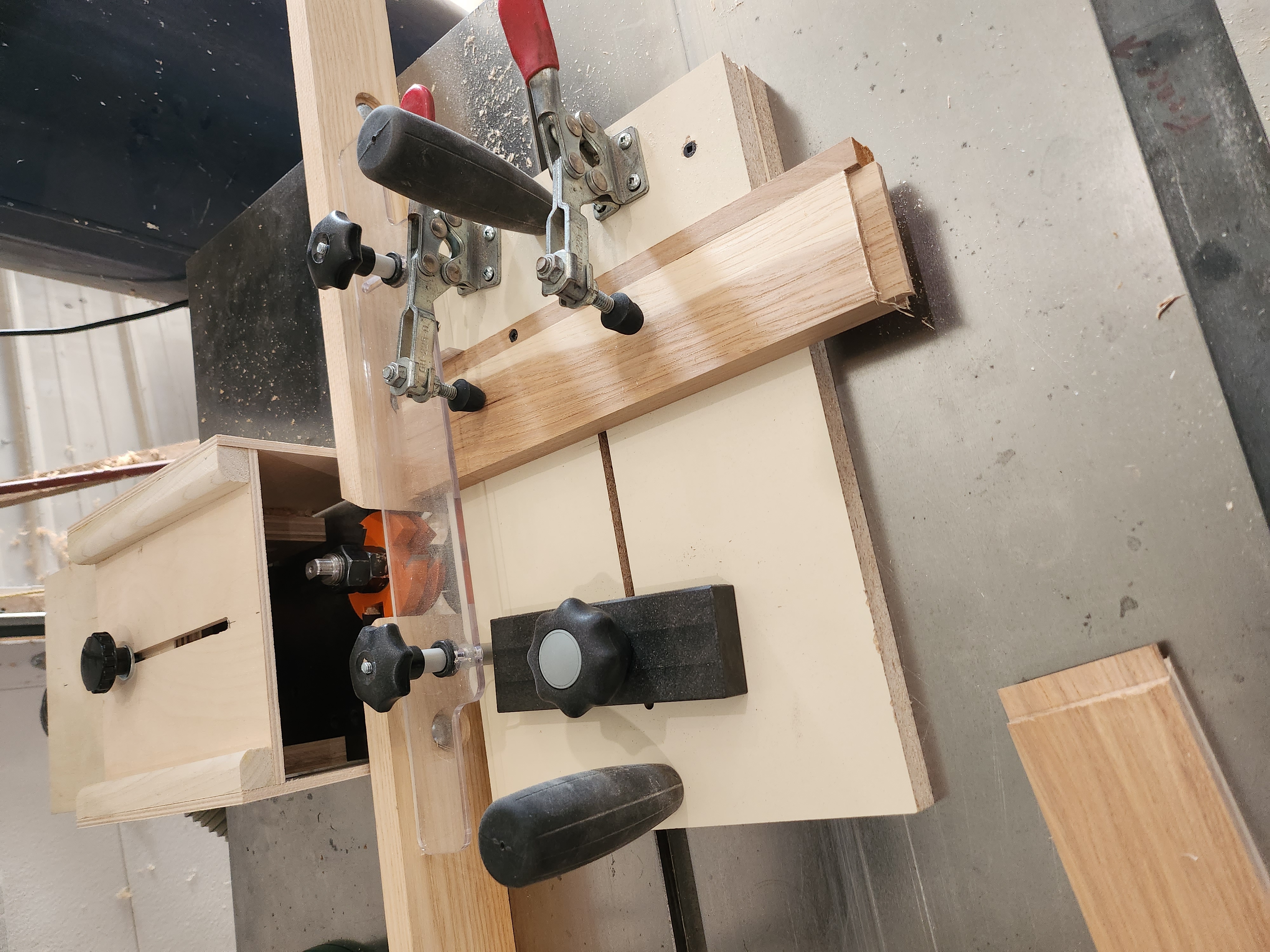

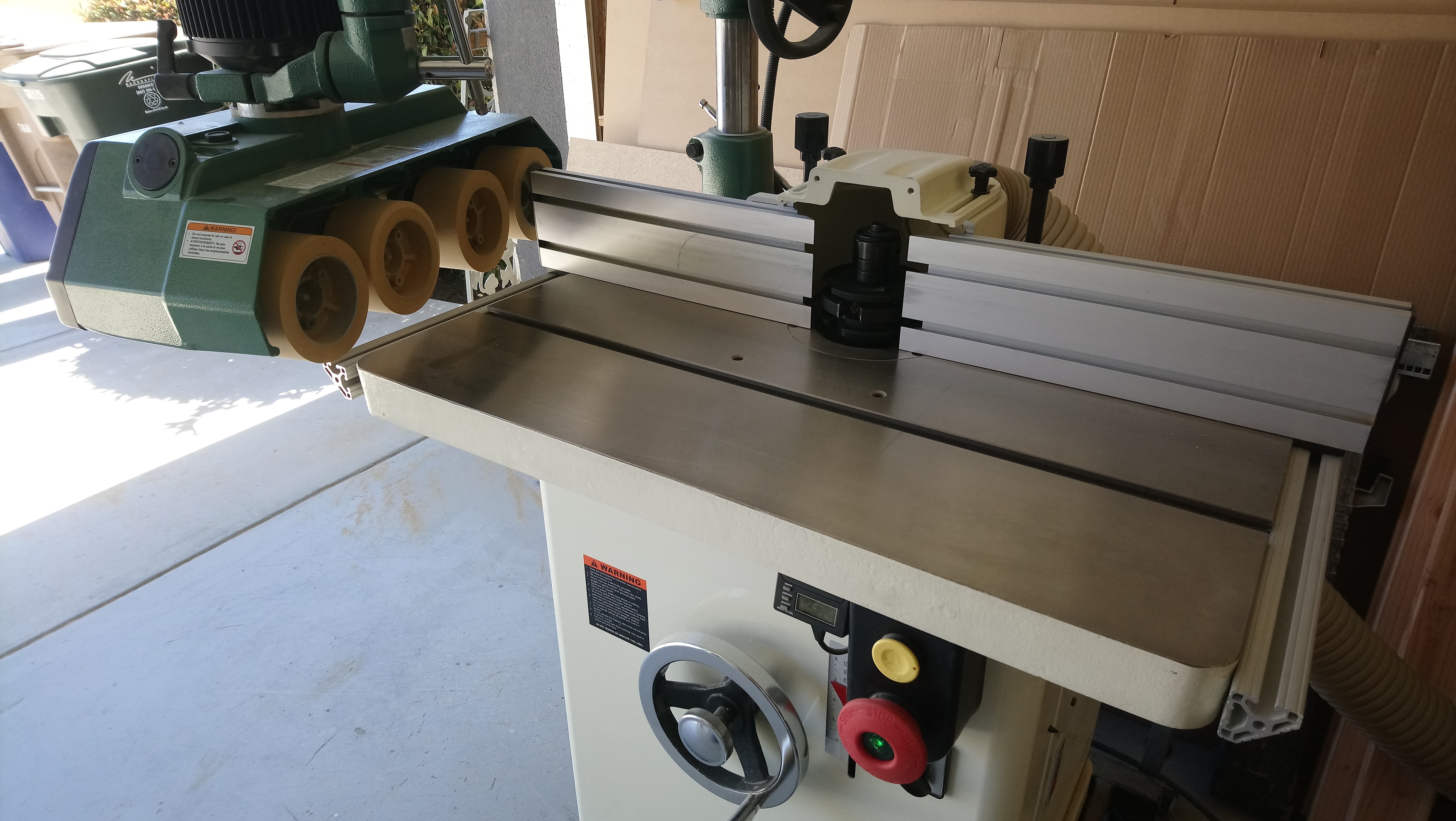

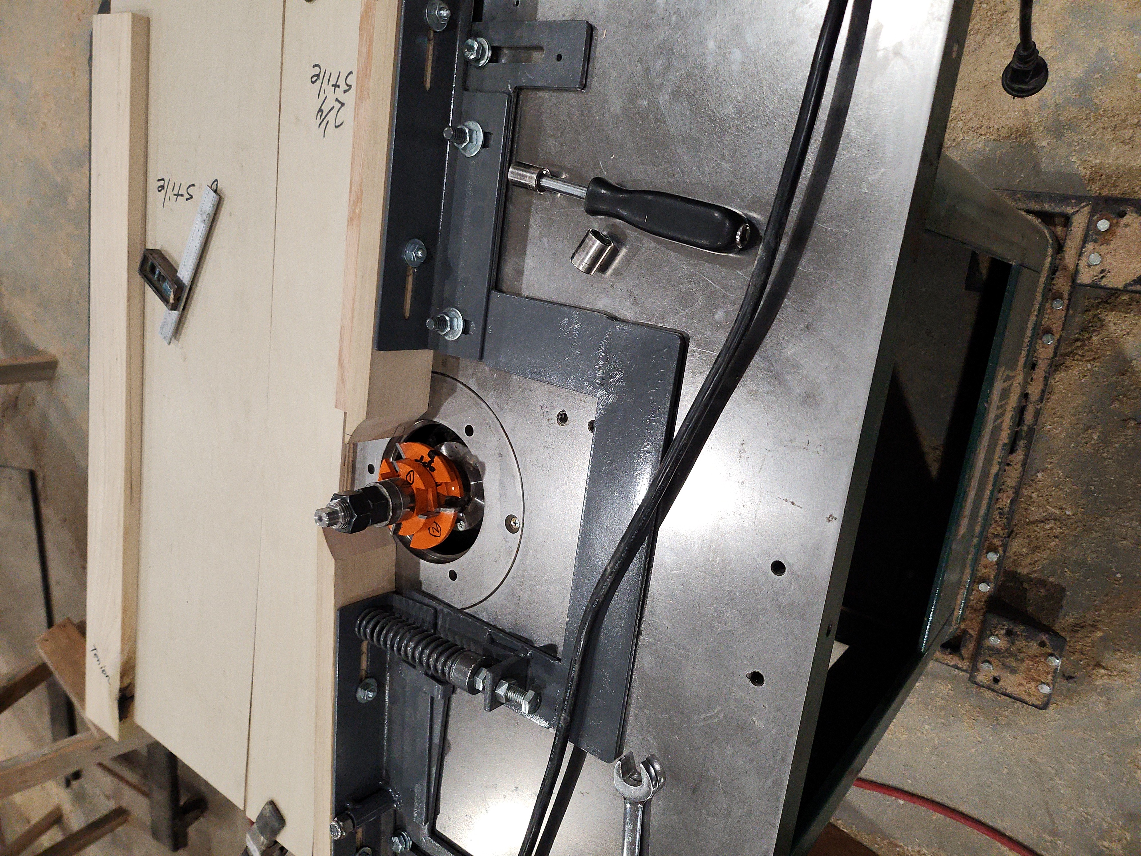

Getting tired of resetting fences to make doors. I made fences that lock into place with roll pins then a few bolts to hold it. Seams to work great. I am wanting to add DRO to my grizzly 1026 shaper. Hoping to record heights for cutters, so resetting is quick and accurate. Any thoughts on brands?

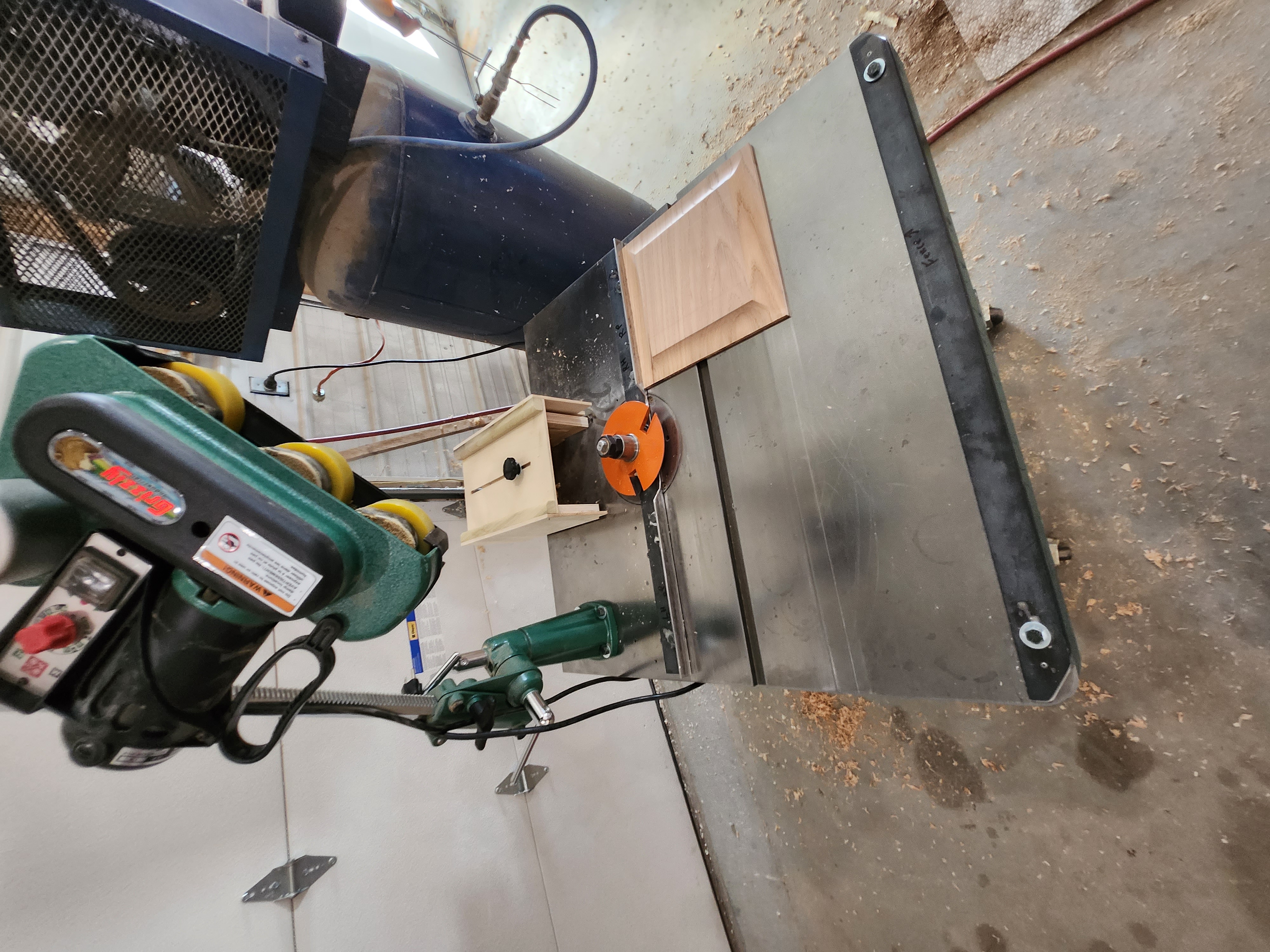

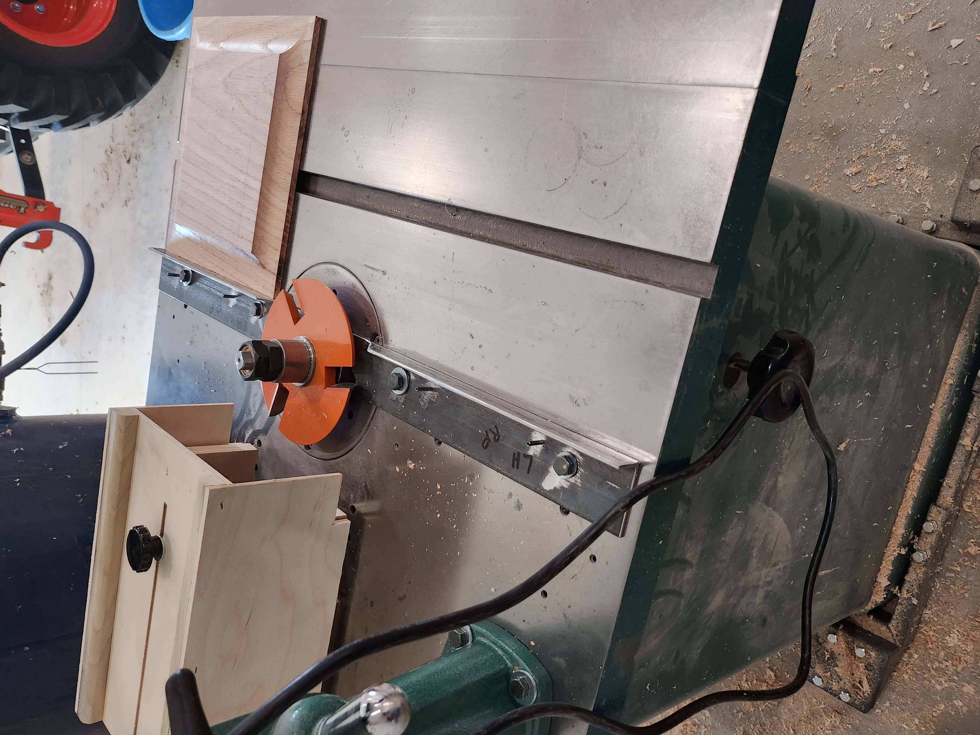

Cheap but works for me. Just make a robust DRO install inside the cabinet.
