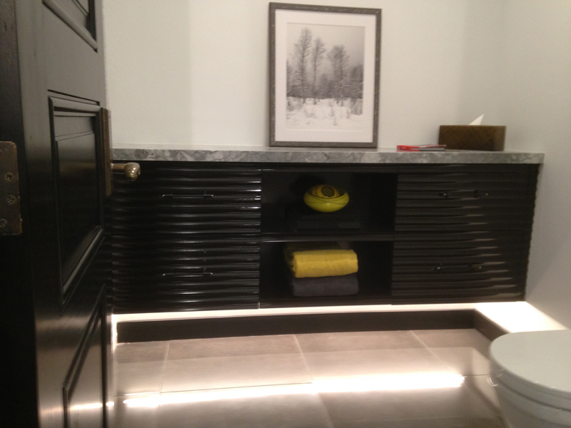

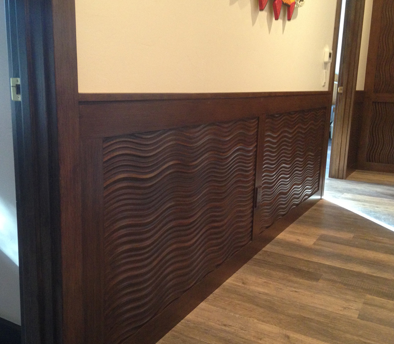

I've done several projects with fluted doors and drawer fronts, as well as some wainscoat panels. I milled the panels on my cnc, using a V Carve Pro fluting toolpath and a 2" diameter ballnose bit.
I used to do these by hand on a large router table I built, but the cnc is much easier and more precise.
I've done some in solid wood, but mostly in mdf. Typically, I would mill a whole sheet, and then cut the pieces to size on a slider.
View higher quality, full size image (800 X 699)

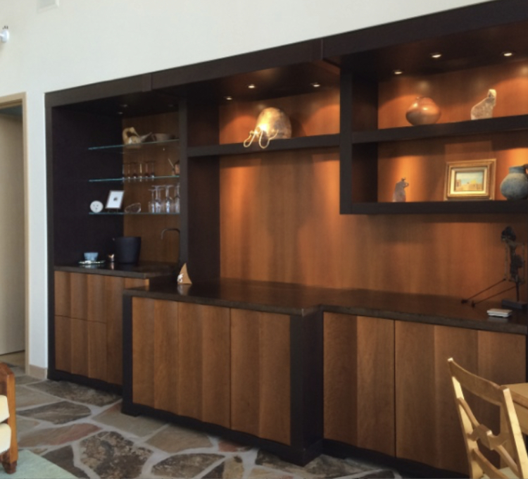

I did this one out of solid cherry. Had knifes made and ran the boards through a woodmaster molder. Turned out good and no issues in 10 years. I thought the doors would cup, but they have stayed true enough.

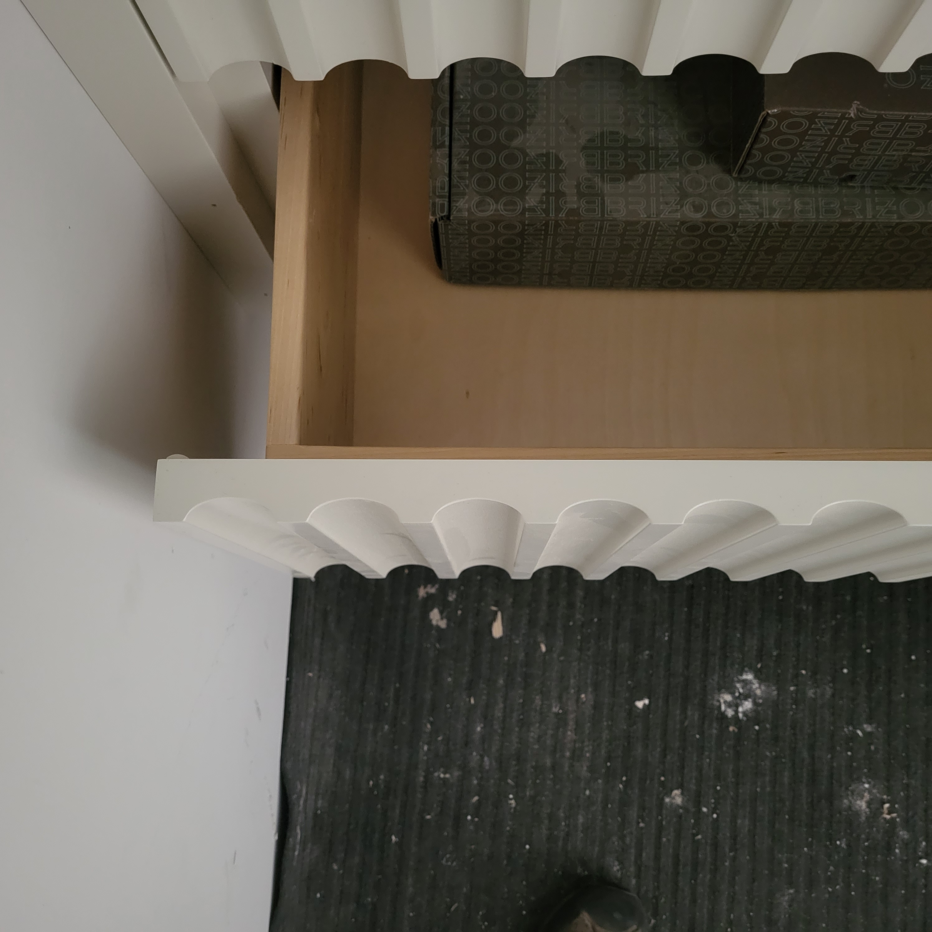

I used a 3/8" bullnose and the profile tool in aspire.
Probably a smarter way to do it. It was a long program to run for these two small fronts out of mdf.

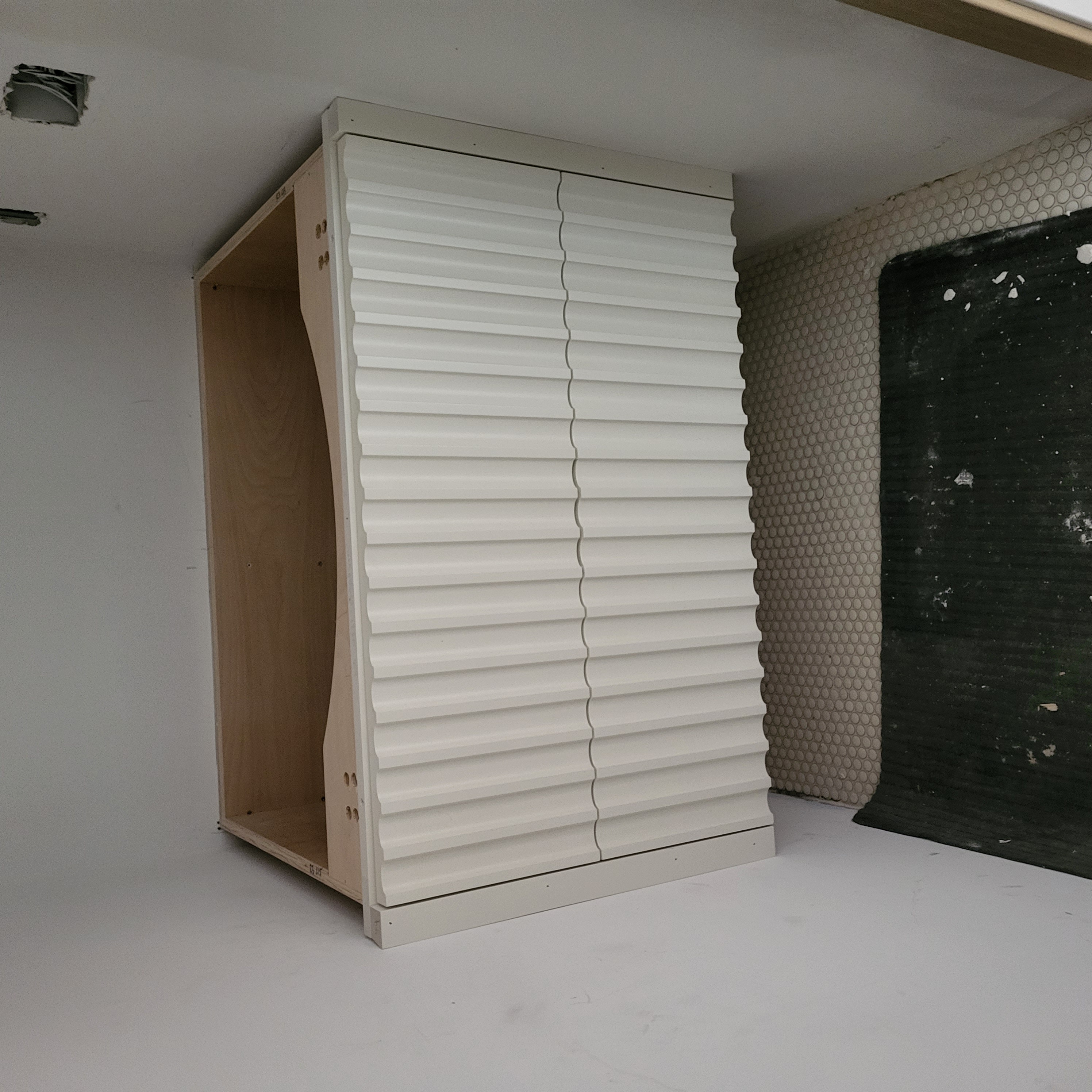

Also just did a set of these on kitchen uppers. Must be a new trend.
We did it from MDF on lift up doors (aventos). Went ahead and embedded some aluminum flat pieces(?) into the back because the MDF wants to cup so bad when you do this.

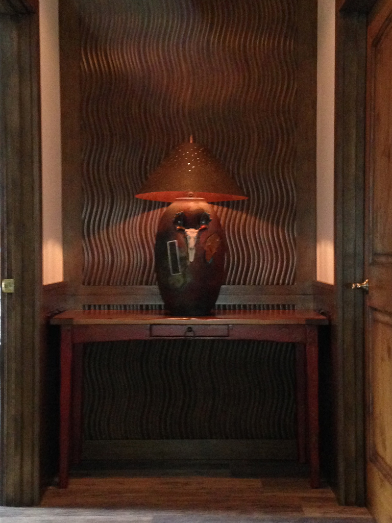

I have several of the Yonico bits Mark B mentioned and they work well for this type of milling. It takes about 10 minutes to mill a full sheet with straight flutes, 12 minutes to do the wave pattern.
View higher quality, full size image (800 X 1067)

Duster,
That horizontal wave wainscotting, last photo in your first response, is pretty smokin. Did you run the wave and then mill a rebate on the panels? I zoomed in and the rail/stile interface looks super clean. Really cool. The transition to vertical at the end of the run is super cool too.
1/21/23       #18: Scalloped cabinet faces?? ...
duster
Mark B - I appreciate your comments regarding the wall panels. It was a fun project that I did for my own house a couple years ago. It took some trial and error to get the look I was going for.
To produce the panels, I milled full sheets of mdf and cut to the sizes needed on my slider. The stile and rails were milled on 2 shapers with a square edge shaker detail, just like a cabinet door. I ran the milled panels through a 3rd shaper to produce the tongue.
Finishing was a bit of a process, with hand sanding, paint, vinyl sealer, 2 different glazes, and lacquer. I showed the finished product to some clients, and actually got some orders for more.

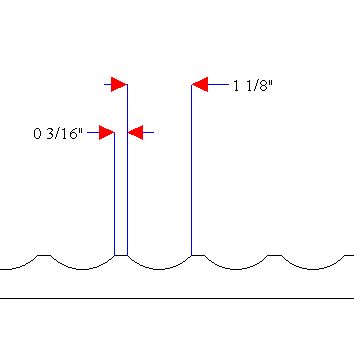

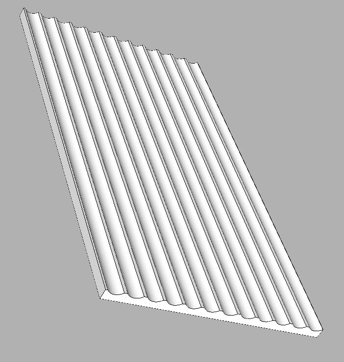

Modeled in eCabinet Systems Software. (my calculations were a bit off for the width but you get the idea) Would cut it with 1 1/2 round nose bit.
View higher quality, full size image (702 X 740)
2/8/23       #20: Scalloped cabinet faces?? ...
Jonathan Mahnken
Thanks Kerry. Approximately what size are those scallops
2/8/23       #21: Scalloped cabinet faces?? ...
Kerry Fullington
1 1/8" Wide. I set them 1/4" Deep.
2/8/23       #22: Scalloped cabinet faces?? ...
Kerry Fullington
Jonathan,
These came out that size because I wanted to cut them in a single pass. I think you could draw your scallops any width and depth you want and model them using the 1 1/2" tool without too many passes.
