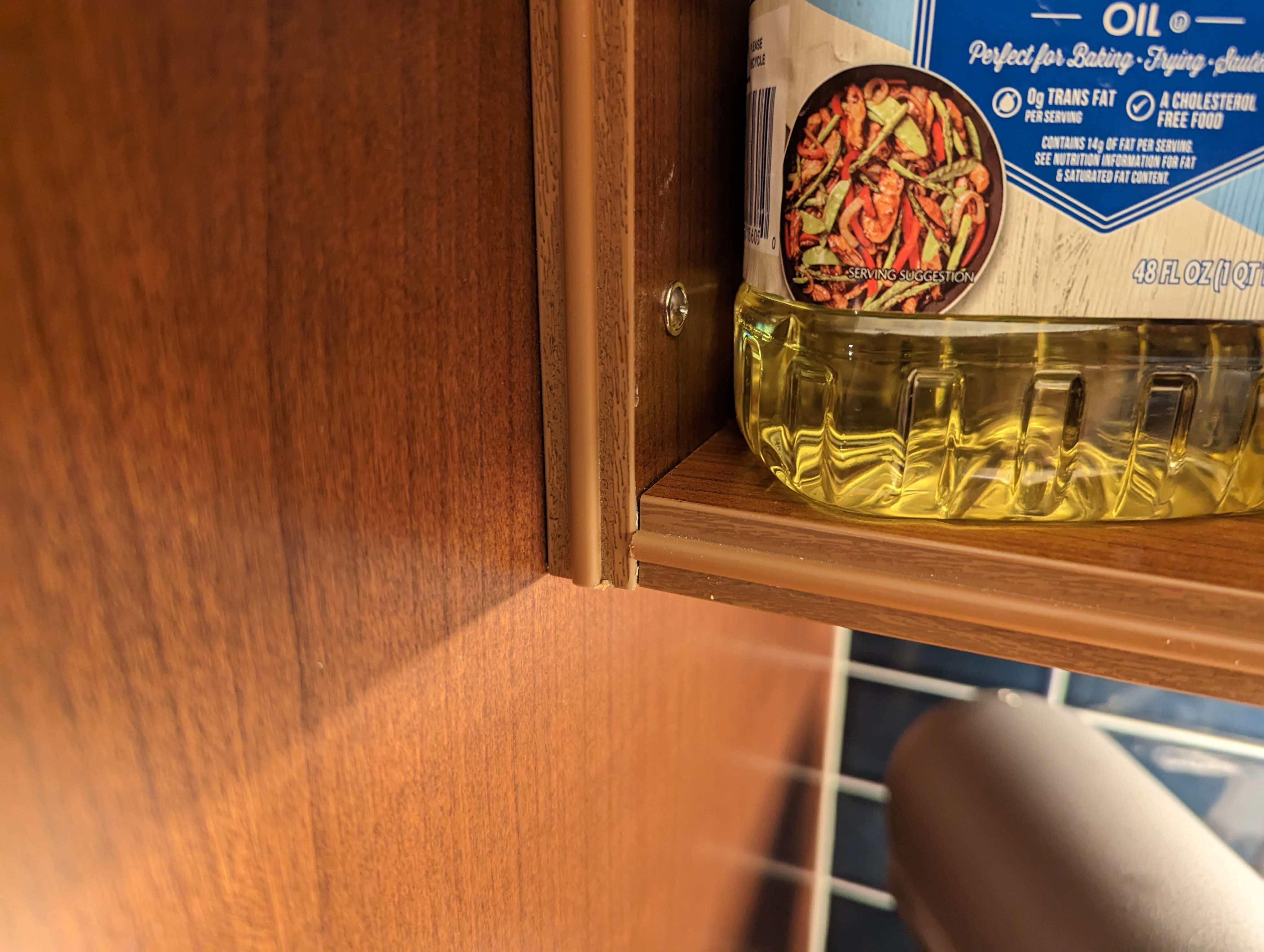

Is anyone familiar with this type of continuous door bumper on frameless cabinets?
I have a customer that would like to repaint the cabinets and interiors white, so the tan bumper is not good. It appears to be a type of edgebanding. Is it glued on and could it be removed with heat and new white banding applied? I can't imagine that paint would have any chance of holding up on the soft material.
Thanks for any insight!

My guess would be it's a T molding.

That's funny, I just threw a roll of it out. Have no idea where I got it but never used it so... In the trash. It was white but yellowed color because of age.

try outwater
might be called a dust shield

They also make clear bumpers, just like the tan ones. Richelieu, Hafele, etc, should carry them.
