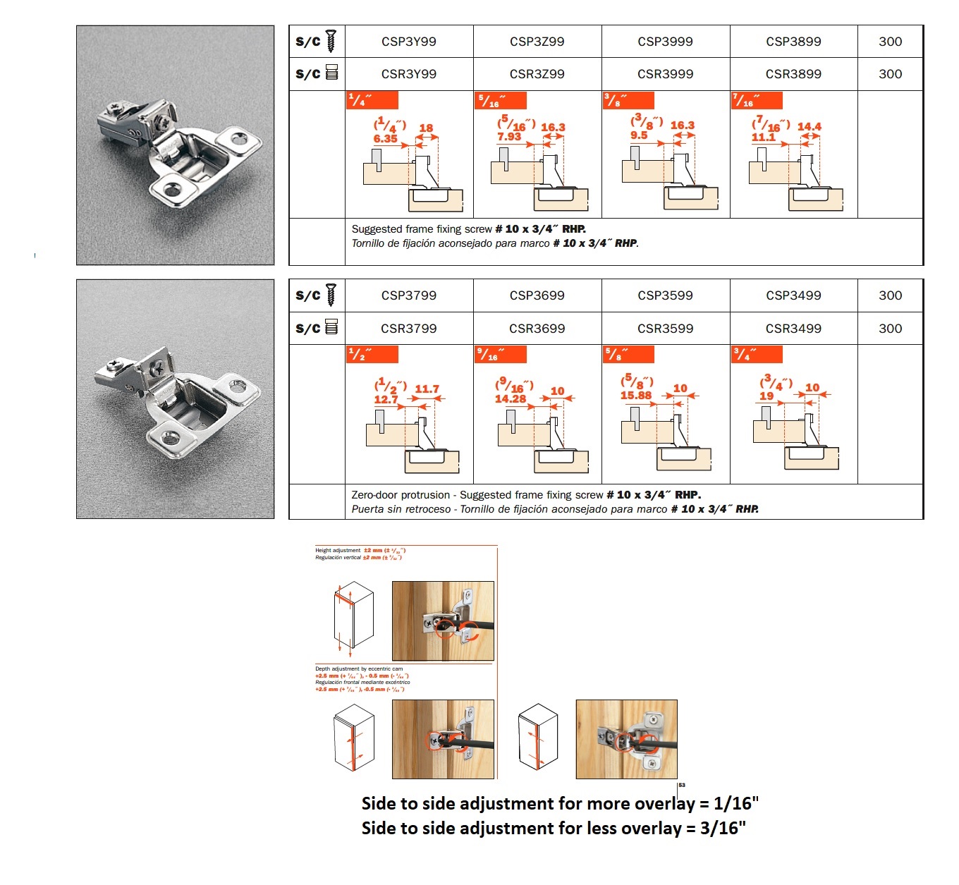

I built new rail and stile doors to replace some existing cabinet doors. I was shooting for a 1/2 overlay and came out slightly wider on all my doors. Before I drill the doors for concealed hinges, I'm trying to determine if the 1/2 overlay hinges will work with the little side to side adjustment they allow, or if I need to cut my doors down or look for new hinges. Any thoughts or advice are appreciated.

Hello Luke,
You can easily make up the difference with the adjustments with Salice face frame hinges.
If you use a 1/2" overlay hinge you can easily adjust up to a 9/16" overlay. and down to a 3/8" overlay position.
If you start with a 7/16" overlay hinge, you can adjust up to 1/2" overlay or down to a 1/4" overlay.
Keep in mind, you will need to maintain a 3/8" gap between 2 doors (3/4" square edge) to prevent the doors from hitting.
Attached are some additional details.
Best of Luck,
Dennis Bean
Salice America

3/24/23       #6: In between overlay measurements ...
Luke
Dennis,
Thank you for the link and information! Very helpful!
3/24/23       #7: In between overlay measurements ...
You're welcome. The same holds true for the Salice soft close face frame hinges.
3/24/23       #8: In between overlay measurements ...
One more thing. You can also use a 9/16" overlay hinge. This will adjust up to 5/8" overlay and down to 3/8" overlay.
Thanks.
Dennis

Luke
Thanks Nicko. It definitely looks like Salice has me covered with the adjustability in the hinge design and I agree that this is the better solution, especially across 30+ doors. Looks like the hinge cup is placed in the normal space, 1/8 away from the edge too.
