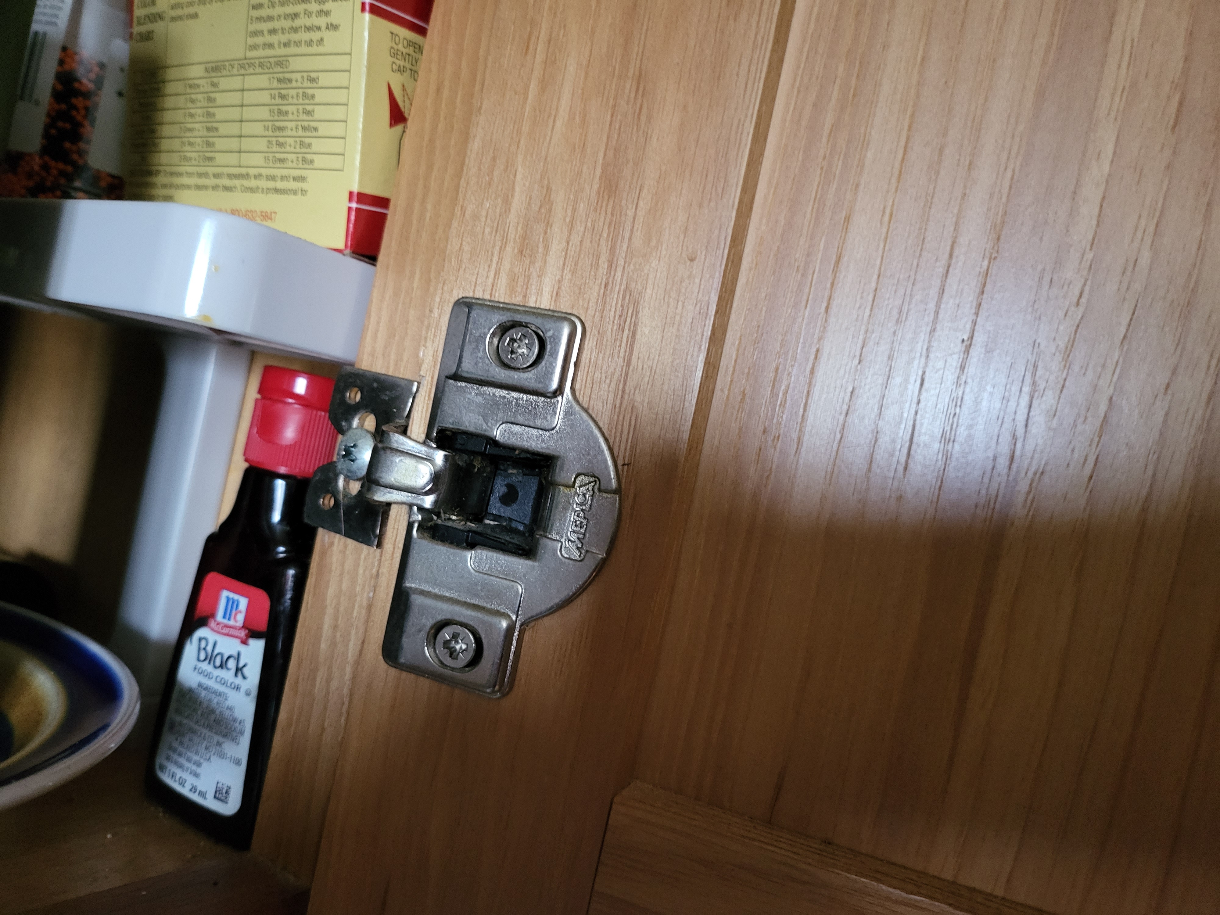

I need to replace a couple of face frame hinges in some near 20 year old cabinets. Half inch overlay. They do not use the same bore pattern as the Blum hinges that I use.. Can someone suggest a proper replacement hinge?

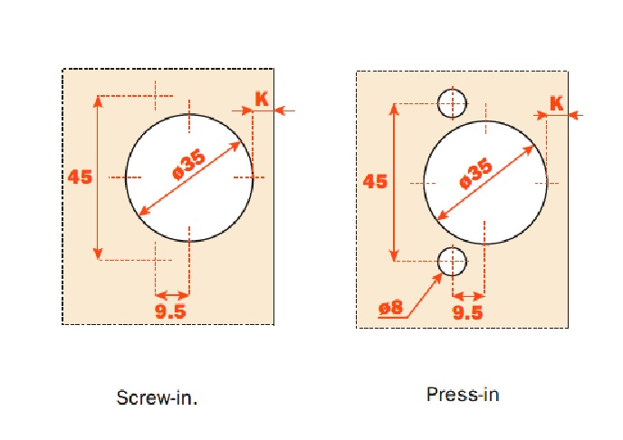

If your hinge is one of the "Big 4" manufacturers of Concealed hinges (Salice, Blum, Grass of Hettich) you will find their name in the hinge. If you post this detail, I am sure I can help you out. Also, a photo would help ID the hinge for you.
Today, almost all concealed hinges have the 45 X 9.5 pattern. Twenty years ago, that was not always the case.

Dennis thank you for your response. The old hinge, looks like Mepla is imprinted on it after cleaning, the cup measures with a digital caliper 34.7mm. I am surprised that my Blum hinge would not go into the hole. Screw holes measure 48mm OC. I would like to use a soft close replacement.. Eyeballing the hinge it looks like the center of the 2 screws are almost inline with the cup center.
