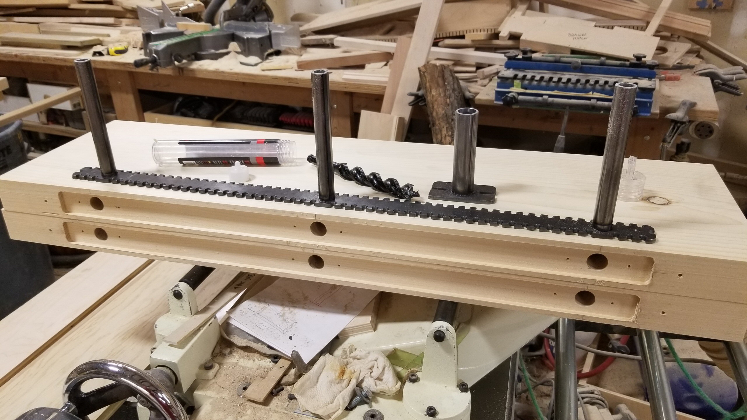

I have been looking at this type have you used them before?
3/25/23       #4: Floating shelves ...
I've used it a couple of times. You have to buy the drill bit to make it work. If you are just doing a few shelves you can use the guide they give you with each kit. But if you plan on making a lot of shelves by the drilling guide that is for the bracket you are using since it's already spaced out properly.

Thanks Leo that’s real helpful I will check into getting me one.

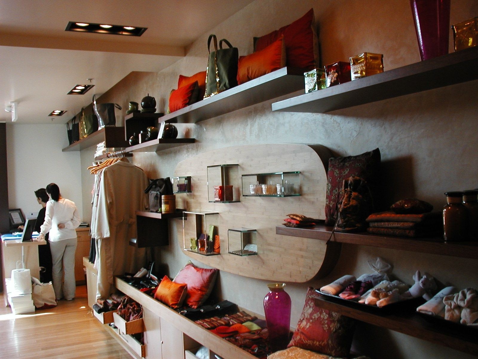

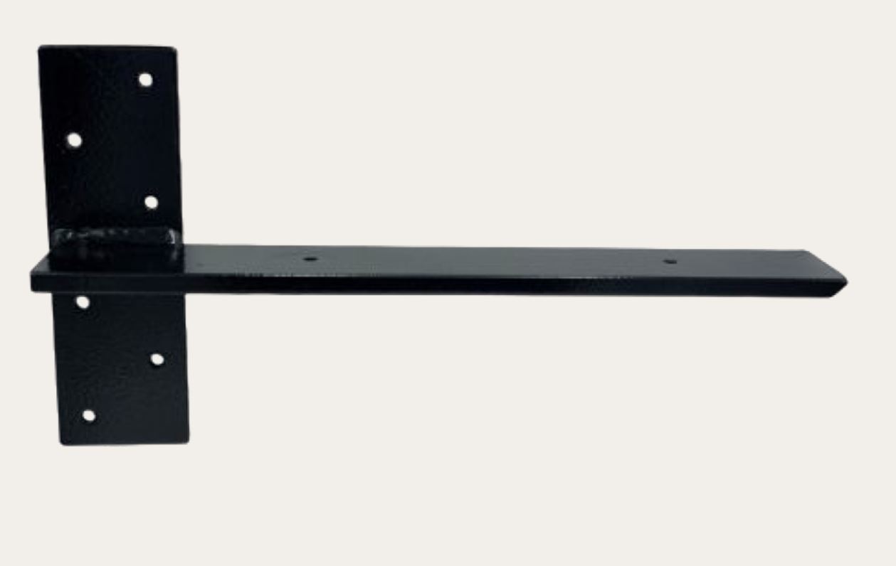

Light shelves can ve done with surface metal brackets or wood cleats. we do a lot where they are heavy (Stone) or in commercial applications where we use an angle inwall bracket preattached to studs before sheetrock or surface is applied

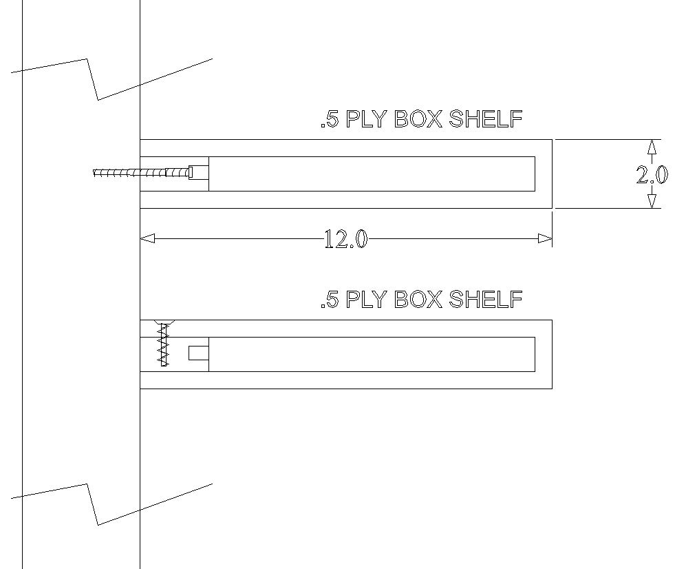

I just use lag bolts and then cut the heads off then drill holes in the shelf

Where can these black metal brackets be bought? Those Sheppard brackets look like the way to go.
3/25/23       #9: Floating shelves ...
Sheppard Brackets
