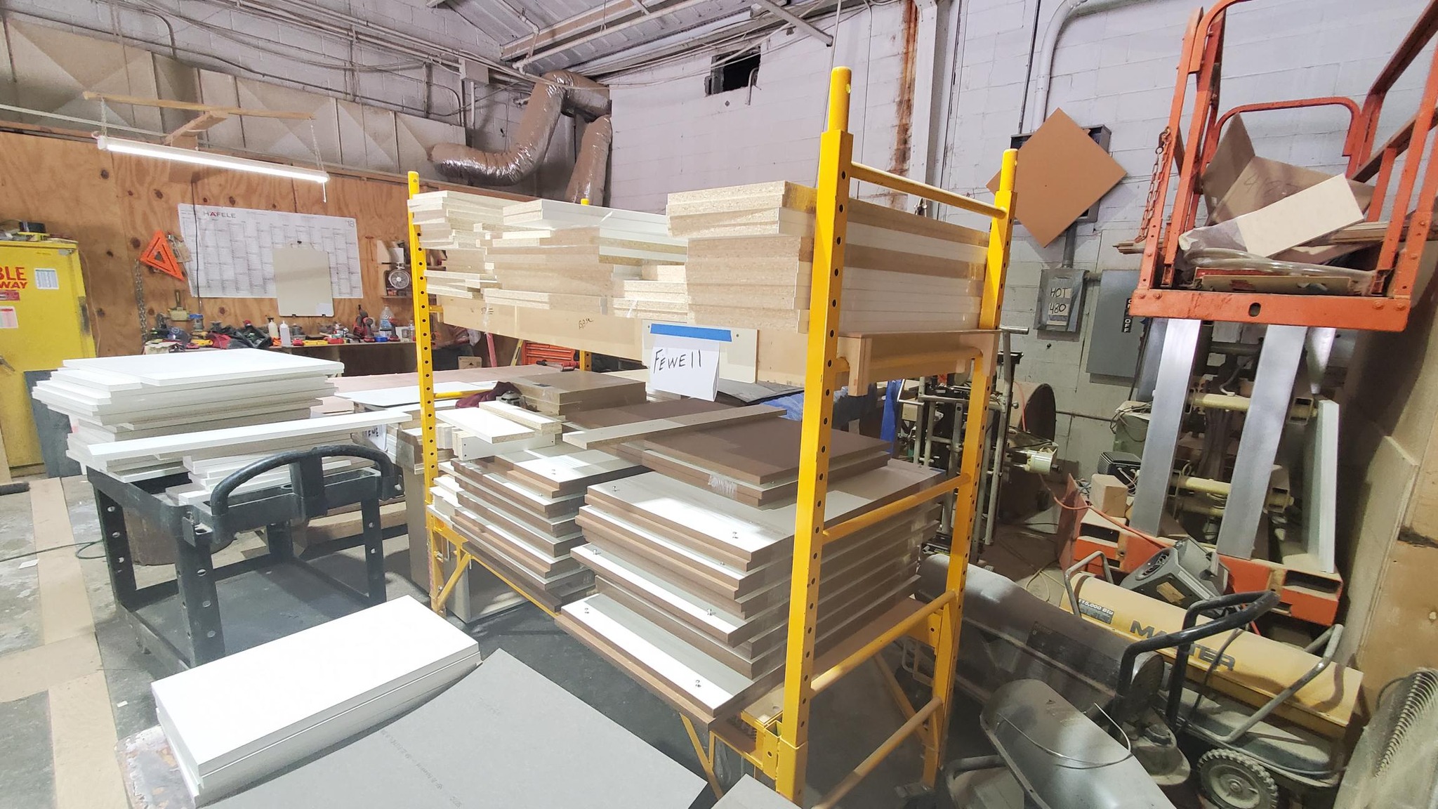

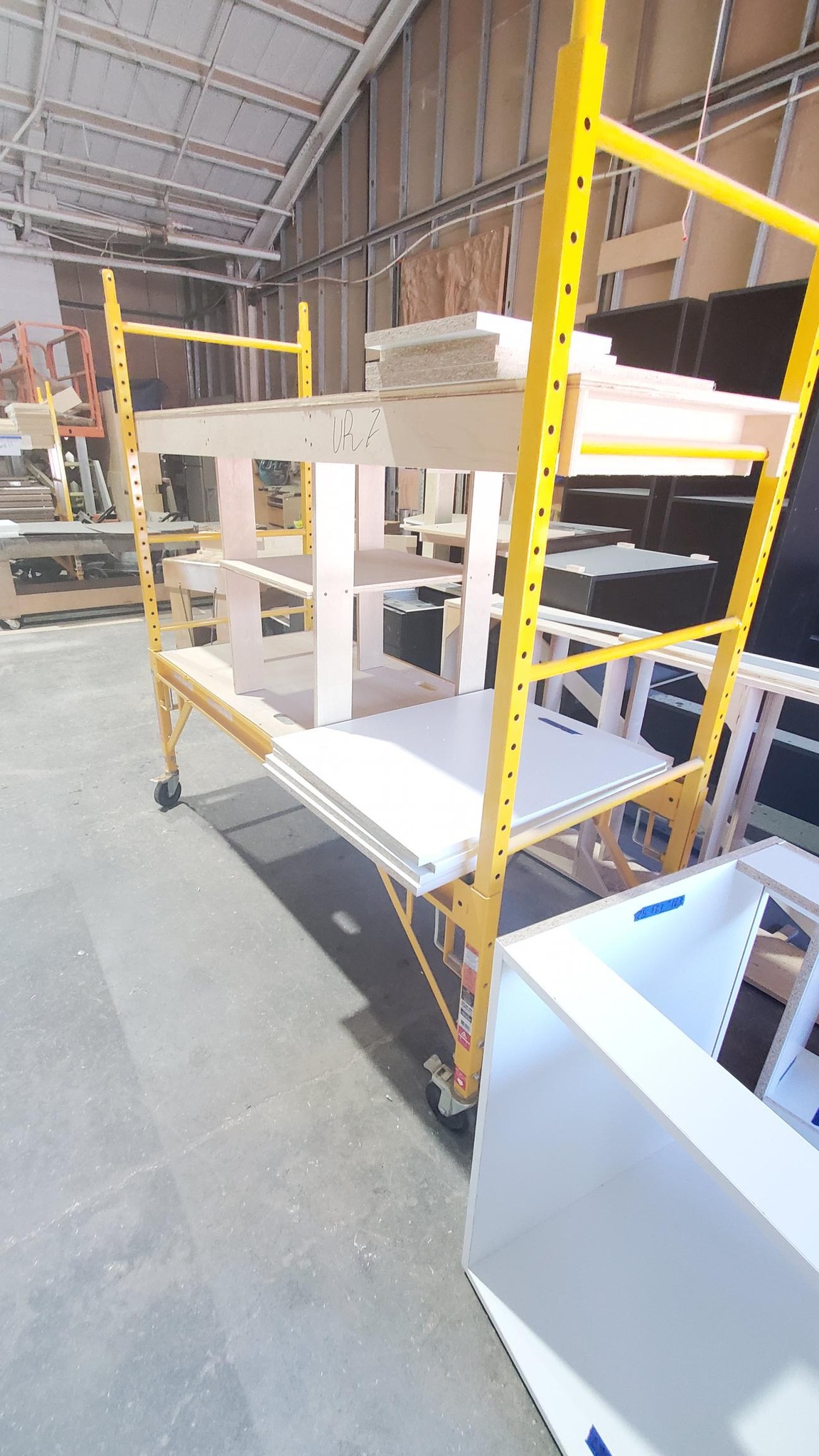

james e mcgrew  Member
We do not do doors yet we cut thousands of specific unit parts. We use bakers scaffolds where we add a shelf depending in hieght needed and create dividers for size / type etc. in the 37 years of doing this this has served best
4/30/23       #3: Solutions for parts orginization ...
Another one with dividers
View higher quality, full size image (1152 X 2048)

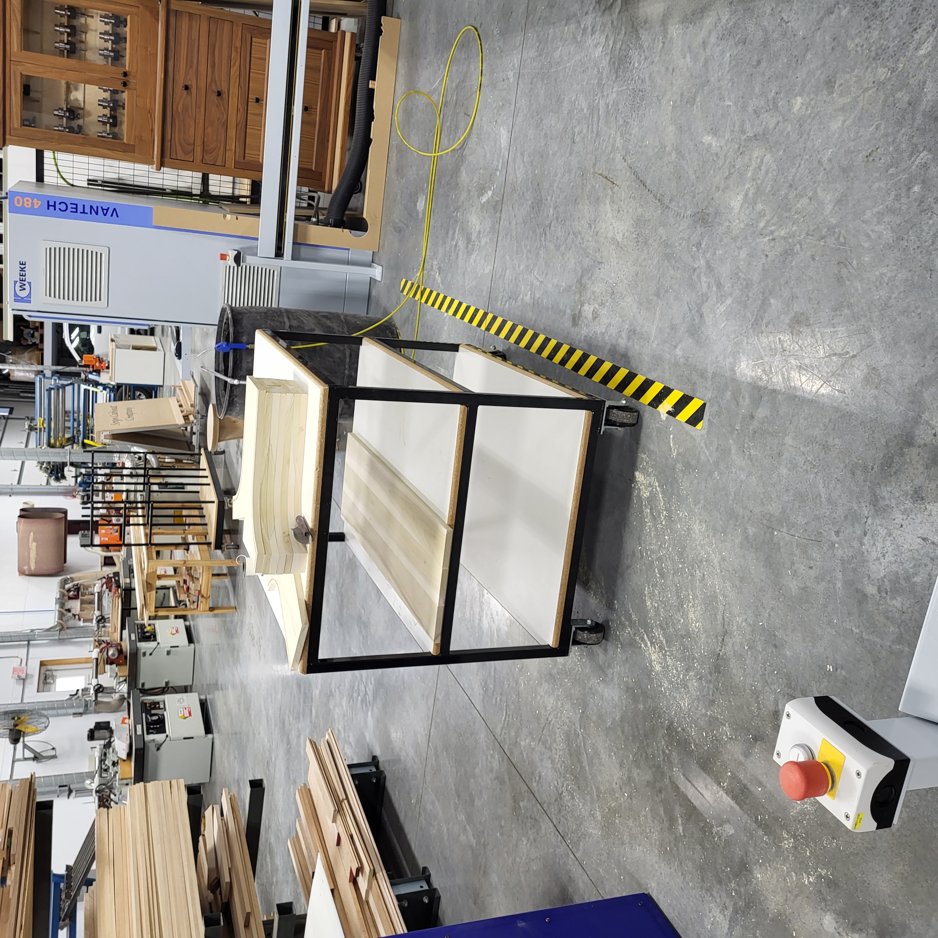

Karl E Brogger  Member
How do you assemble doors?
As an example I assemble tallest doors first.
If there's more than one width of that particular door height, I assemble widest to narrowest.
Then move down the list.
Panels are cut and stacked in that order.
Stiles are cut and stacked longest to shortest.
Rails are cut and stacked longest to shortest as well.
I grab the longest stiles, the next panel, measure the panel to get the rail length.
Glance at the cut sheet to make sure something isn't going stupid on me.
Then assemble.
I'm not doing anything fancy for carts. Just three level general use carts with a welded steel frame. They have many applications.
You're doing WAY more doors than I am though. I think what I'm doing wouldn't fit for that much throughput.
Are you using an optimizing saw I assume? That throws a wrench in it since you might not have a repeat part in the same stick.
View higher quality, full size image (2992 X 2992)
