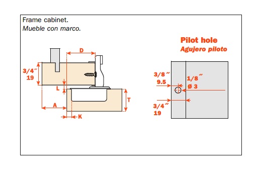

Hi Al,
Unfortunately, you will not be able to get the reveal (A) down to an 1/8" with either Salice or Blum (or any brand face frame hinge). Here are the details for Salice face frame hinges.
The gap requirement changes based on the overlay you choose.
For overlays of 1/4" to 3/4" an 8.3mm gap is required to turn the door (3/4" square edge) without rubbing.
For overlays of 1" to 1-7/16" a 5.2mm gap is required to turn the door (3/4" square edge) without rubbing.
Blum FF hinges require slightly larger gaps in each case.
