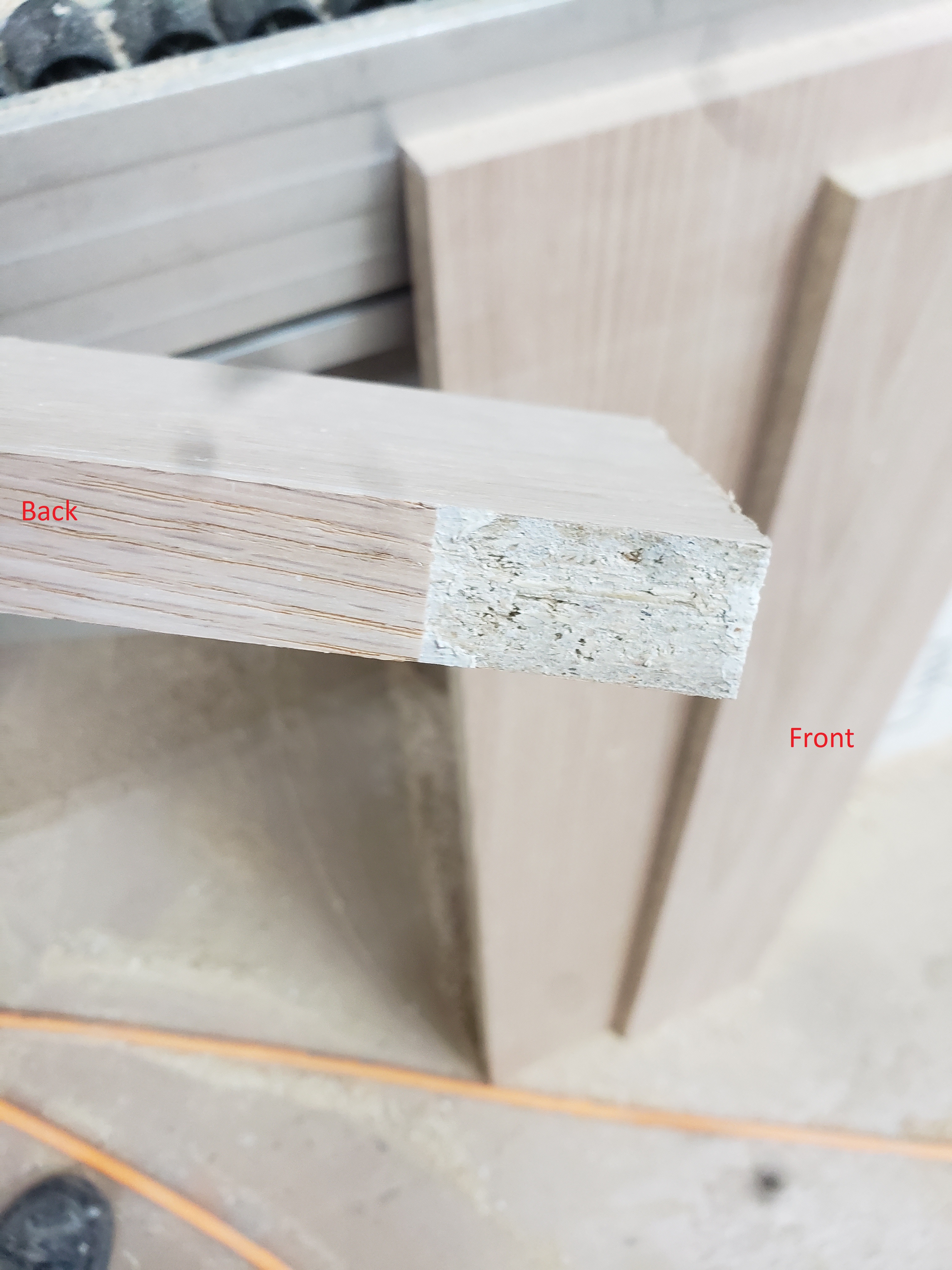

I have issue with tape feeding for Biesse Acron 845 edgebander.
Tape does not apply in front.
Can somebody advise me how to adjust tape feeding?

Rich  Member
I would guess at a pressure roller issue and the tape is sliding back. I find the using the slow-motion video is a great tool to see what is happening when troubleshooting edgebanders.
