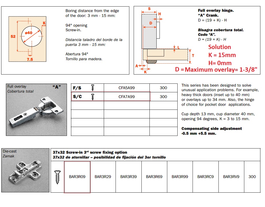

Im wondering if anyone has a solution for Blum style hinges that can accommodate a 1 1/4" thick door but also a 1 1/2" gable? I have sourced the hinge from Blum but haven't solved the gable problem. They are full overlays.

Blum 38b355bf22, assuming that the Gable can take a hold the screws well this hinge will work. The only drawback is that this hinge leaves 3/16'' space between back of door and box. Do a mock up for bore drill distance.

The 1-1/4" thick door is not a problem but if you are looking for a 1-1/2", full overlay it will be a bit of a challenge.
The Salice F Series will get you to a
1-3/8" (34mm) overlay by following these instructions. To my knowledge, this is the only concealed hinge on the market that can achieve this overlay.
