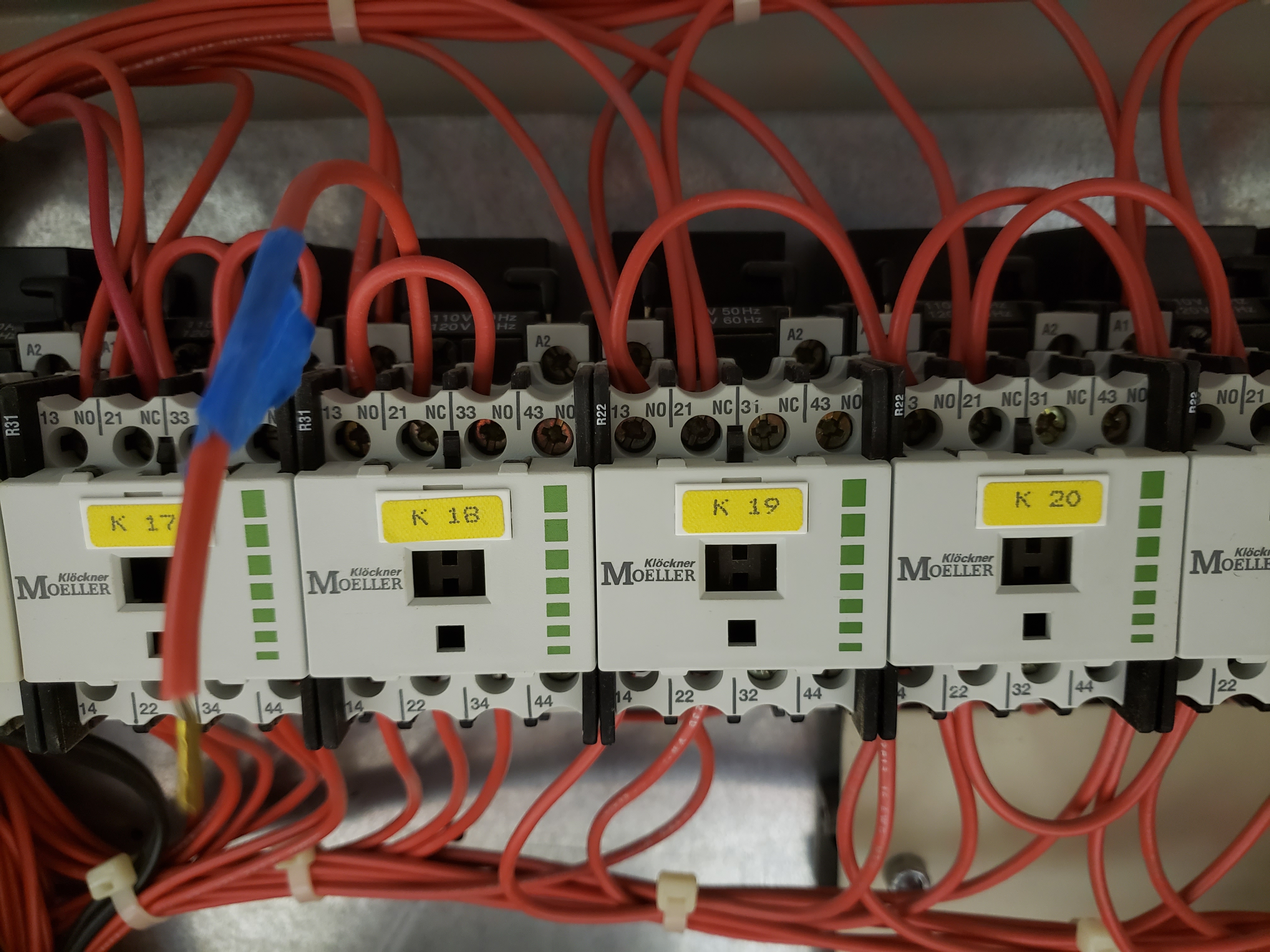

I have worked thru many of the setup with the new to me machine however I have 2 issues to address before were good.
1, I believe the trimmers are locked out due to a wire that came loose from its contactor relay causing the frequency converter safety circuit fault (I need to find it's correct location).
2, The edge tape is not advancing far enough to the main feed roller to be grabbed by the advancing of the workpiece, the mechanical parts seem to be functioning adequately (it will need a new drive belt soon). I suspect there may be a feed duration timing setting issue however I do not know how to adjust.
Link to cabinet photos may help to see the problem.
Any help is truly appreciated.

Thomas, I have the same machine, year 2000.
I'll take a picture inside the cabinet , maybe you can see where the wire goes.
I also know how to adjust tape advance. Tech who installed the machine, wrote it inside the cabinet so I don't forget.
I'll be home in 2 days, then I can send if you don't figure out by then.
