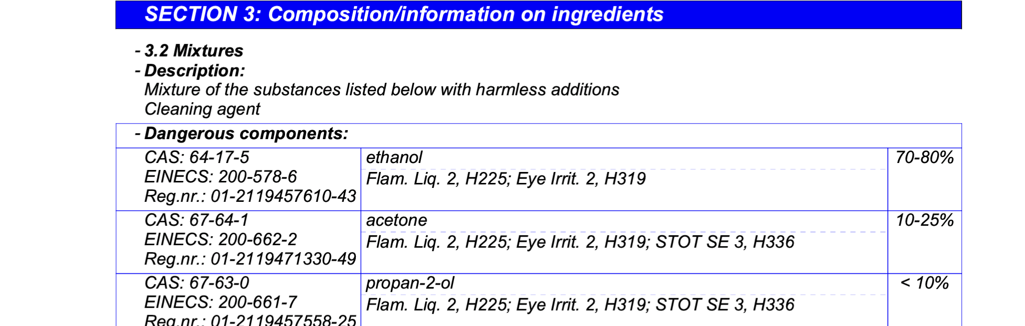

This is about the cleaning liquid that gets sprayed on a workpiece just before scraping and buffing operations on a EVA hot glue edgebanding machines.
By looking at datasheets of some of the commercially available products on the market it looks like they are mixture of ethanol, acetone and isopropyl alcohol.
Has anybody tried their own recipe and what mixing ratio did you use?
Some people told me they use just acetone, and that it works same or better than those commercially products they were buying before.

We buy Riepe LP 163/93 Cleaning Agent in 30 Liter containers for $500 Canadian dollars. To buy 30 liters of ethanol and acetone at 75/25% ratio, it would cost us about $400. The $100 savings over 75,000ft edgebanding isn't worth it for use.
If going the acetone only route, you need to make sure that the lines carrying the liquid from container to spray nozzle can handle 100% acetone and dont melt.
