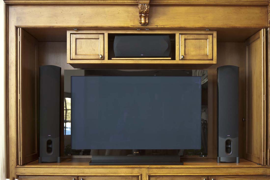

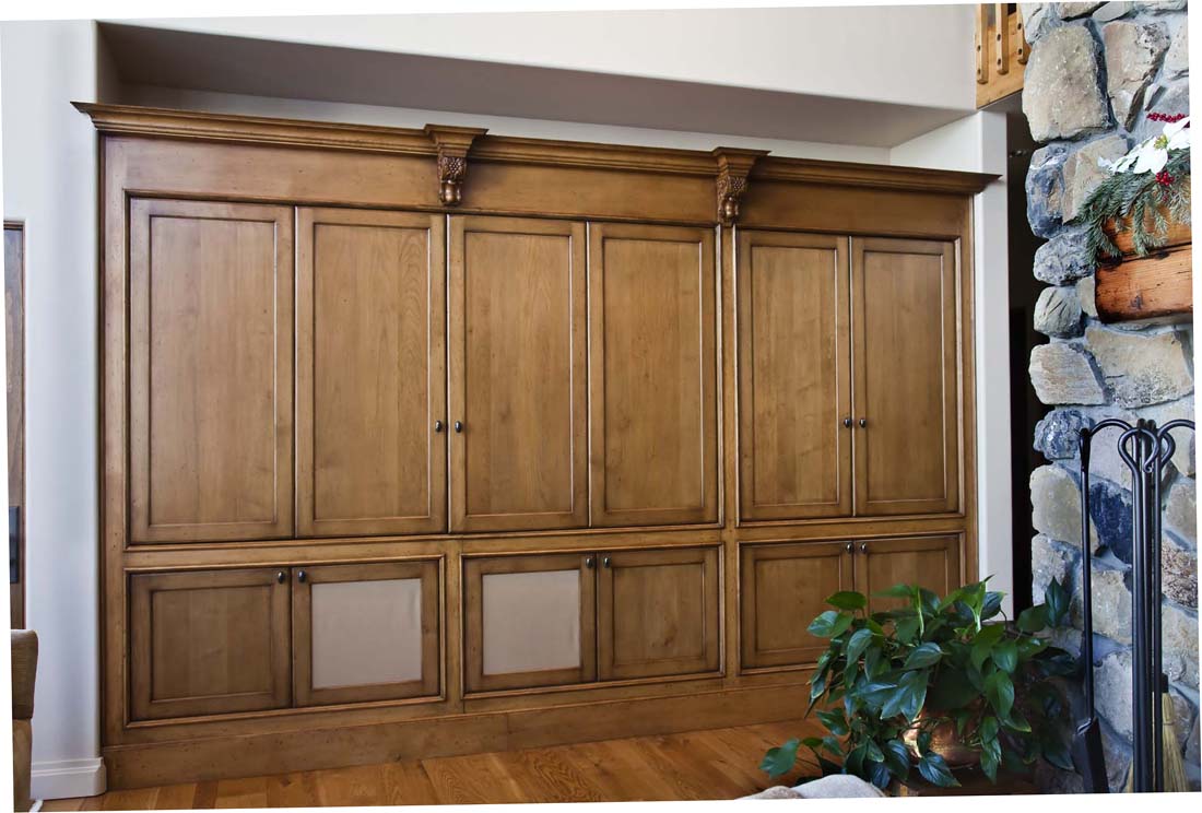

Are you trying to do 2 pairs of bifolds? Or one 4 panel quad folding assembly? 3/4 baltic birch panels are gonna be a bit heavy. Doors with a 3/4" hardwood frame with and a 1/4" panel will be a lot lighter. The opening in my photos was over 7' wide, but those bifolds worked well.
