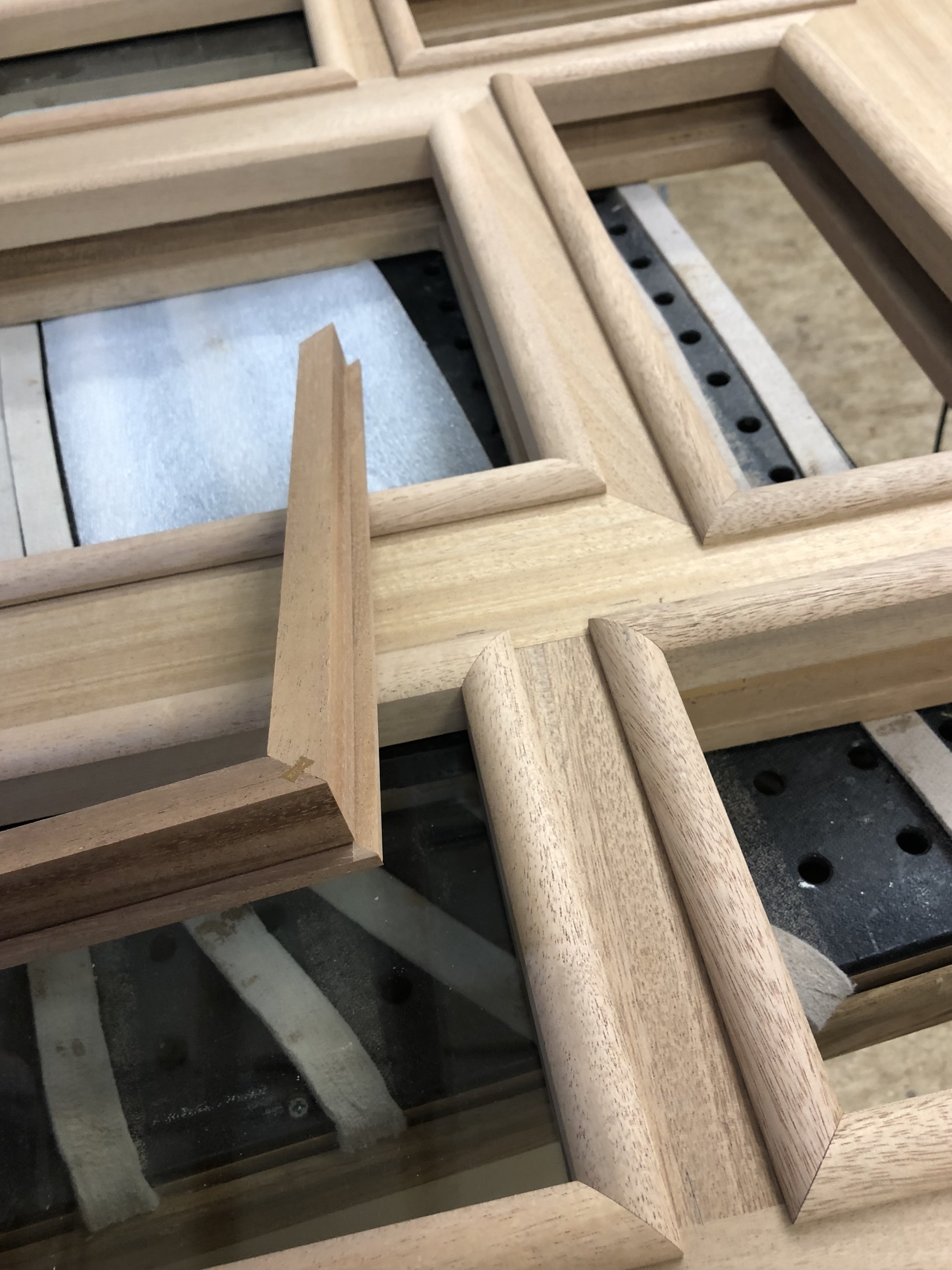

Joe Calhoon
I’ve used one for years to assemble Bolection mouldings and glass beads on doors. The process is very fast but be aware if you are dropping a moulding into a recess you might have to do some fitting as the frame tends to grow a bit. I slightly bevel them on an edge sander for final piston fitting and that takes time. The other advantage for windows and doors is the assembled frames are easier to finish as a unit instead of individual sticks. But that would not apply to you.
The only advantage you would have is the joints will remain tight and not separate after nailing in as sometimes happens.
View higher quality, full size image (2946 X 3929)
View higher quality, full size image (2860 X 3814)
