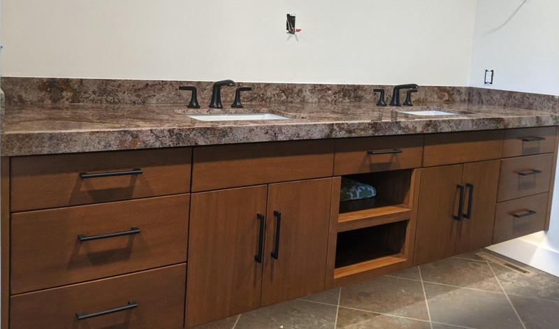

Dropout I did this vanity 2 or 3 years ago. Quartz top. The customer had a friend that did countertops and installed it. There was a special metal support that was used to support the top but I don't know what it was but a confident quartz dealer should know.

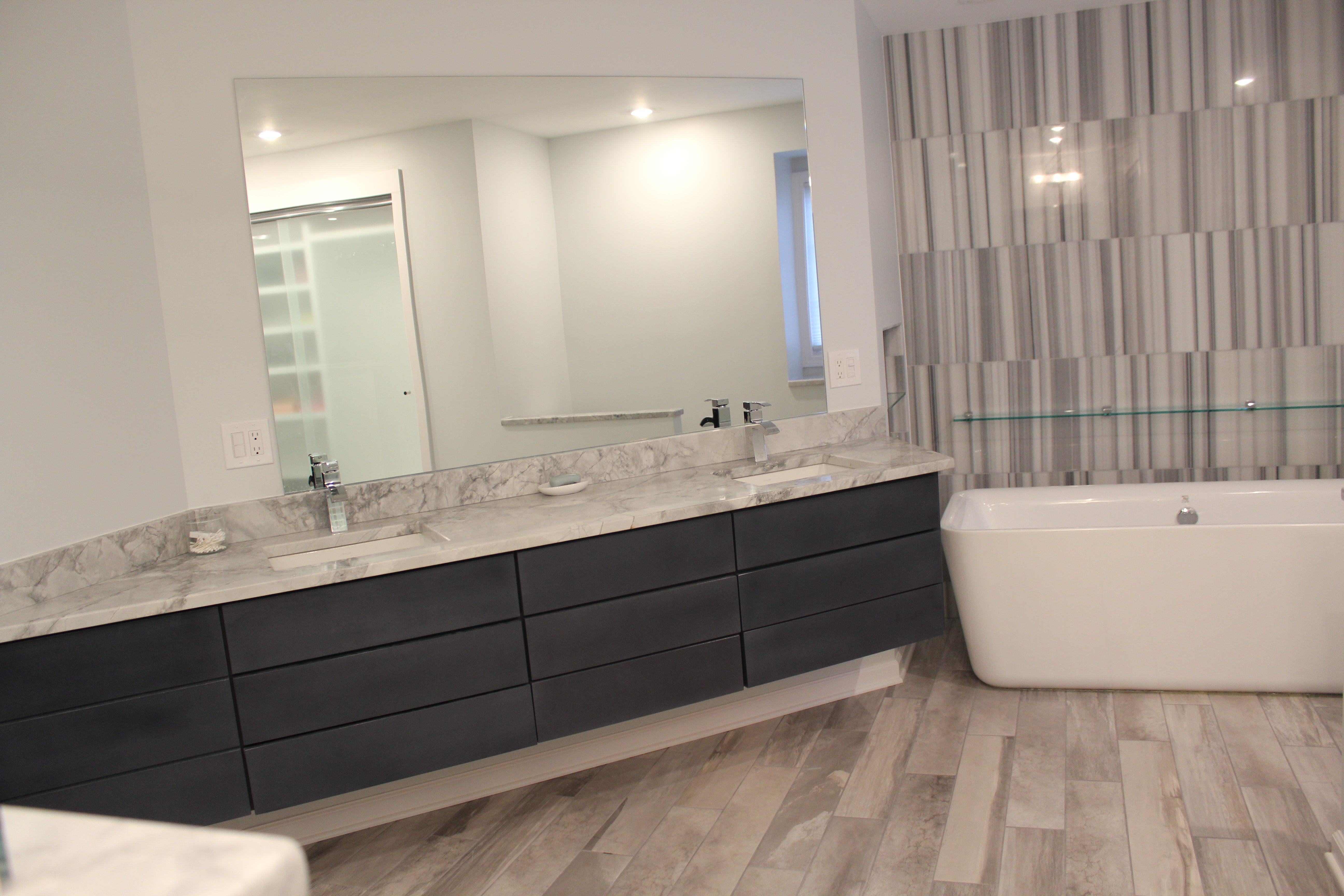

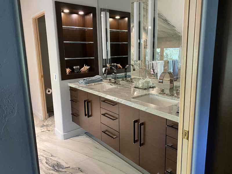

I've done quite a few of these in the last 7 or 8 years. If it spans wall to wall, we'll screw the cabinet sides into the side walls, with shims to fill any gaps.
If one end of the cabinet or both aren't making contact with a wall, I've screwed steel L brackets to the studs to help support the weight from underneath.
Haven't had any failures with these methods.

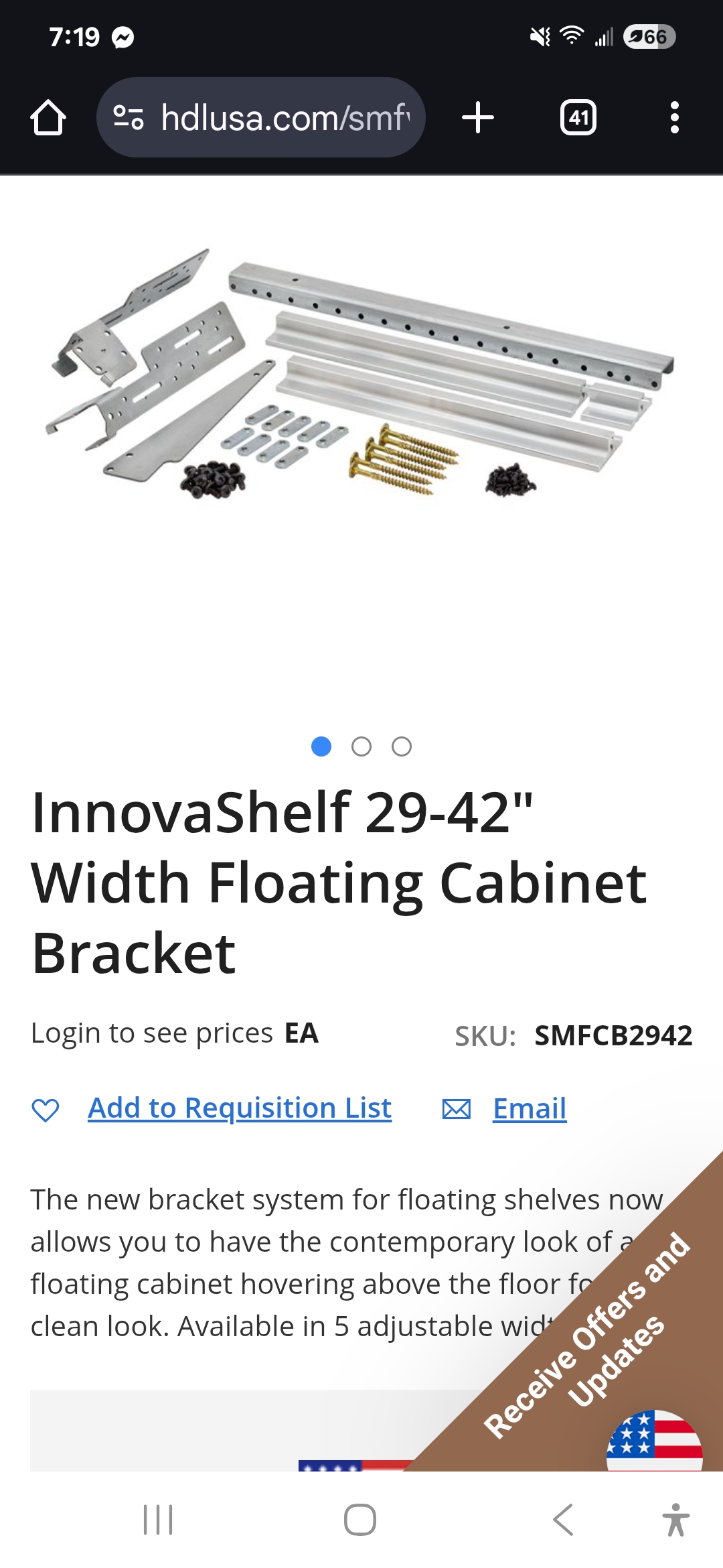

We do floating vanity all the time. We use Innova Shelf brackets. HDL carries them. They work amazing and never had any issues
