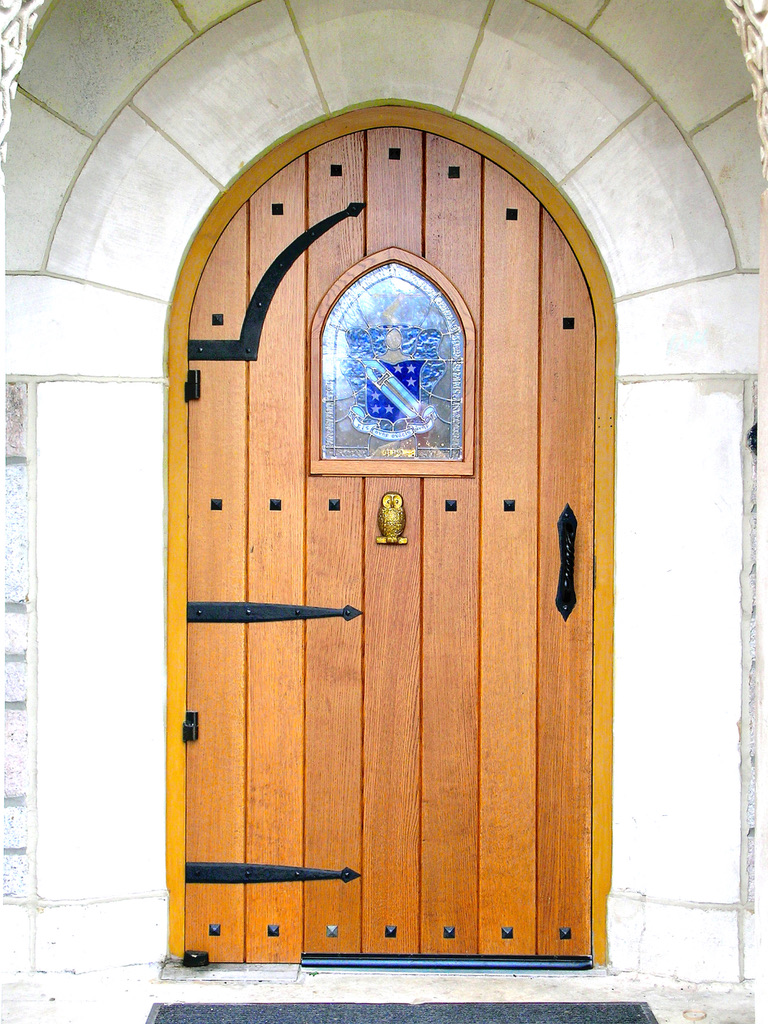

This door has a closer/floor pivot recess into the floor and two intermediate hinges. Last I saw, it had been up over 12 years, no problems.
We got into big pivot doors for a few 6' x 10' doors and similar sizes. Only two points, top bearing carries almost weight, the lower hinge/bearing do all the work. 12" - 18" of width of the door would swing to the outside when the other segment swung in.
I could only picture anxious children greeting guests and their fingers getting worse than crushed by the physics on display. One of the site carpenters referred to it as a "cat-killer", citing the animals propensity for last minute charges at a closing door.
