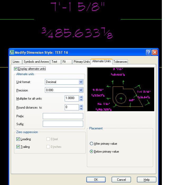

ok so for years I have been doing my dimensions kinda wrong, and looking for help on how to correct it. The company likes us to use ft./in and in. all in the same line normally I would just use text overide in the properties menu. so we would type in 24'-0"\P( ) the trouble comes when we change something and forget to change the 24'-0" to the proper ft./in. and I'm wondering if there is a way that autocad can do it without the human error part. not sure how lisp work but want to learn, so if anyone has an ideas please
let me know. Thank you

10/22/13       #2: Automataic dim setup ...
Alex
You should check out alternate dimensions.
Set primary units to architectural, and alternate to fractional.
IMO, you should use one or the other, not both..... but I understand how companies operate. Seems like shop guys dont want to think, but I could be wrong. I often am.

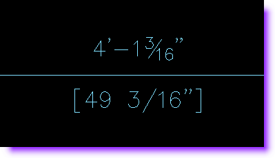

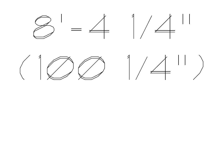

10/23/13       #7: Automataic dim setup ...
steve ayars Member
ha ha , thanks needed that.. but back to the question, some what self taught with autocad doing it for 8 years and never really messed with the alternate units. so I did what alex wrote but used decimal units but I'm getting a 3/4 before and 7/8 after the alternate dim. any ideas on why and what setting i might need to change. thank you for any help
View higher quality, full size image (640 X 702)
10/23/13       #8: Automataic dim setup ...
Alex
Set your alternate units to fractional (if you want that as opposed to decimal).
There typically are brackets around the alternate units. My guess is the font you are using is 'substituting' those brackets with fractions. Try using a more generic font and see if that helps. Sometimes those "cool" looking fonts can cause problems.
