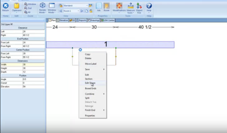

EmVella Member
I am following this tutorial in youtube and I am also lost. When he goes to Plan view he has Edit Shape and other features, nnd I do not have those features.

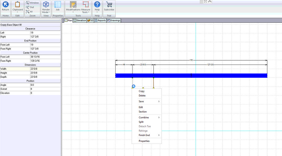

6/2/18       #9: Cabinet Vision Question ...
EmVella Member
And in another tutorial Cabinet Vision - Advanced Shape Editor, when he clicks with right button on the object he has Edit Shape and I do not have!

6/2/18       #10: Cabinet Vision Question ...
JoeW Member
EmVella.
Okay. A lot has to do with your level of Cabinet Vision. Essential is very limited. But should have some functions you need. I have CV11 Ultimate, so I need to research essential and see what it is capable of doing.
What you want to do is definitely doable in CV11.
CV is a very good program, but can also be expensive. I started in standard and quickly moved up to advance and then ultimate, Just got tired of hearing, you can't do that at your level.
Ill update soon.
Joe

No Cabinet vision doesn't charge for the basic tutorials. But the more function you want from the program the more you pay.
Essential has very little function compared to ultimate. As you PAY more and go up the tiers, the more function you get. In fact, EmVella cannot accomplish what he is trying to do with essential. I think he needs at least Advanced to do that. Poor example Cabinet Vision gives limiting the free trial to only essential.
In other words, you want total custom control, pay for Ultimate. Cabinet Vision is a very good program, but you really need to sit down with a resaler and have them show you which level is best for you to accomplish your needs.
6/4/18       #13: Cabinet Vision Question ...
JoeW Member
EmVella,
Sorry to say you cannot accomplish what your trying to do with just Essential.
Ultimate, definitely, Advanced probably.
Perhaps having one of Cabinet Vision's resalers come out and show you what each level will accomplish will help.
Make them show you. DO NOT just accept "Oh sure you can do that with this level".
I'm sure all the tutorials are presented in Ultimate.
Joe
