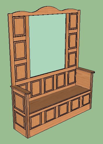

I work with Mozaik Software and I took a peek at your website. We can handle your standard cabinets and your furniture items as well. I took a minute tonight to do a quick mock up your wall tree.

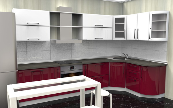

I think this online app may be something that you are looking for http://prodboard.eu/kitchen/
There is a free demo, where you can test it and make simple projets as well as official version for more serious tasks.
View higher quality, full size image (600 X 375)
Online 3D Kitchen Constructor
