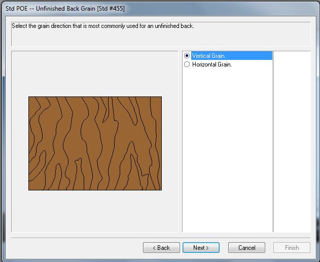

Darren Member
Derek,
Is your Assembly Construction - unfinished back grain direction set correctly.

Derek S.
Darren,
Yes, our backs are setup correctly. And the cutlist is orienting the backs correctly, and we've run via ascii file correctly for years. But for some reason it would appear that the DXF information just for the backs isn't being exported correctly. At least that's the assumption I'm going on right now, we'll see if this fixes the problem. Thanks John, by the way, for the UCS. I'll try it right now.
