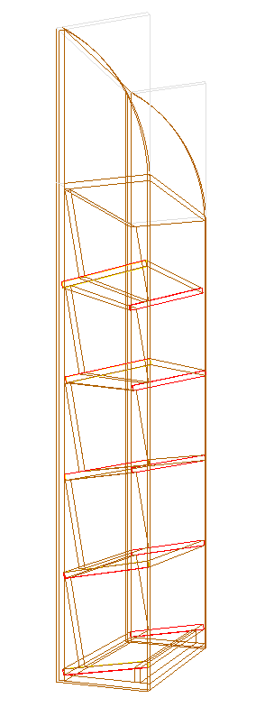

cabinetmaker
Edit End view grab shelves - left box on screen with numerical data - angle of fixed shelves.
the adjustables can just be set via offsetting the pins

cabinetmaker
In edit. Copy shelf move with mouse. Numerically place and change dimensions While in end view.

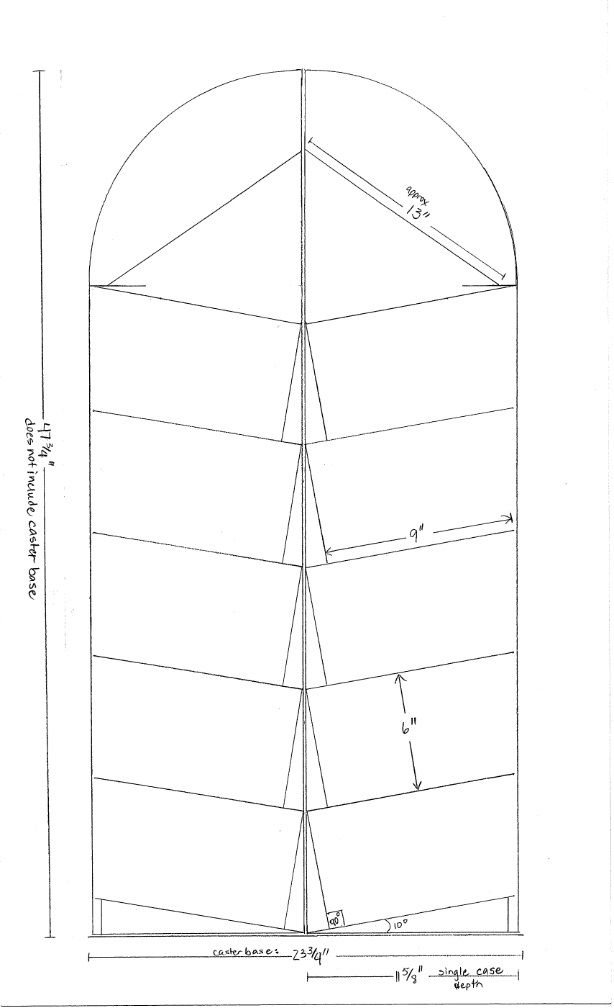

Bob
Ok I can make that work.
I still need to figure out how to make the double sided shelf with the sides being one piece with the backing in the middle. And if possible the connections will be blind dado.
Any ideal if i can do that with Cabinet Vision ?

JoeW Member
This can be done. But it is not a simple thing. Depending if you need to keep intelligence or not determines how complex it will be.
If it is a one-of, you can simply add two parts for the bottom shelf. And one for the remaining shelves.

cabinetmaker
set up a construction method and materials method
make sure and remember that your backs are 3/4" thick
the cabinet need to be brought up in plan and told that both front and back are finished faces
