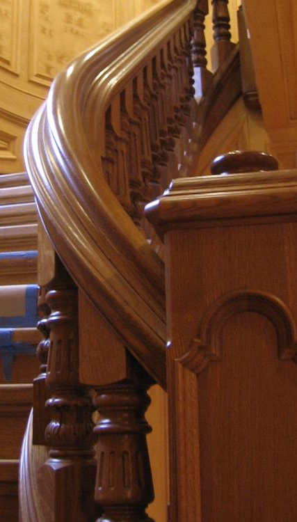

Hi Chris,
It sounds like your approach is similar to mine. The photo shows an interlocking 2-piece handrail which was modelled in SolidWorks (probably Inventor or TopSolid can do similar). The parts were modelled and machined to be slip-fit so that the lower half of the rail can screw down to the balusters and then the upper half is site glued after (the attached YouTube link shows the wreath exploded).
To answer your question in a nutshell, yes, solid modelling is a great tool for this and you have full control over the orientation. Feel free to drop a line if you want to know more. Cheers.
