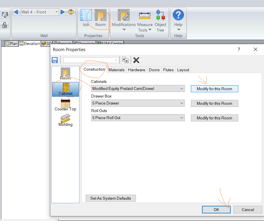

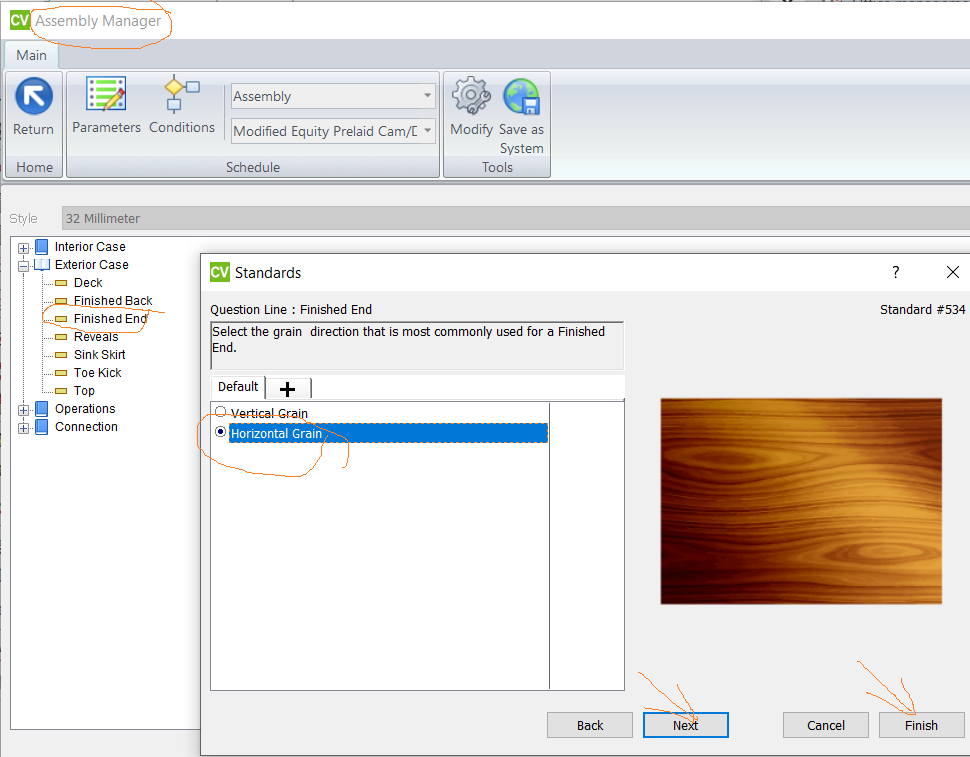

12/12/23       #8: Cabinet vision ...
Dustin Long
Well, it's a "Zombie thread" but I found the messages in a web search, and then I found an answer. Posting it here in the hopes it helps someone else.
I was able to change grain direction on finished ends in CV11 by going to "Room Properties" -> Cabinet -> Construction Methods -> External Case -> Finshed Ends. There is a "checkbox" in the interview dialog 2 screens in that allows finished ends to flip grain. Check this box, click Next and Save/Exit to allow the room to be updated with changes.
