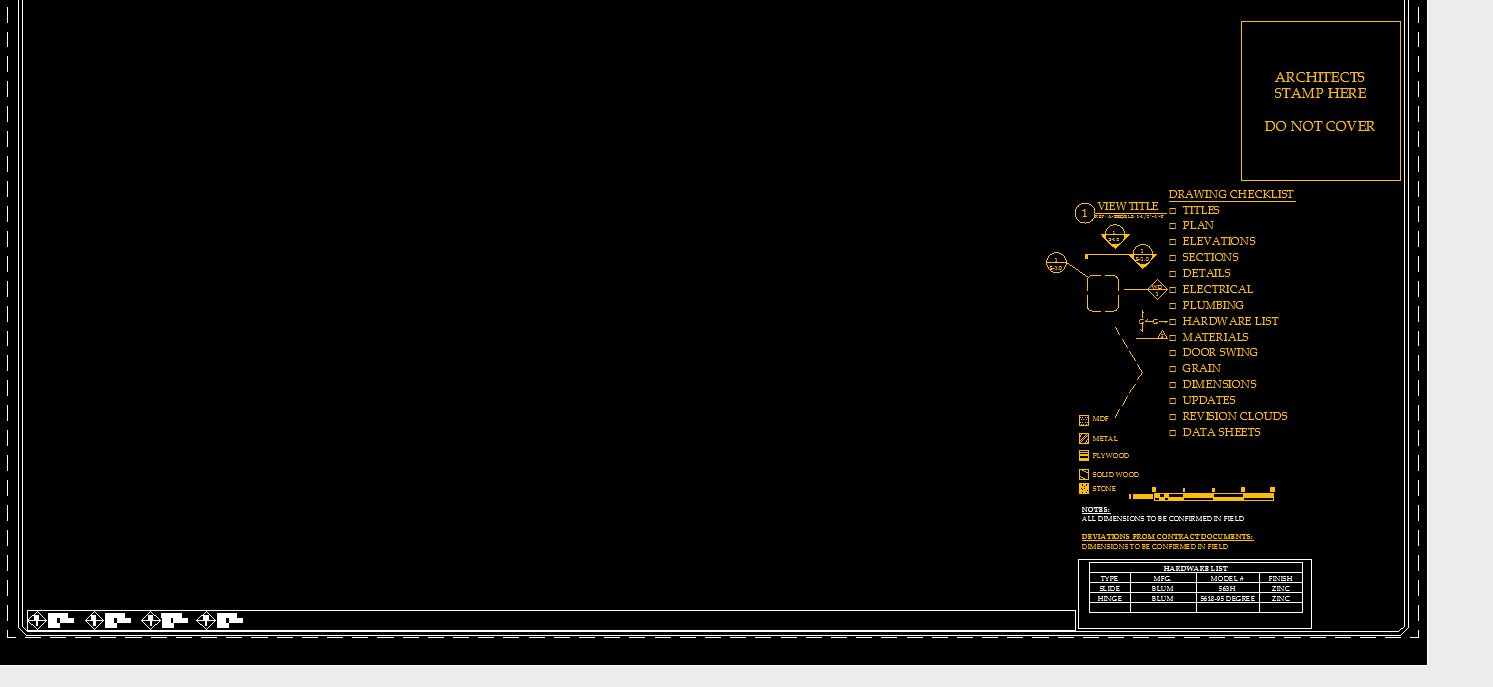

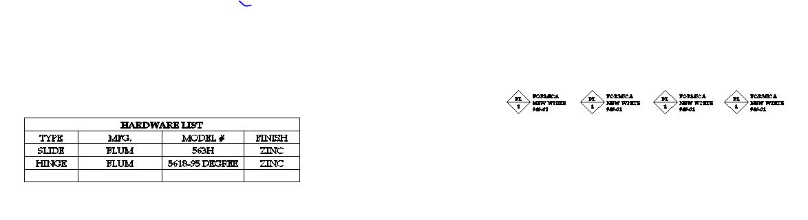

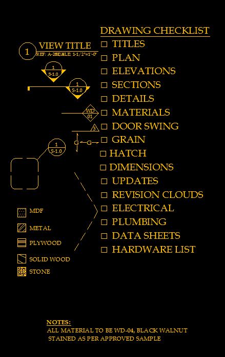

James Falk
Greetings Dan,
One of the things that we have done is to have a list of all items that need to be included in the drawings on a "Do Not Print" layer in a corner of the drawing. This way whoever does the drawing will use the same fonts, symbols, and hatches. Hopefully, this way, they will not forget to include something, like grain direction, which can cause problems after the fact. I also have, in the page template, a viewport that goes back to the model space where all the finishes are listed. This way each page is the same.
All the best,
James

12/12/19       #10: Accuracy of Shop Drawings? ...
Dan
That is a good idea Jim, to put those things into each drawing to assure accuracy and consistency. I do something similar by using the tool pallet. Blocks, Dimensions and such can be added to a Tool Pallet and when needed the item is selected on the pallet and used in the drawing. All settings are maintained from the original item.
