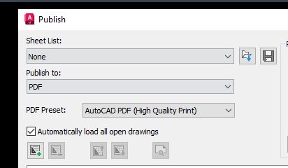

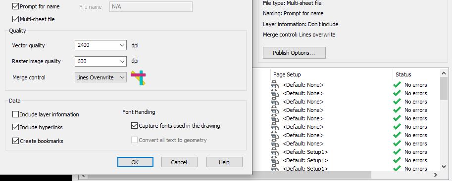

Batch Plot -> publish options -> multi-sheet file

5/10/22       #5: AutoCAD 2022 Publish ...
Moe
Sorry for the late reply - the "batch" command should take you to the screen I'm showing. It will list all the layouts that are open and allow you to select the ones you need to publish to pdf.
5/10/22       #6: AutoCAD 2022 Publish ...
Moe
You have to check the box that says multi-sheet file for it to group everything into a single file.

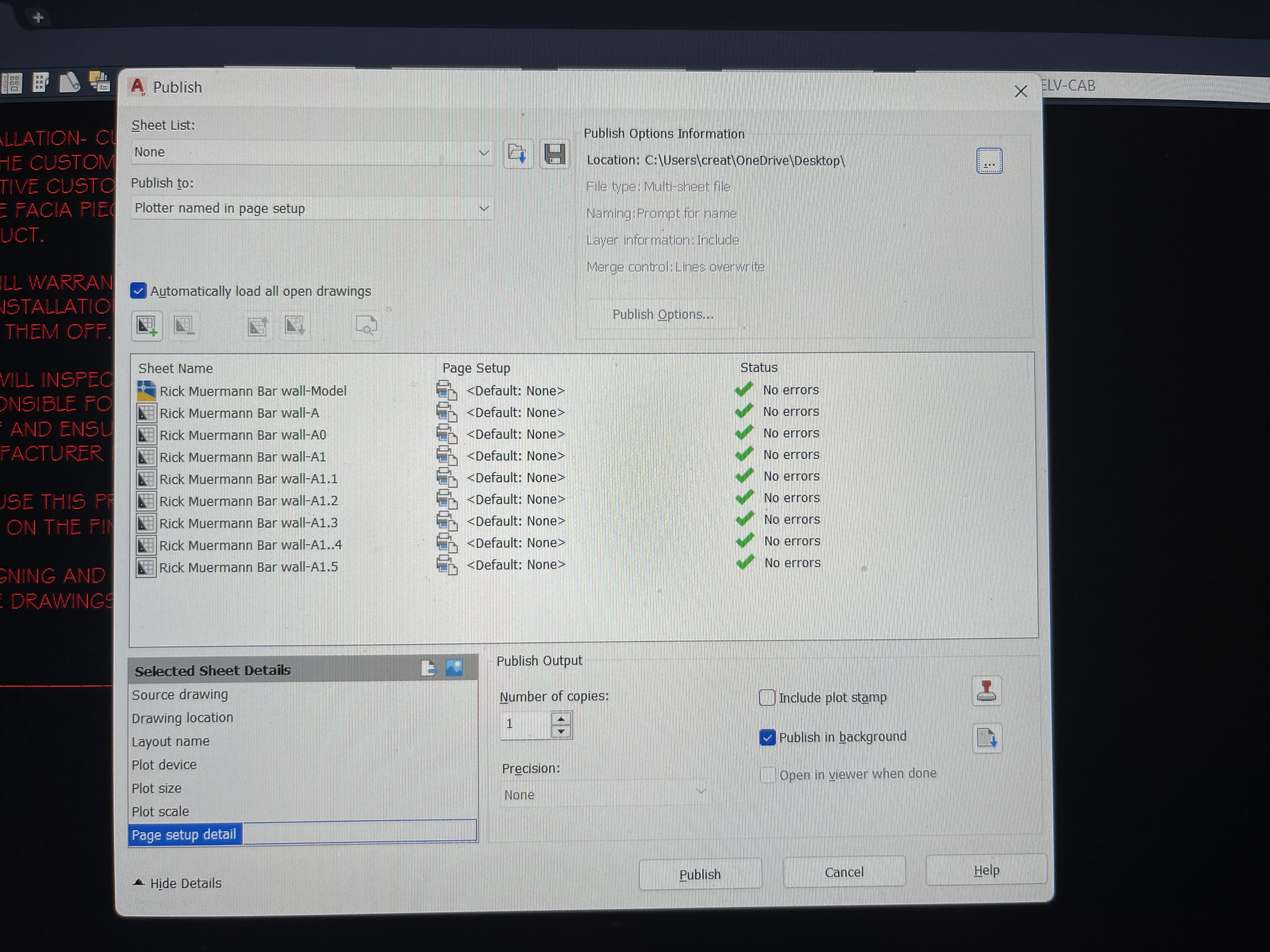

5/10/22       #7: AutoCAD 2022 Publish ...
Moe, this is my screen. The Publush Options is grayed out. If I select the three dots next to it it says select a folder for generated files
5/10/22       #8: AutoCAD 2022 Publish ...
When I select the first page I want to be published and then hit the shift key and hit the bottom page I want it as it being all one entity, then type in a file name for it, it continues to bring up the dialog box to save each and every single page separately.
