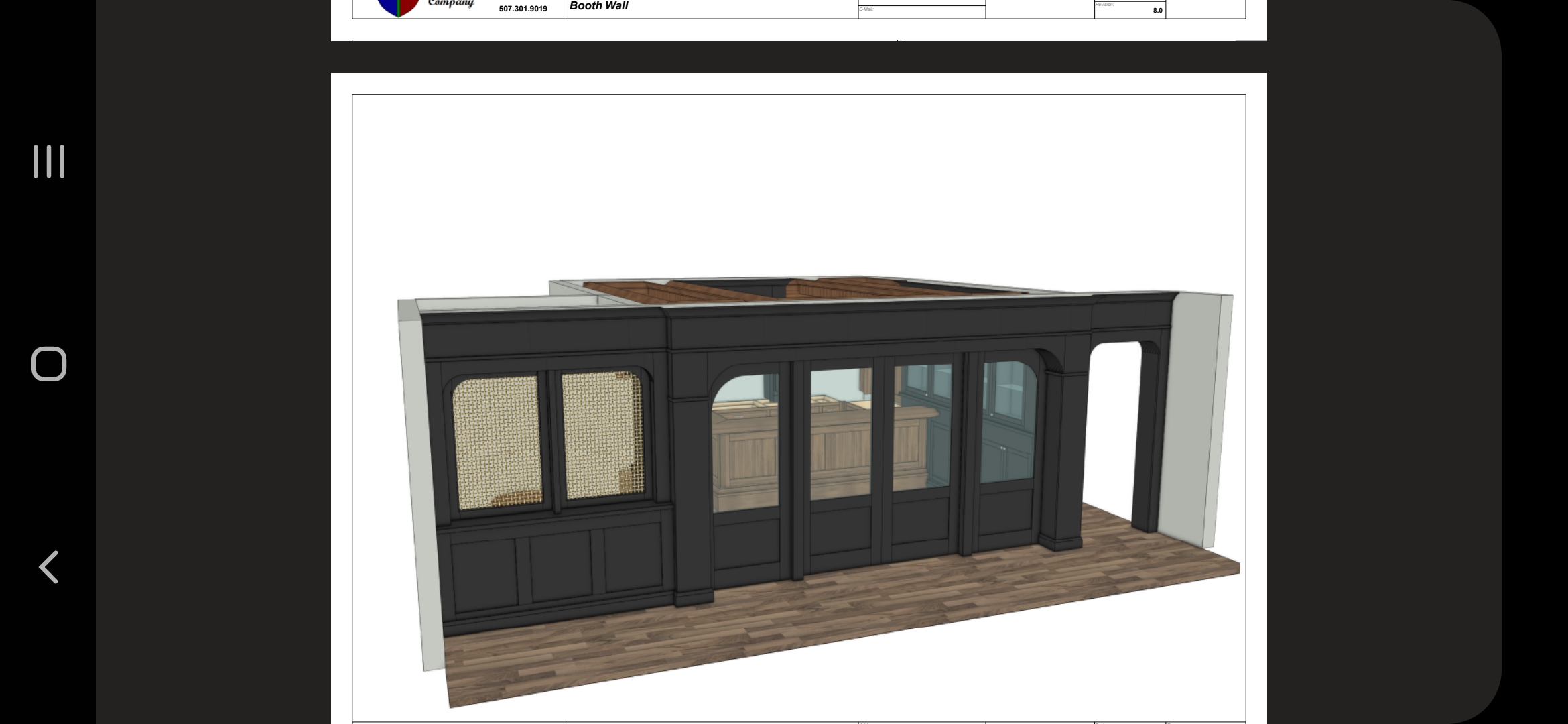

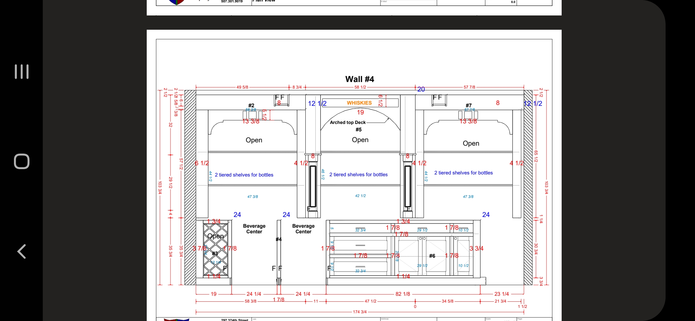

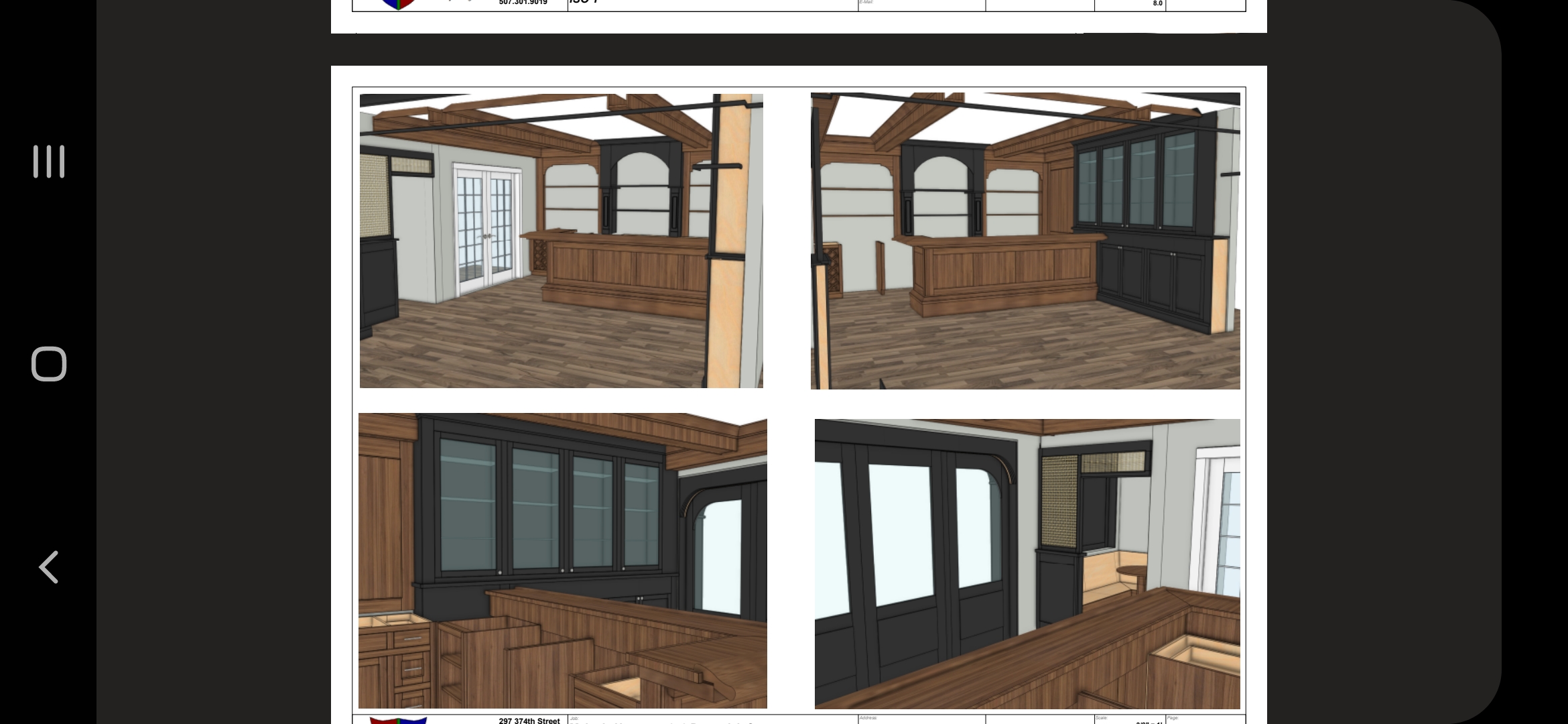

What kind of detail are you specifically looking to have stand out?
Mozaik has an add on that is supposed to make the renderings look really nice, but I don't know how much more effort needs to be put in to get it there. AerialVision? I think that's the name?
I can email you what I use for shop drawings if you want.
View higher quality, full size image (2340 X 1080)

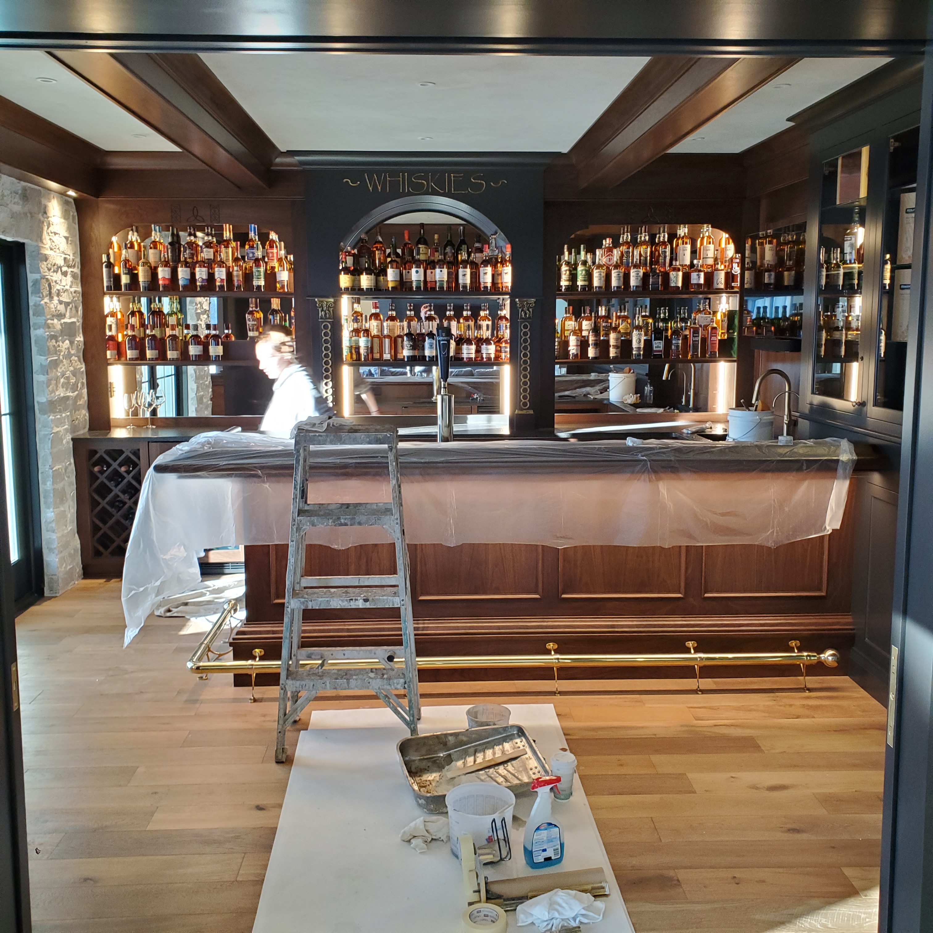

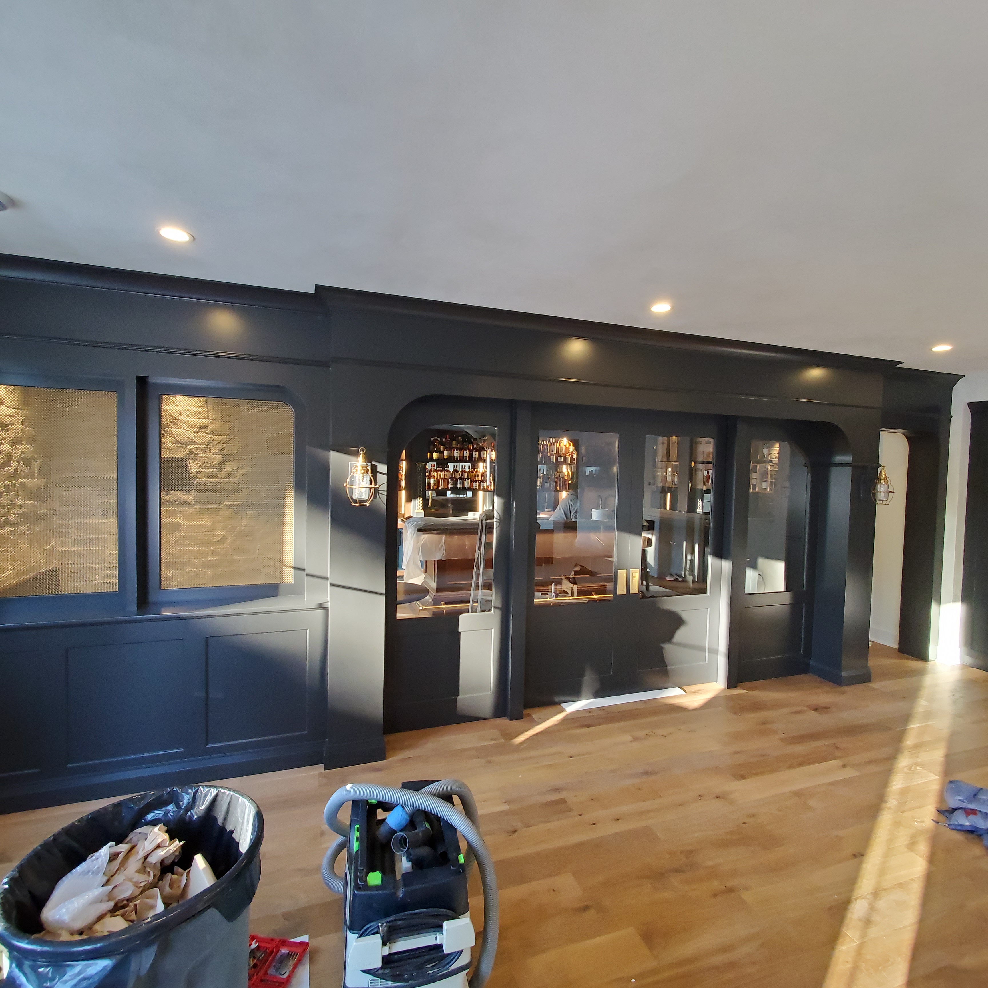

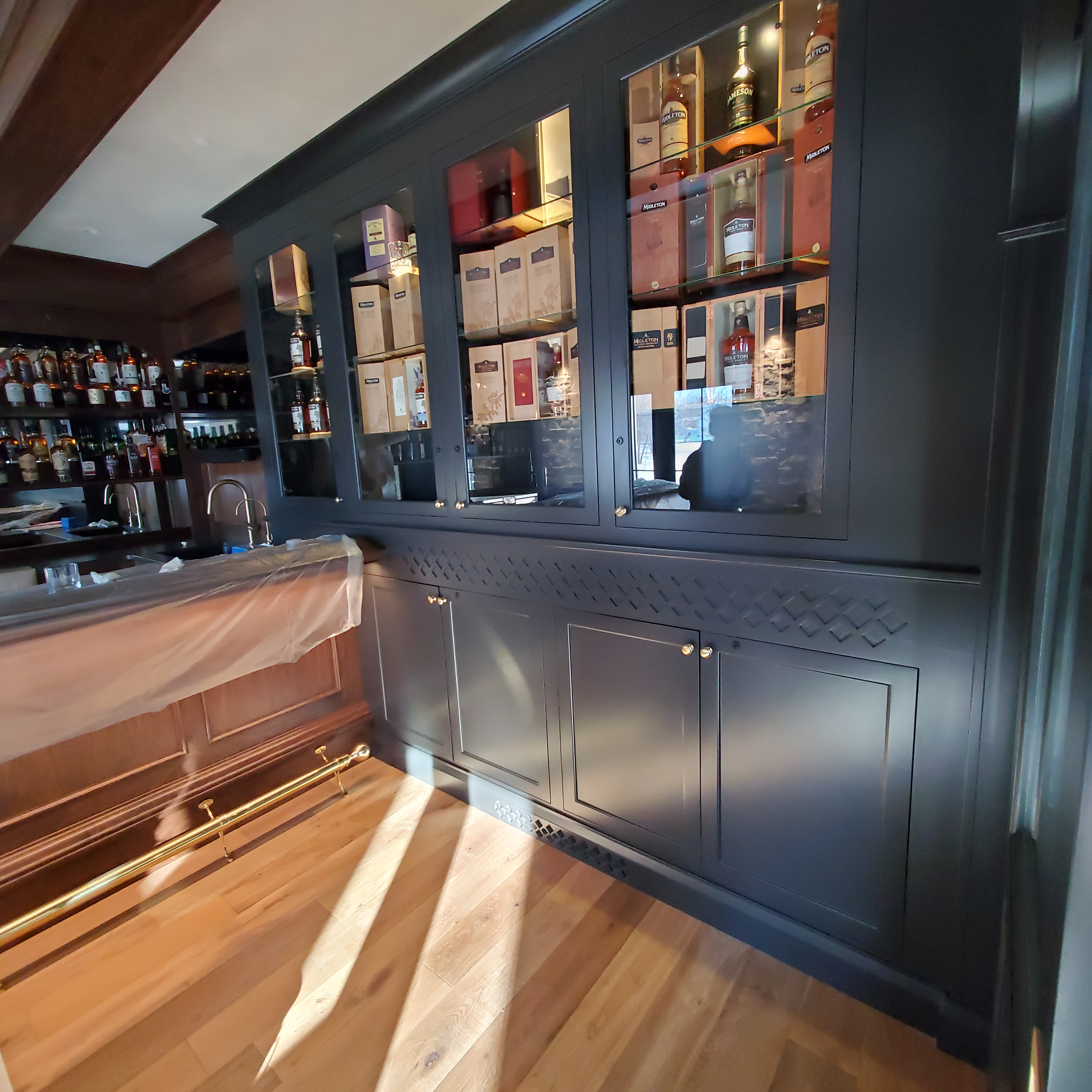

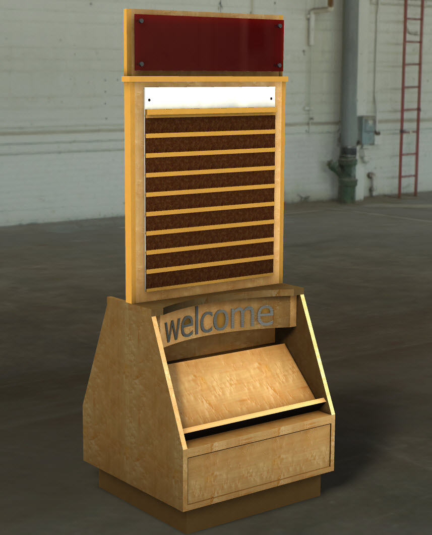

Karl E Brogger  Member
Actual job.
View higher quality, full size image (3456 X 3456)

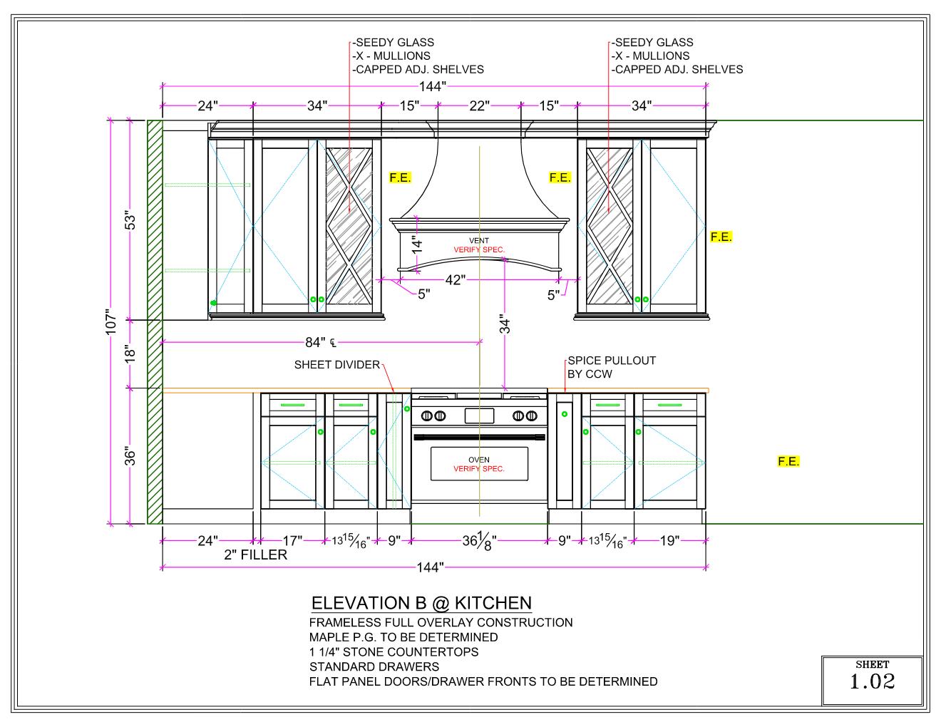

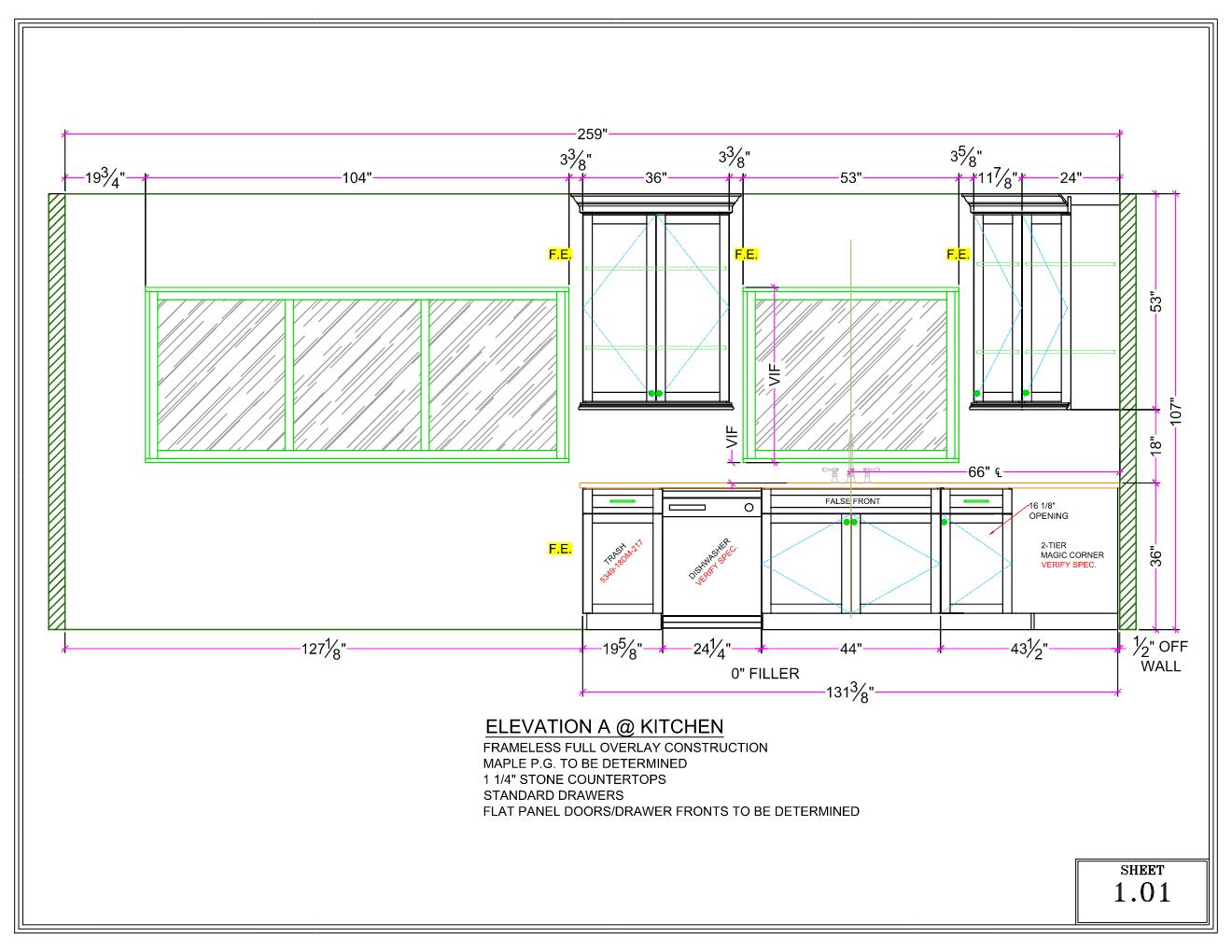

Post a screen shot of the drawings you're making. I'm curious.
9/2/22       #13: Switching from Cabinet Vision ...

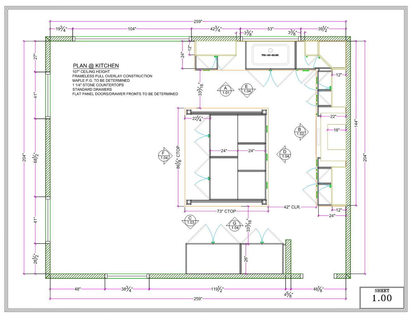

Colby Ellis Member
Here is a random job we are doing. Still in the drawing phase but this is the kind of very clean look we are trying to achieve. I can't really every get the automatic dimensions in Cabinet Vision to work like how I need them to.
View higher quality, full size image (1320 X 1020)
9/2/22       #14: Switching from Cabinet Vision ...
Jared
Colby that level of quality shouldn't be difficult in Cabinet Vision. I was under the impression you were after something more complex. Yes the auto dimensioning is sometimes jacked up, but redimensioning takes only a minute for a project that size. Even though I haven't been happy with CV for a while, I can still design and draw faster in one program compared with redrawing in Autocad. I wonder if you just need to revise your method of work. I never use a drawing scene without cleaning it up first. Send to drawing, remove extra lines, redimension, hatch, annotate. Is your PC cripplingly slow? CV's cad isn't great, but with some tweaks it can produce reasonably clean drawings.

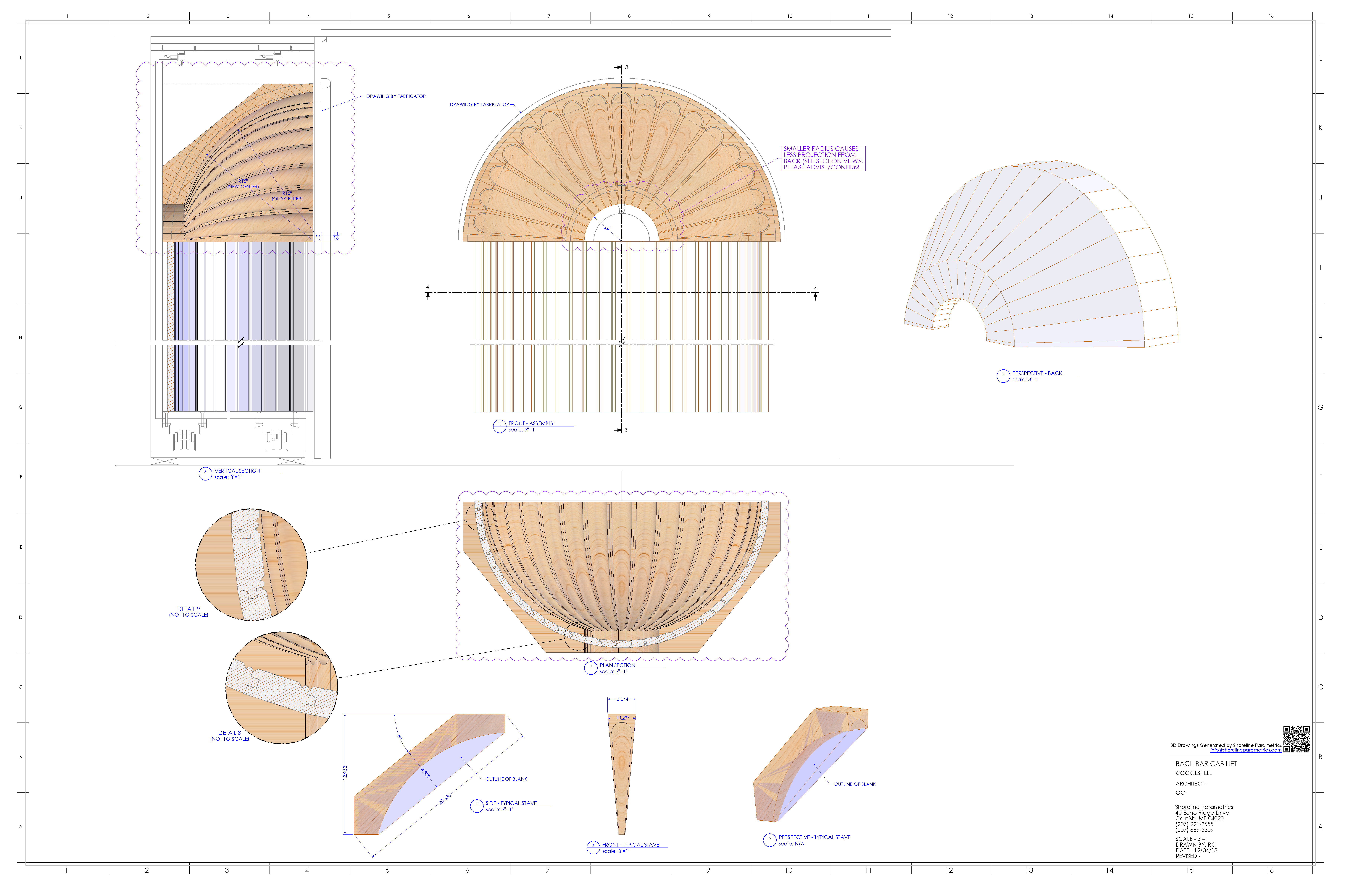

35 years ago, when doing very high end curstom work, the range of our projects required a good (and fast) 2D CAD program, but we also needed to generate cutting lists. So, we did just that, we drew in Ashlar Vellum because it was fast and we could detail everything we needed to get drawing approval AND have a good reliable set of drawings for installation. Then, once the drawings were approved for fabrication, we entered the relevant data into Cabnetware for cutlisting and CadCode. Then CV Solid came along and it seemed to show promise and we used it for several years as well.
For me personally, both packages are fantastic number crunchers for cutting lists (and then cnc), but the drawings always fell short - especially with detailed plan/vertical sections (for installation and coordinating plumbing and other trades & outsourced manufacturers). I found the only 2 workarounds were to use CVs or CWs manual drawing tools (which were cumbersone and not linked) or to do the detailed drawings in another CAD application (again with no link).
About that time I started to do ALOT of curved staircases which meant doing the work in 2D CAD (I used Ashlar Vellum which again was very fast), but given that stairs are laid out following a pitch, editing elevations in 2D CAD (despite using parametrics when practical) when floor heights change, was very tedious.
I started to experiment with 3D CAD packages, took the plunge and switched to SolidWorks.
That was 2001 and the learning curve was massive, but it's my time that was invested and I'm glad I did. It wasn't easy, the user base in the woodworking/construction industry was almost non-existant and I had to adapt alot of the software to my uses. But then that's the beauty of it - it's flexible. Now, the software is a bit easier to use and best of all, the user base is pretty broad, making learning easier (thanks to YouTube).
Once familiar with the software, users typically start to generate libraries of their materials, hardware and basic parametric subassemblies of their more standardized components (doors/drawers, stair tread/risers, etc) for dragging into their parent assemblies.
Anyway, StairCon and Compass have taken over a large portion of the stairwork I used to do, but they too have their limitations (like with CV and CW) and I get calls regulary to model twisted components which are beyond their capacities. Again, they are great pieces of industry specific software, but are always haunted by limitations.
Now as I'm probably on the final stretch of my career, I do alot of metal, wood, glass & stone projects, (often with different materials & vendors in the same stair/cabinetry or millwork job) and using a tool like SW (or inventor) makes it alot easier to manage the multiple materials & vendors - especially with flattened components and drilled & tapped holes for mating parts, etc..
I get accurate parts lists (for anything from metal, wood and hardware), I flatten curved work for CNC or templates and all drilled/tapped holes align as intended, the list goes on.
I don't believe any other type of software (like SW, Inventor, TopSolid) could be this versatile and while it's certainly not for every shop, there are some who clearly need more.
So back to the old expression:
1) Cheap - definitely not
2) Fast - It can be surprisingly so, especially when able to make use of part libraries & templates
3) Quality - Definitely. In 25 years, CAD AND communication errors have been virtually negligible and I chaulk most of that up to the software.
So for me personally, the investment has paid off in spades. I know every shops needs are different, but for me, from stairs to cockleshell cabinets (if you want to see more, my website has a much wider range of projects), this choice has worked well.
Good luck with yours.
Cheers,
Rufus
View higher quality, full size image (7236 X 4824)
Examples of Projects using 3D Modelling Software (SW)
