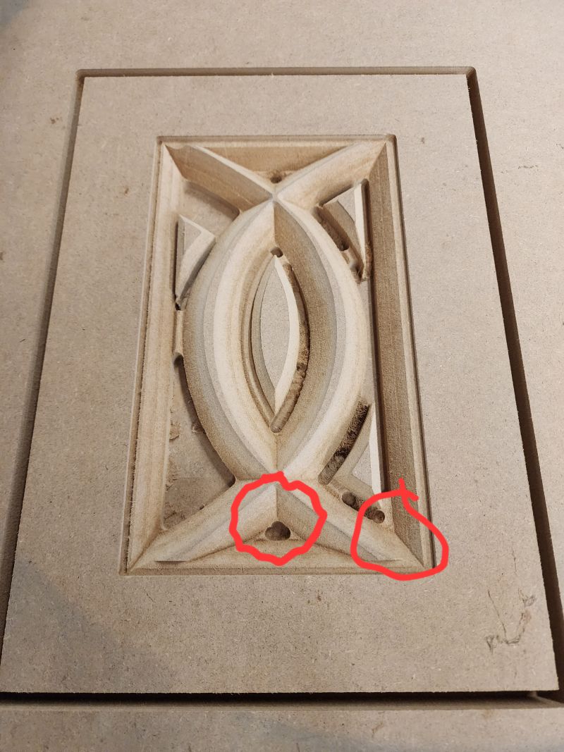

Hi, I want to use a 90 degree V bit to chisel sharp inside corners using AlphaCAM Advanced Router. For the life of me I can't remember the last time I needed to do this.
Can anyone help? I presume polylines are in the mix. This sort of thing is simple in Vectric, but the modeling presents other issues.
Any help appreciated. Thank you.

Frost CNC, has a 1" cut .25 shank .125 dia coated bit that will remove the balance of what the larger bit did not. if you want it sharper than a .0625 radius you can use a small 3 sided file https://www.frostcnc.com/
3/30/23       #3: assistance needed with inside bevel ...
Use 3d Engraving. Works on any V angle tool that you have defined.

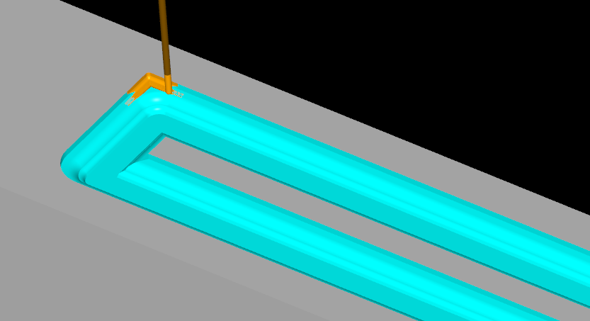

Use a smaller tool and previous tool profile pocketing op

Kuznechik
Ian, is there any way you can make a video or a few picks on sharp corners,,i have really struggled with this especially with MDF doors,,,,,before we got our router and alpacam would just rough out pockets and apply the modling,,,,
thank you
6/30/23       #9: assistance needed with inside bevel ...
Ian
Here's a fully comprehensive video directly from Vero
https://https://youtu.be/YnYp5twc9Co

Ian
https://youtu.be/YnYp5twc9Co or search alphacam use previous tool profile video. Not sure why the link doesn't work, but search shows it
