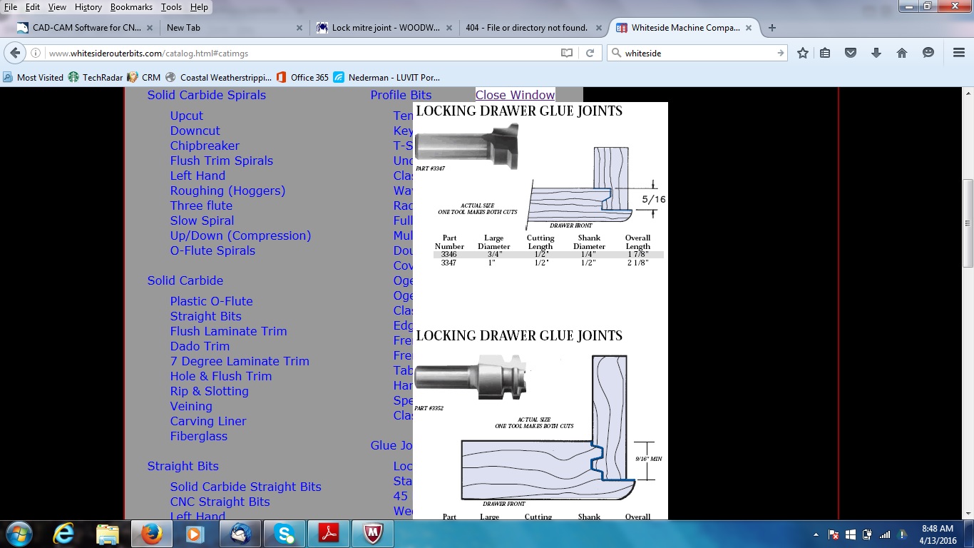

dylan bayliss
check out whiteside tool
View higher quality, full size image (1366 X 768)
4/13/16       #8: Lock mitre joint ...
Conor Devoy Member
Thanks for all your suggestions, as far as I can tell the Titman tool in my original post allows you to do both cuts while the pieces are stuck down to the CNC bed. I want to avoid having to do a second pass by turning the drawer side vertical on a router bench or spindle. Thanks Conor
