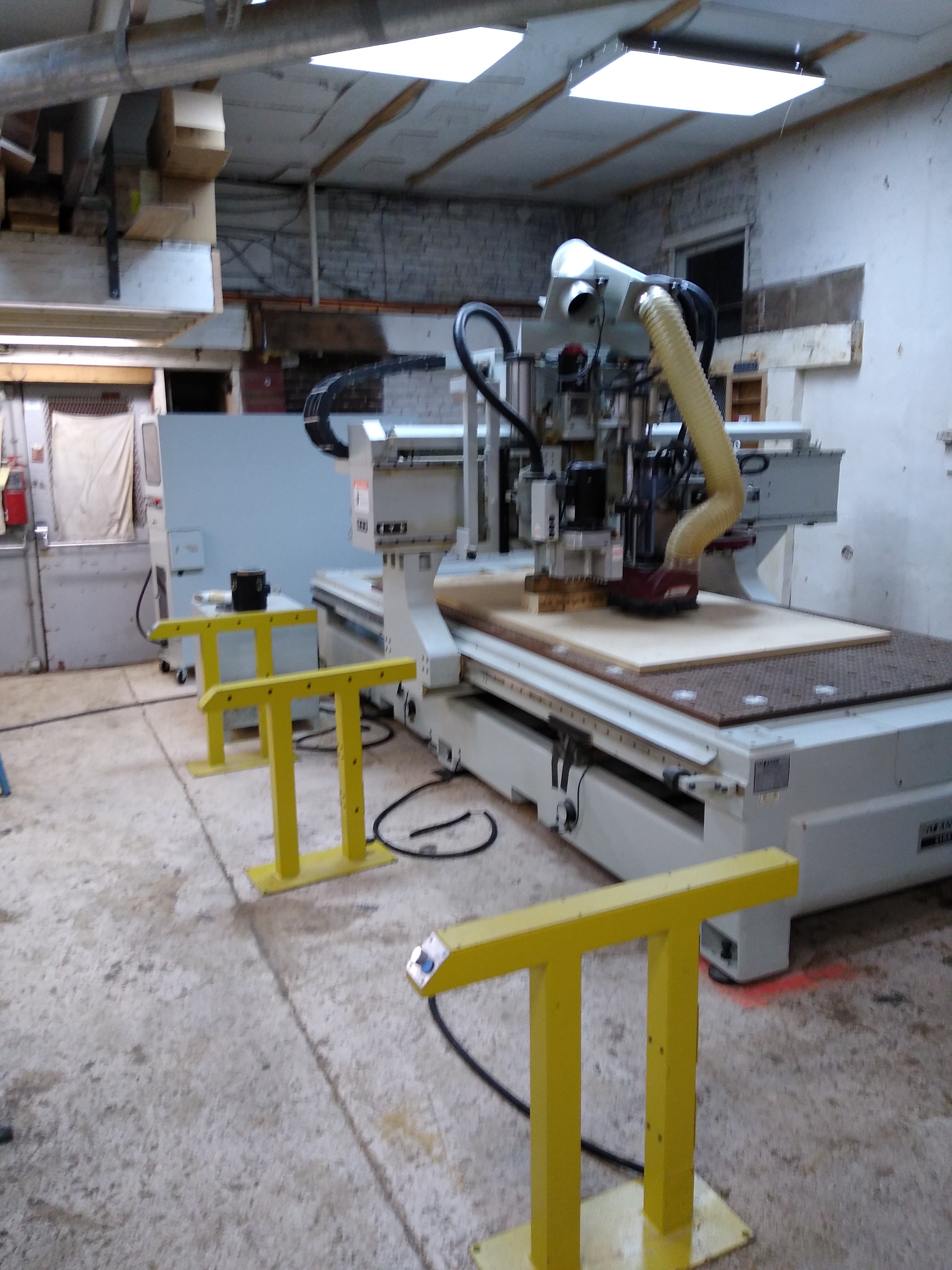

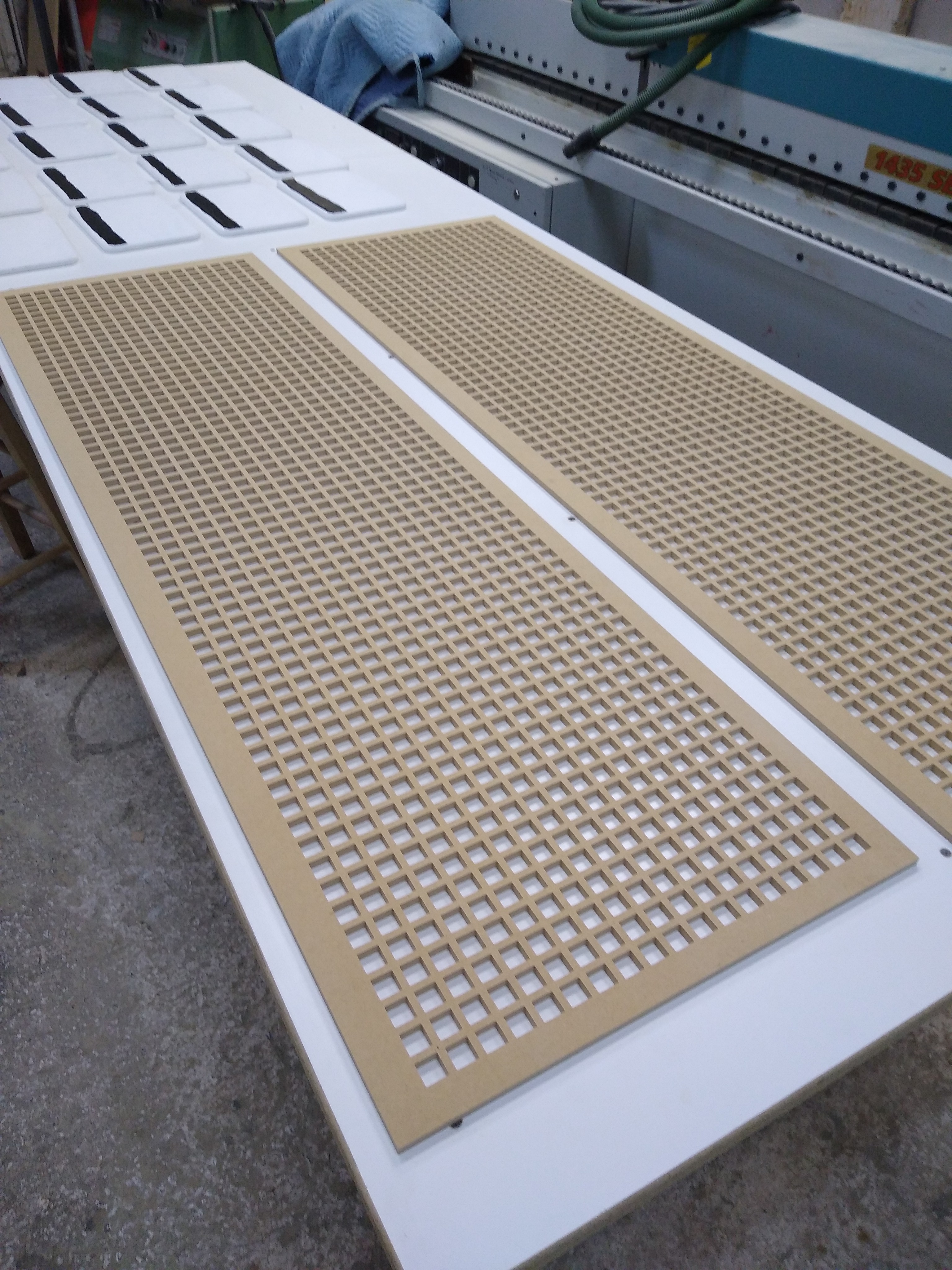

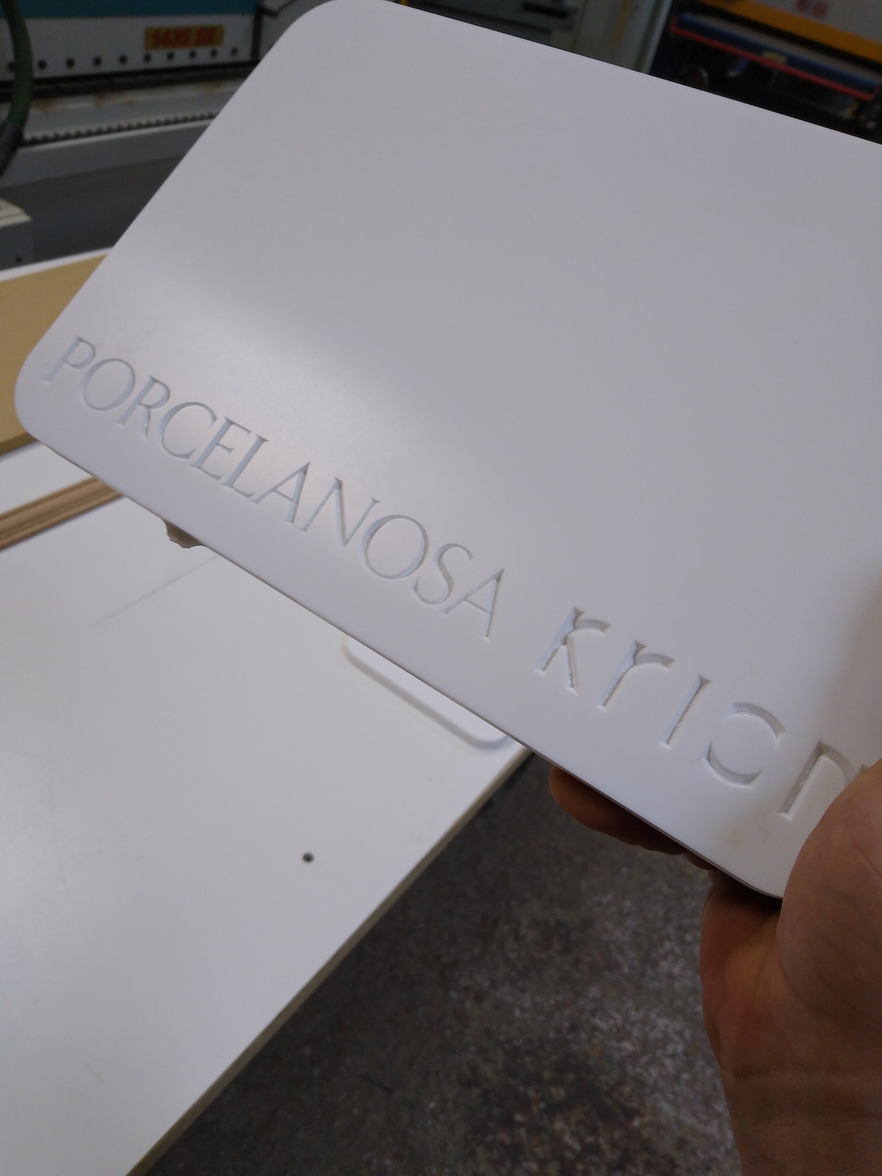

quicktrim
FWIW I bought a used Anderson stratos this year at auction. Assembling the gantry after moving I dropped it off my forklift and bent the linear guide rail.
It was a stock part from Bosch/Rexroth and I had it in my shop in two weeks for 325.00 and I placed the order and replaced the part myself no tech needed.
Then I found a great tech in another state and we did everything over the internet, training, adjusting, working through setting it up after moving it three states.
I got my posts up and running with the tech as well and am now cutting parts with it.
What the above poster stated is true the ball screws have been proven to be extremely accurate. The first three parts I cut had 1600 3/4 x 3/4 holes in them with a 1/4 space between them and I ramped in with a 1/16" bit for the final pass to clean the inside corners and the finish was flawless and perfectly consistent from one end to the other, no tool marks whatsoever.
This from a machine that I moved and set up myself from three states away and dropped the gantry , replaced a guide rail on etc.... needless to say I was super impressed and all for less than the cost of a new shop bot. It only cuts at 900 ipm because of the ball screws but I am a one man shop so I have not found that to be an issue.
Also it is a straight G code machine so no issues trying to deal with some euro work around on the machine control.

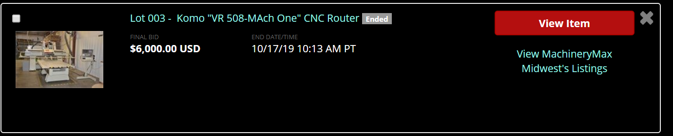

The Komo seem plentiful at auction, I don't like that they take 300 sq ft, I like the company and the people seem terrific and the Fanuc controller are big pluses.
The Onsrud would not take up as much room Onsrud seems like a good company I have used machines that had the AMC controller they seemed fine but if they are no long being supported that is a show stopper.
This picture shows a 2004 at the top of the picture and a 2016 at the bottom notice 0 bids for the top one and 8 for the bottom one with 14 days to go

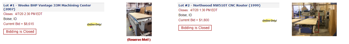

Check this out, sold this week 2007 Weeke with offloading and two 2014 becker vac pumps and an older northwood for under 2k there are some good deals out there to start CNC on a budget for sure.
View higher quality, full size image (767 X 183)
View higher quality, full size image (1453 X 185)

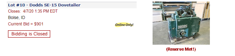

Not sure of the value of the Dodds if you have to dovetail drawers it seems like cnc would be the way to go.
The Northwood could kill you on parts
Not sure about how long a Weeke, 10 years?
That is my take on it, but I could be wrong
