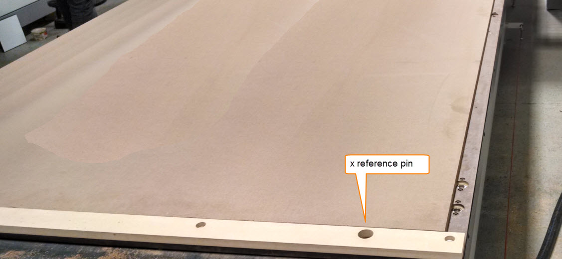

The unloading device drops just outside the reference point for the panel. It "rides" on the spoilboard. This arrangement has the advantage of not requiring adjustment as the spoilboard thickness changes but does require a "landing" for the device. The attached picture shows a strip attached with the included nylon screws and machined for the X reference pin. I'll send you the program to make the strips.
Bill

I have my machine set up to do all of my panels on the left of the machine. I guess I'll just have to use a longer spoil board?
