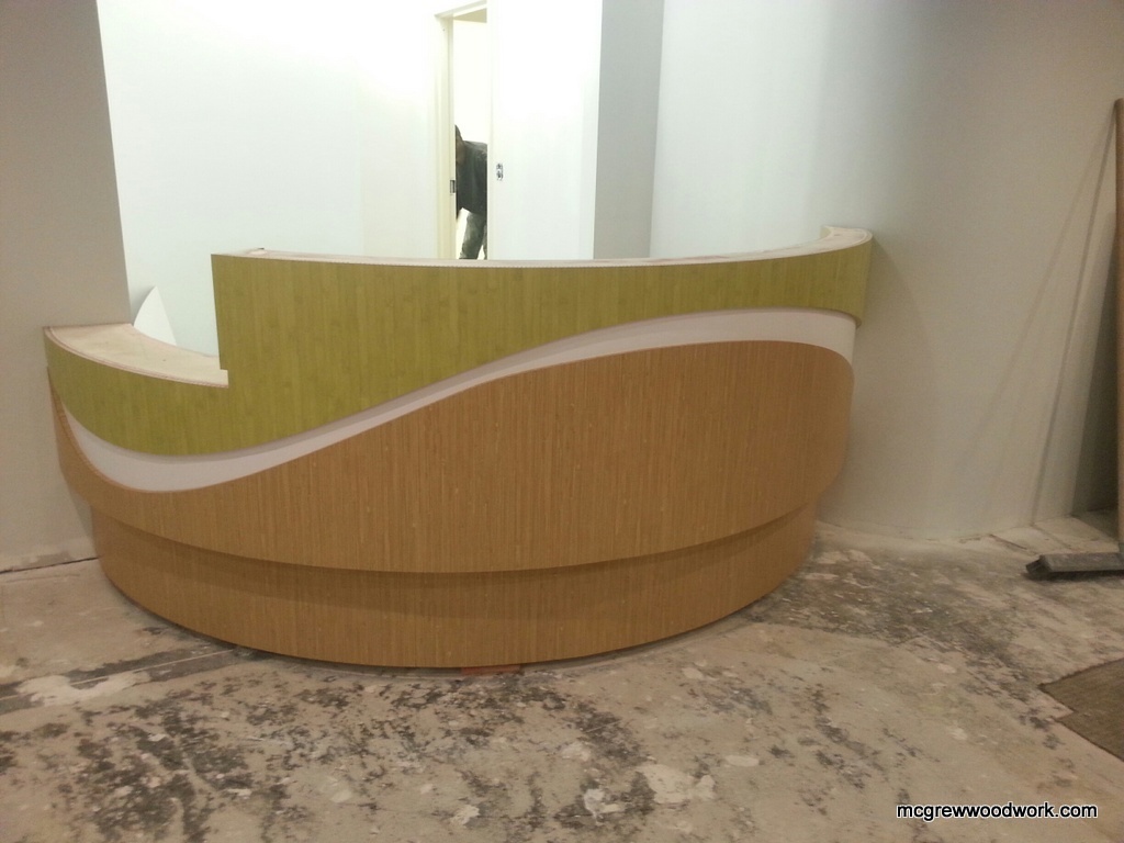

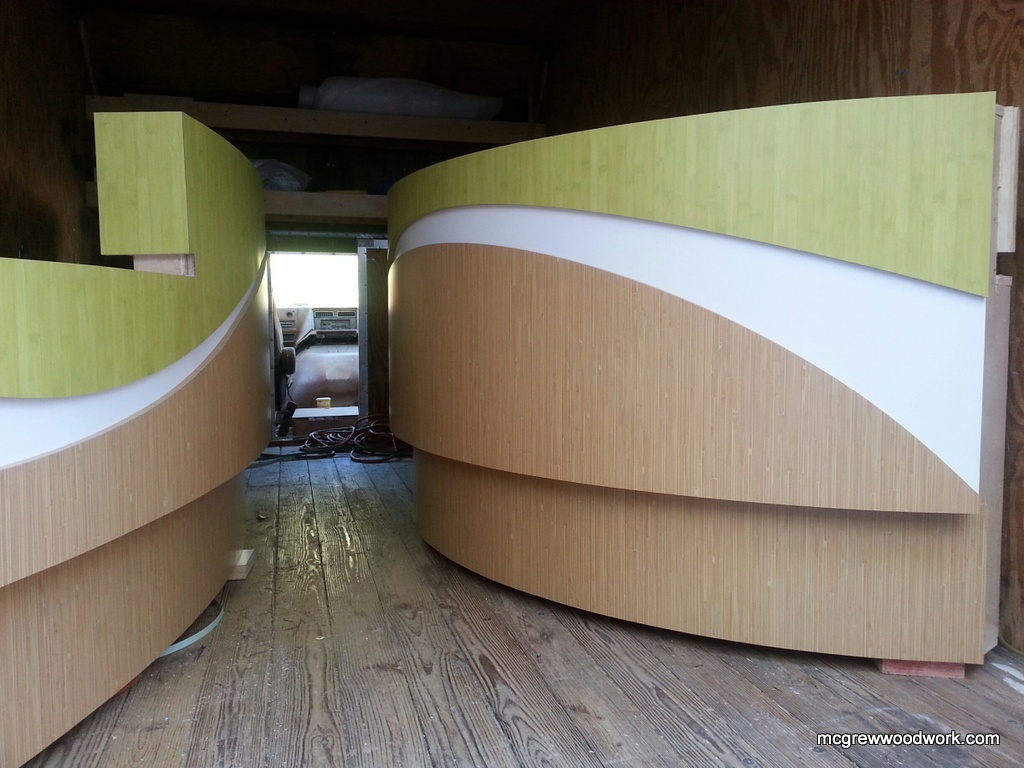

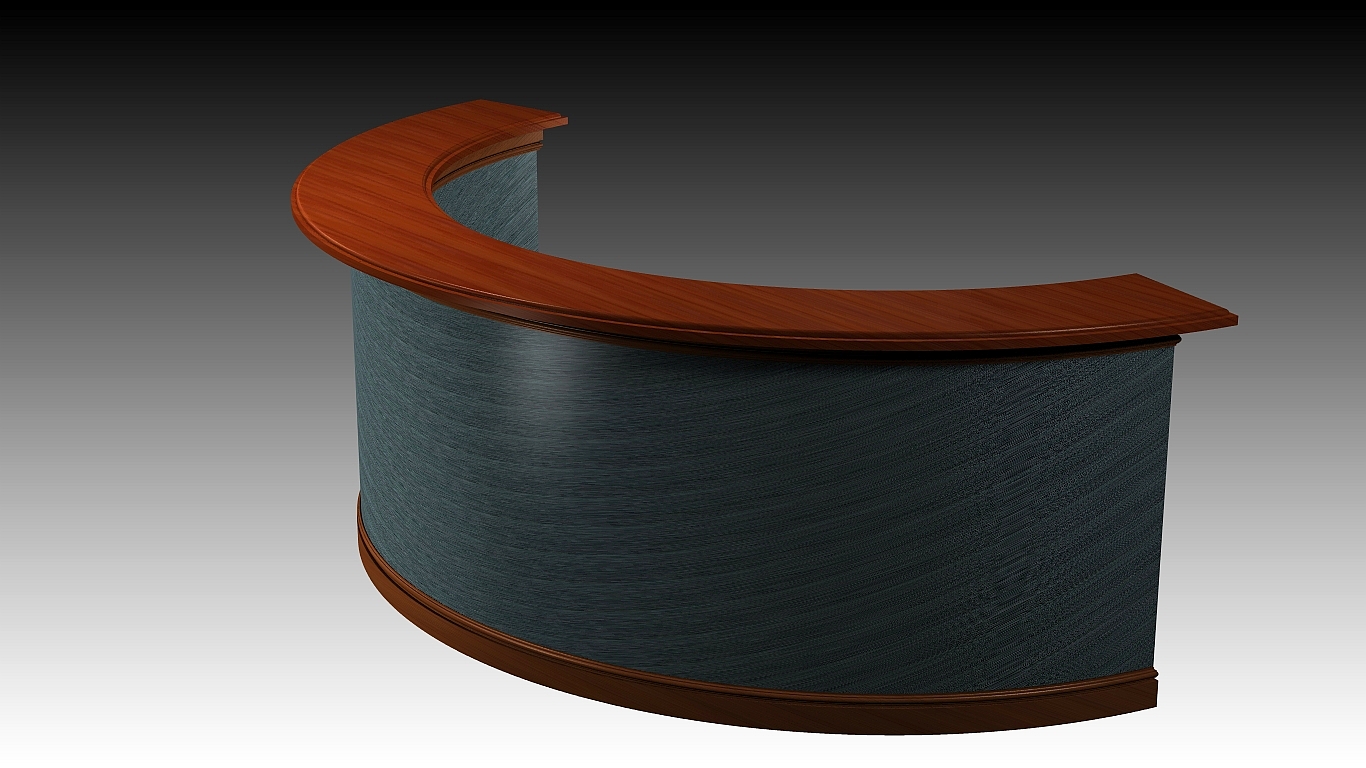

one cute note,, on those radius desk I made the dxf in Aspire (2k) and could have done it in VCP (600.00) I layed out the vectors (more on that later) in the pattern I wanted divided it up by sheet size my machine can handle (Ex 4x8) he cut them upside down, doing it this way the radius face parts came off the machine kerfed and cut to form.. Made quick work of those face radiuses..

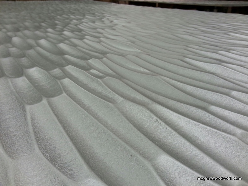

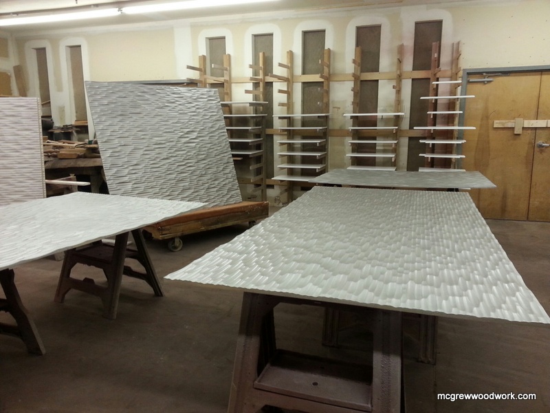

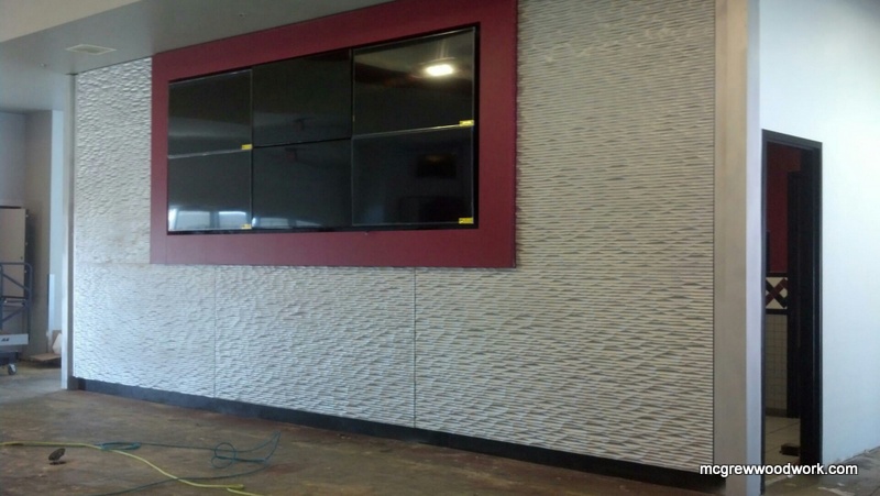

love making sculpted panels as well !!

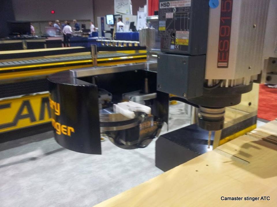

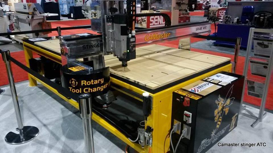

Here are some pics of the new 408 ATC camaster has built, At this Price they are gonna continue to "Change the shape of things"

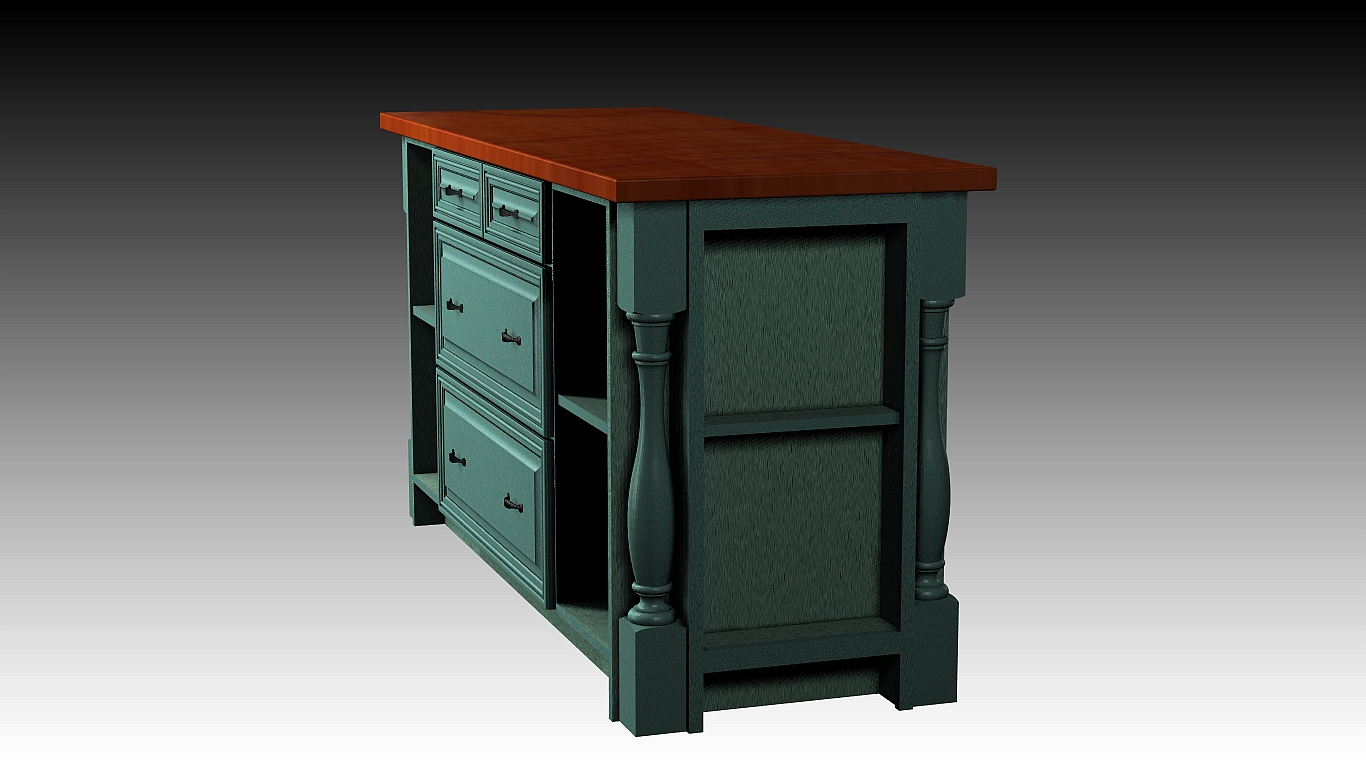

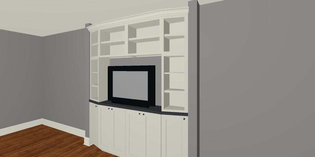

While I admit this is meant to be about machines.. How would you approach a really simple job as this. (if cpp can do angled cabinets like this I recant my post) (but I still need something to show the customer to make the sale so cpp is not one stop shopping)
I can draw this in a software package from a customer sketch in 5 minutes. Corner cabinets are on some random angle based on fixed dimensions from the space and customer requirements. This is not a rocket science project. I really really really dislike the idea of having to draw this or type in dimensions twice.
Ps this software is 1/10 the cost of something like cv and kcd.

I don't understand why you wouldn't like eCabinets. Here is the Island on your website ready to cut on the ShopBot or a Thermwood.
You can also do angular or circular work.
