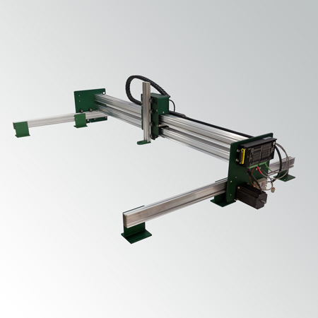

Has anybody seen this machine in action....new company? Awesome price? Just looking for feedback before buying. I currently have a self made machine bases on jgro design. ..little machine cost me half of what a 3 x 8 machine costs from this company.
http://gryphoncnc.com

That is at the lower end of even being a hobby machine. Really a toy in my opinion, so toy pricing.

Tell me why this is a toy. It's gotta be more accurate than the little machine I built. OR Not....what am I missing? I see there are no lead screws.....

You could build the same thing cheaper with help form the guys at cnczone.
It doesn't even have a "table". Save your money.

They show a Dremel as the spindle. Vbearings run on aluminum. Those are the first two indications. Don't you subscribe to the law of you get what you pay for? You are asking about that class of machine on a professional woodworkers forum, most are either going to ignore the questions, or the rest are going to consider it a toy. I ran a 5 axis MotionMaster with 5'x10'x3' capacity before retiring, it's a toy.

With the flex, Inertia and Dremel you could cut dollhouses out of .125" and make posters and stencils with the sharpie.
I am not trying to be funny, I will go here , If you can afford to chuck the money then building any machine will have an educational value.

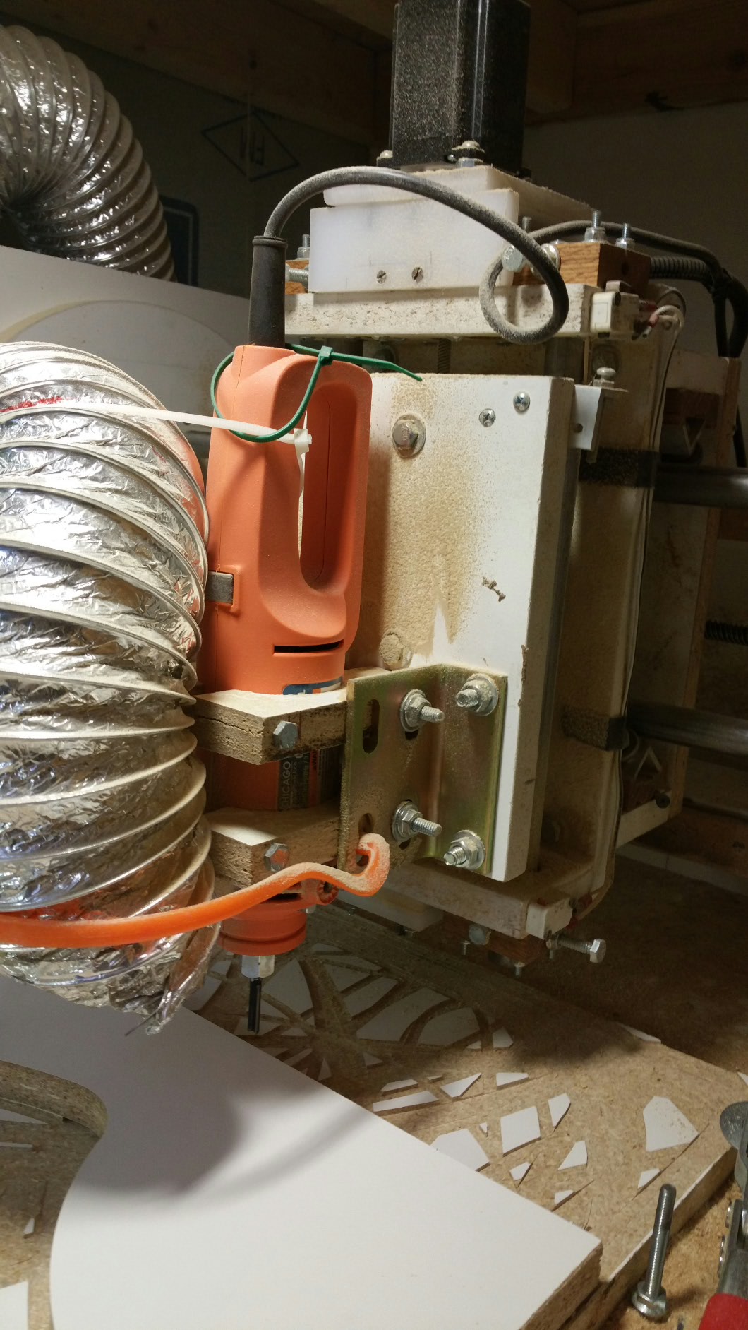

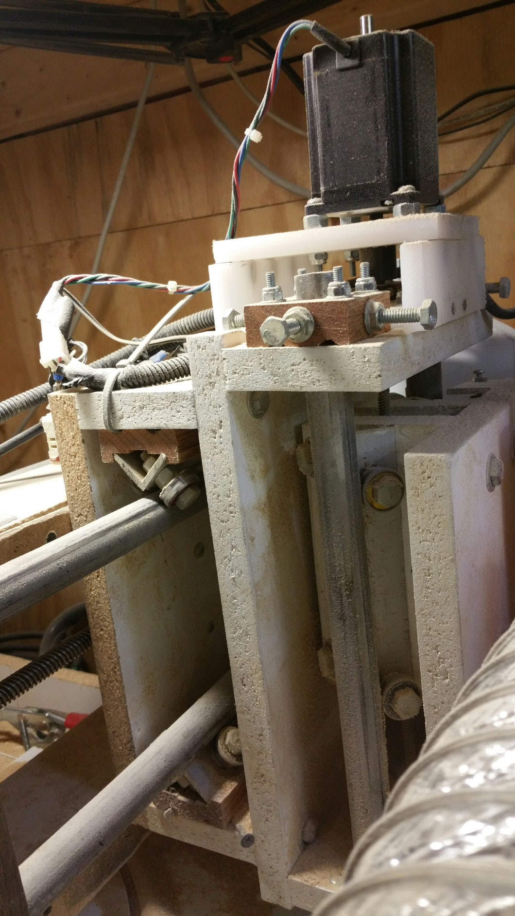

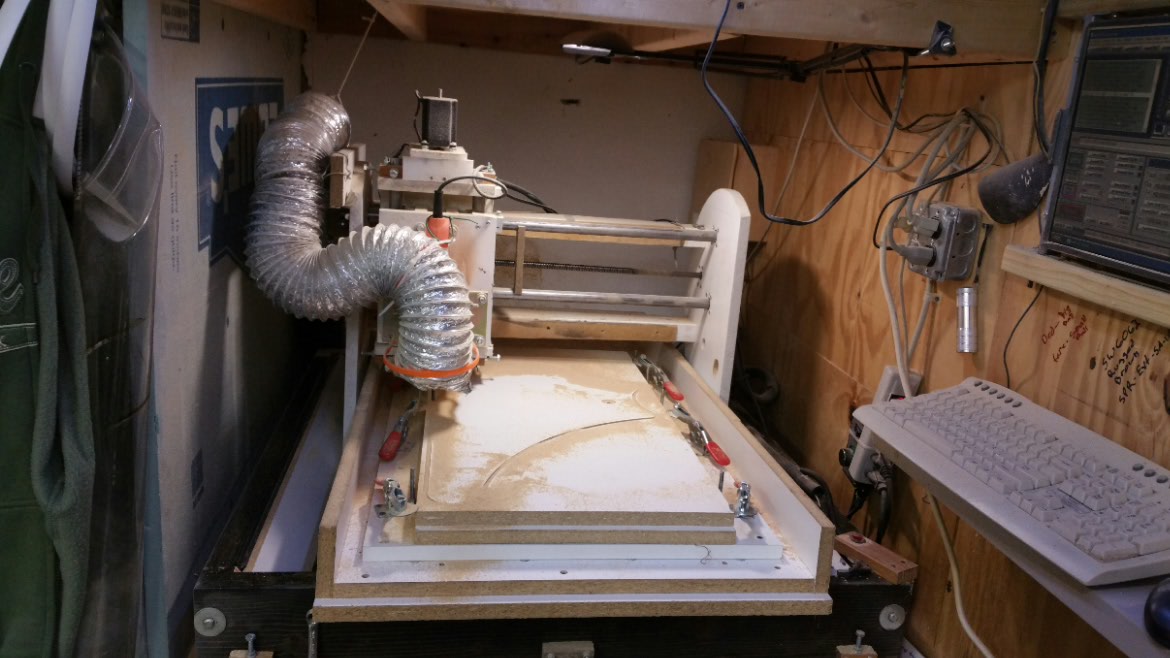

Todd Brink Member
Here's a picture of my little workhorse.
View higher quality, full size image (1170 X 658)
View higher quality, full size image (1060 X 1883)
