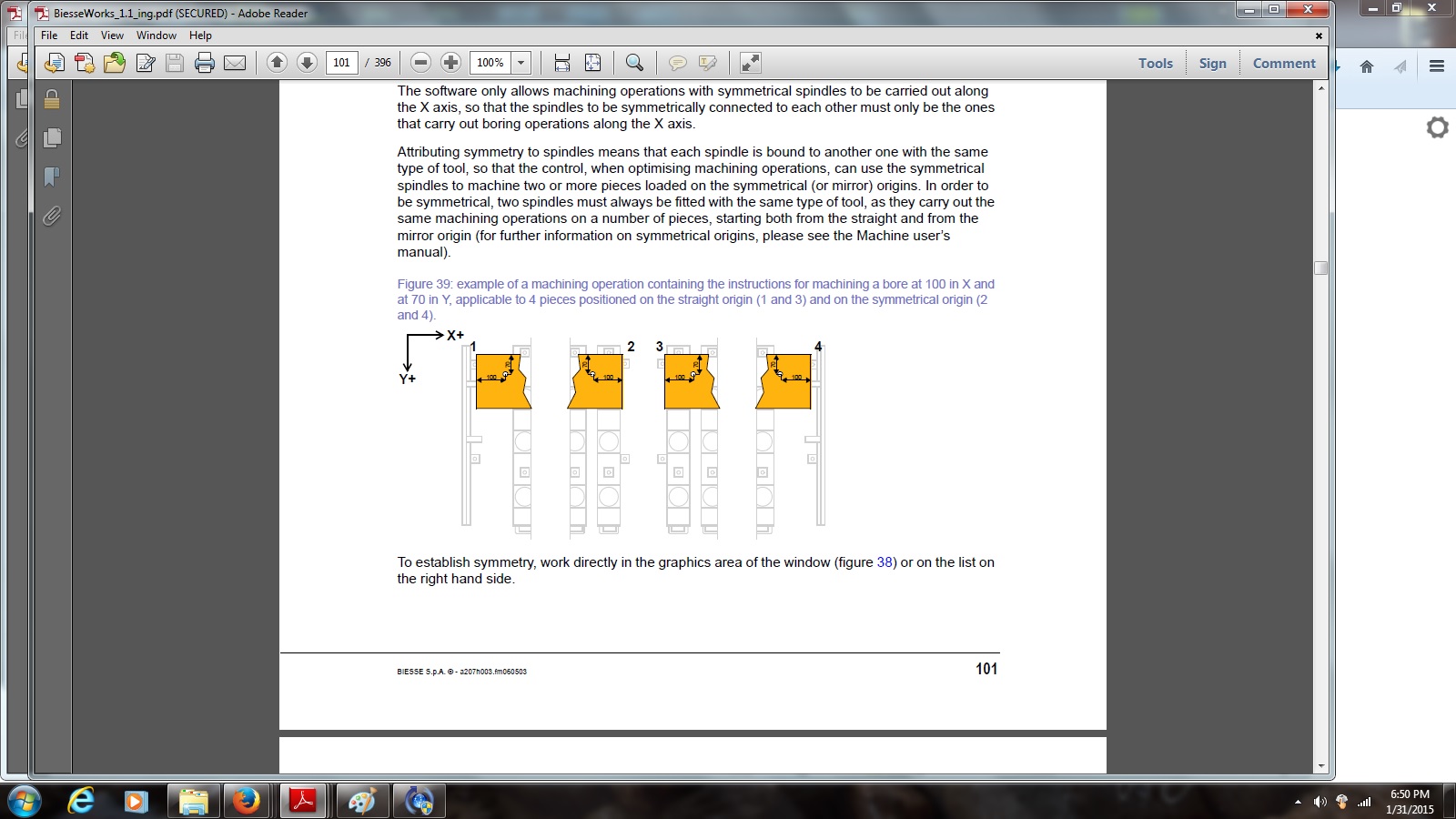

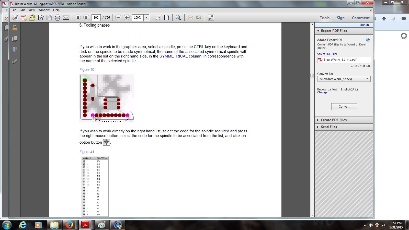

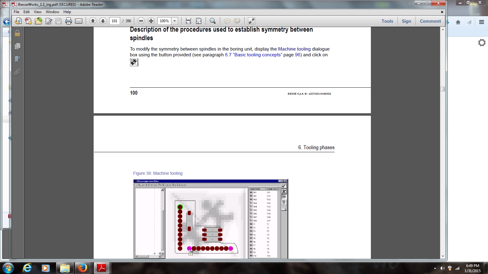

it looks like your drills are not set up for symmetrical drilling..the ones one the left should in the drill setup have a mate that is symetrical to it..Ie 1 to 10 if in vertical drilling. I attached the pages from the manual..you need to look at machine configuration ck the symmetry for the horz.
good luck..as always..service@biesseamerica.com is also avail.
