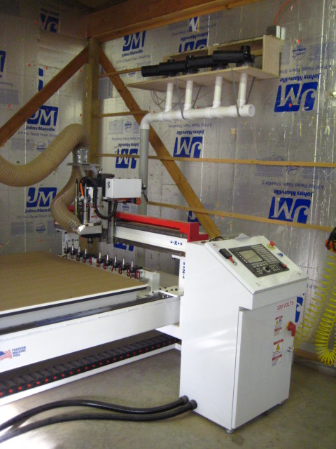

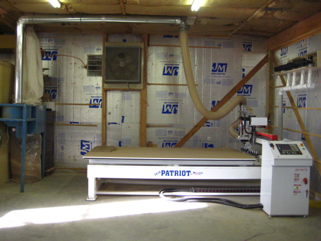

I have a Freedom Machine Tool 5 X 10 router with ATC with 10 positions. They are a subsidiary of DMS routers out of Colorado. I found them here on woodweb forums. Excellent machine with great customer service . The owner of the company even paid me a visit here on the east coast. I know and keep in touch with 4 owners in my area. They are all cabinetshops with the same machine. Being new to the cnc world, customer service and local owners were very important in my decision to go with them and have no regrets. For the machine I got with the Fagor controller, I think it was a great deal.
