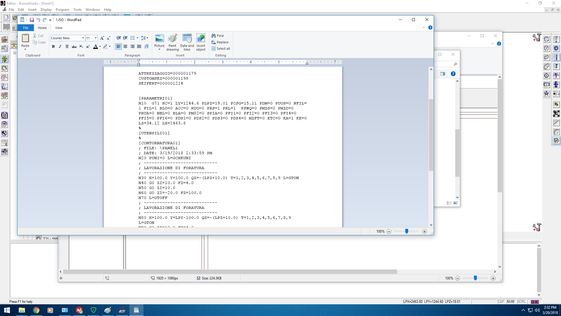

3/20/18       #13: Biesse Rover321 needs post for Bies ...
Chev
althought,,,an udate for that 321 controller may work with iso out in ,,ive upload a sample,,,not sure if editor in that verion will open this but give it a whirl
