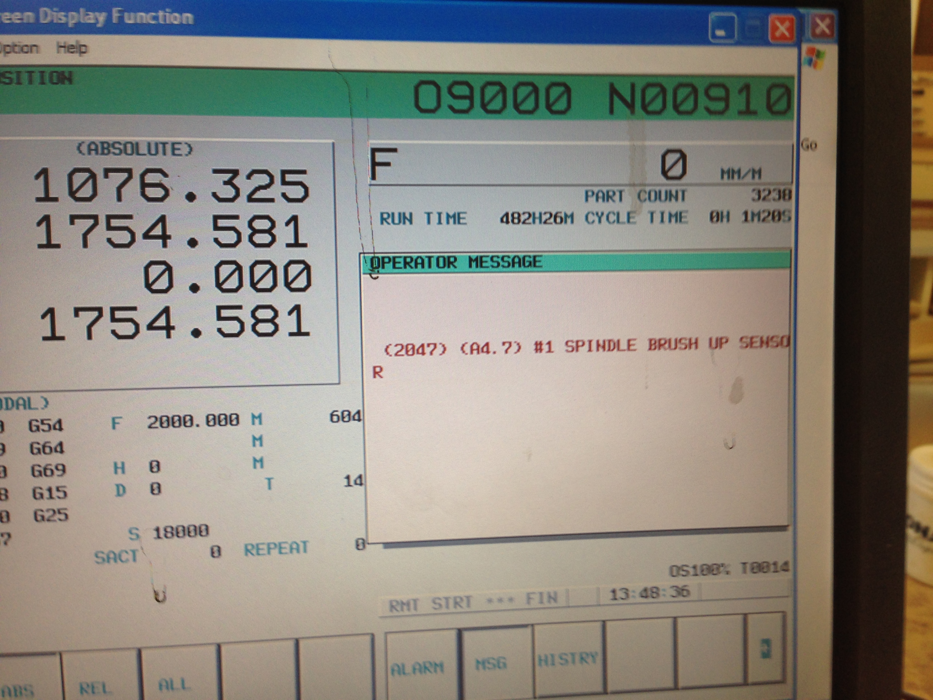

Hi I have Omnitech seelex pal CNC
and its shows error :
(2047) (a4.) 1 spindle brush up sensor error
Any idea what is wrong ?

cabinetmaker
If you need to lift dust boot to make a tool change the senor on the cylinder may be jarring or out of position. Look @ the schematic of the machine and see where the diagram leads you.

Bob Member
I just adjust sensor little bit lover and cnc working again
