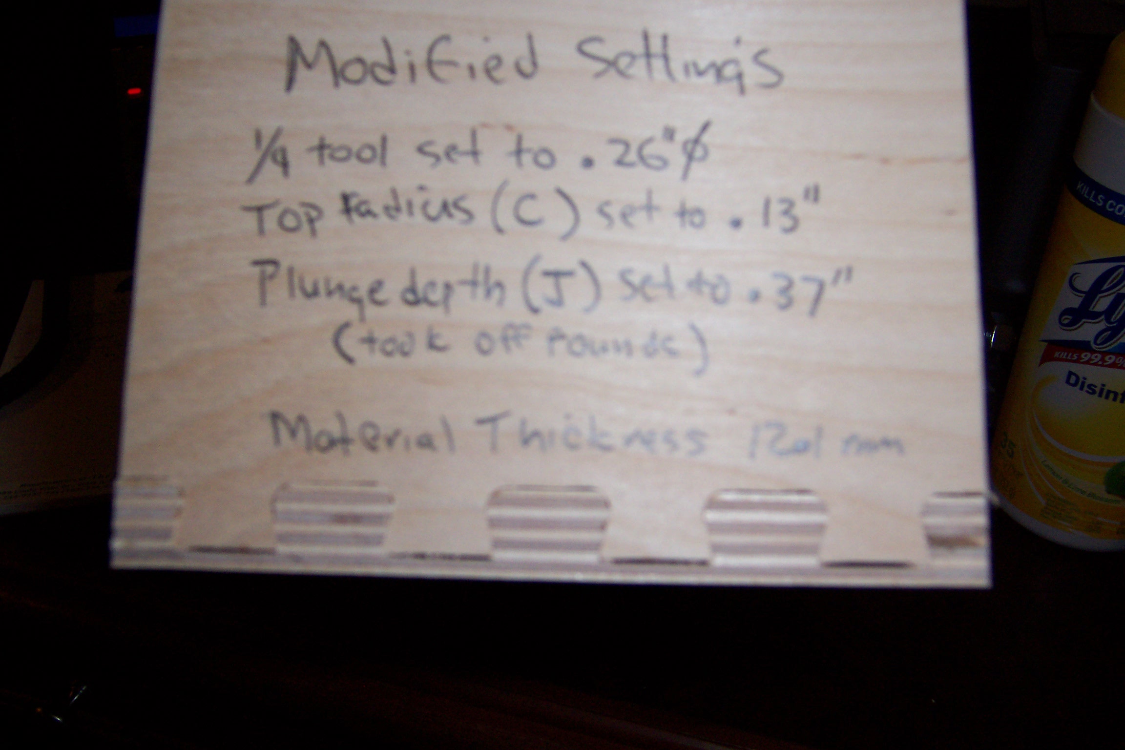

Anyone using a Vortex 7600 with CabinetVision, we are setting up a Flat Table and the Coordinates are a bit off, any help with parameters would be appreciated

Hi Kevin,
I see there is a gap at the bottom the tails is ther also a gap on the top? If so does it look like the radius is fully rounding of the top edge or not? I have seen it before were plunging slightly deeper (0.01) allowed the radius to fully round the top and allow a proper fit.
Do you have any detailed specs from vortex? Perhaps they could provide a DXF so you can confirm that your tool settings are correct or not?

Hi Richard,
I have received a pdf. from Vortex and will be trying another setup this weekend with a material that is a bit thicker (5/8), we were setting this cutter up last week and found we could not quite get it perfect,I had an integrator at the Shop and was letting him set it up, he is gone now and I will push on alone and try to get it dialed in
