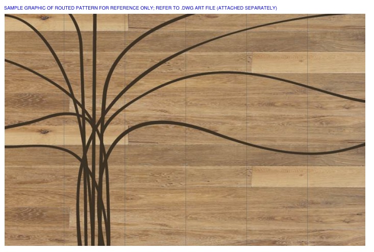

Is anyone using Vcarve and Weeke Woodwop 4.0.
We have a project with some artwork than needs to be machined and they provided a hatch pattern which translates into thousands of small lines. The pattern is about 13' wide on 6 doors and needs to match edge to edge

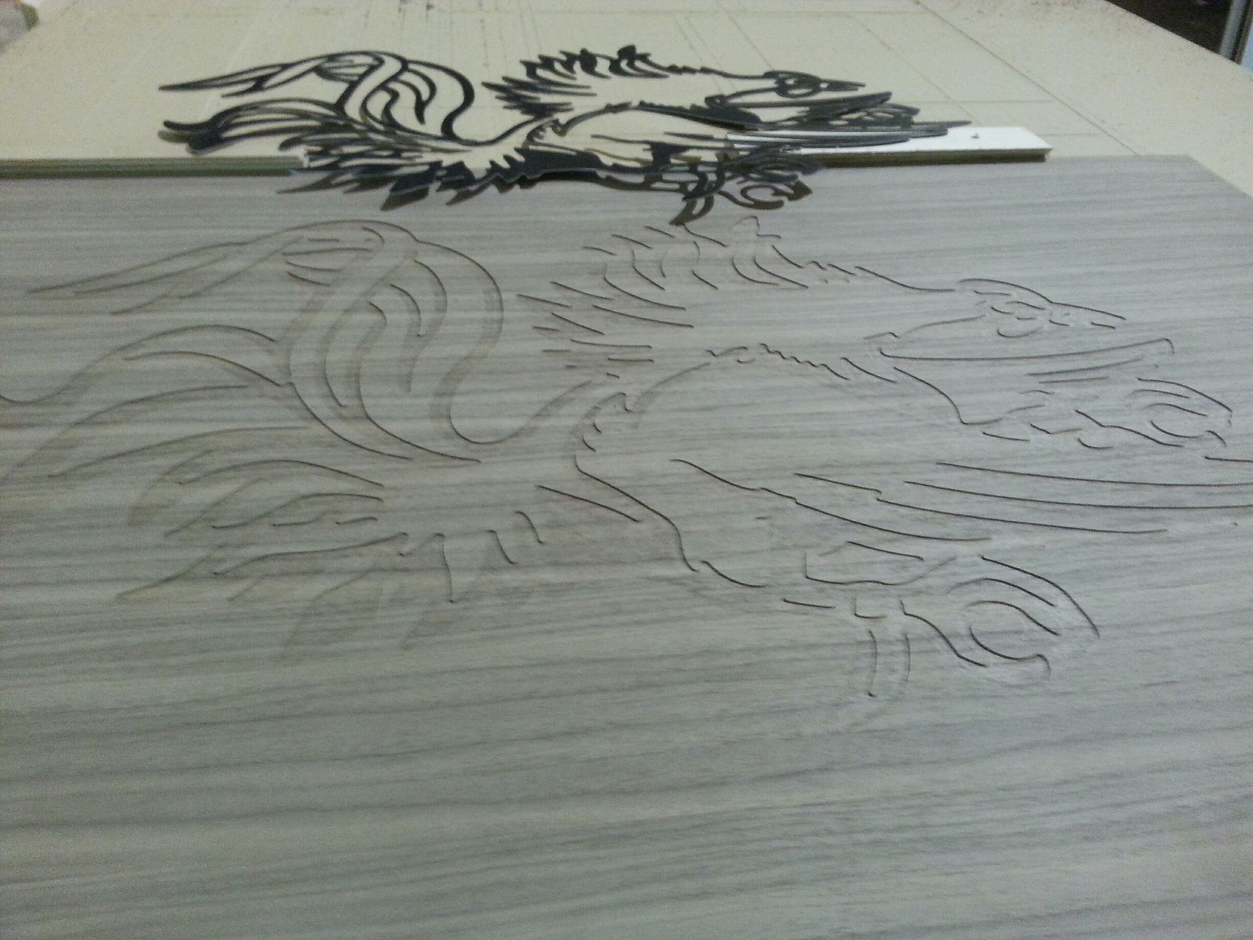

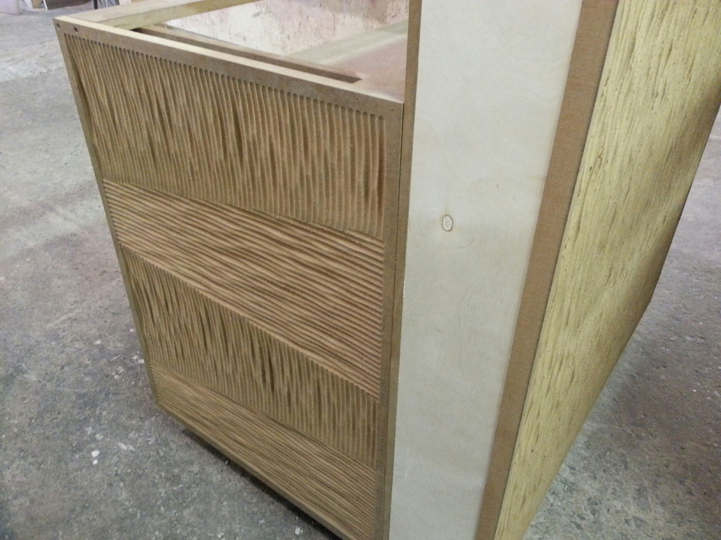

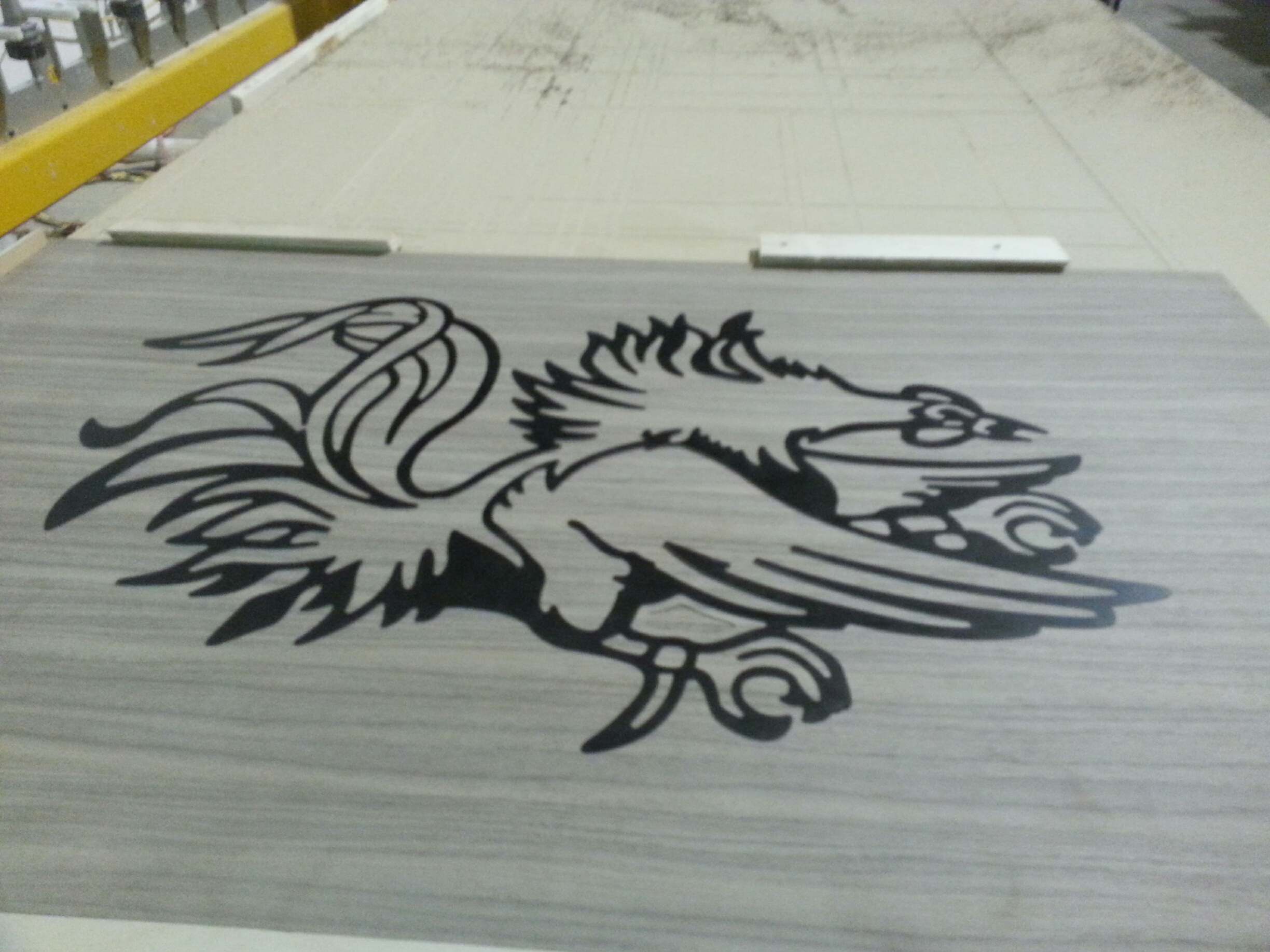

You can go to the site and download the demo full work version to test your machine and post processor before you purchase, I have done some cool work with this software, feel free to call if you need.
Below are inlaying wilsonart oil rubbed bronze metal plam into Walnut for the face of a desk. and using texture tool pathing for the side of ticket stations at the Zoo
View higher quality, full size image (2448 X 1836)

Will we need to clean up the drawing or can Vcarve convert the hatch pattern as is to a polyline for the Weeke?
If I need to clean up the drawing and convert via pedit then I could use BPP
Alan
