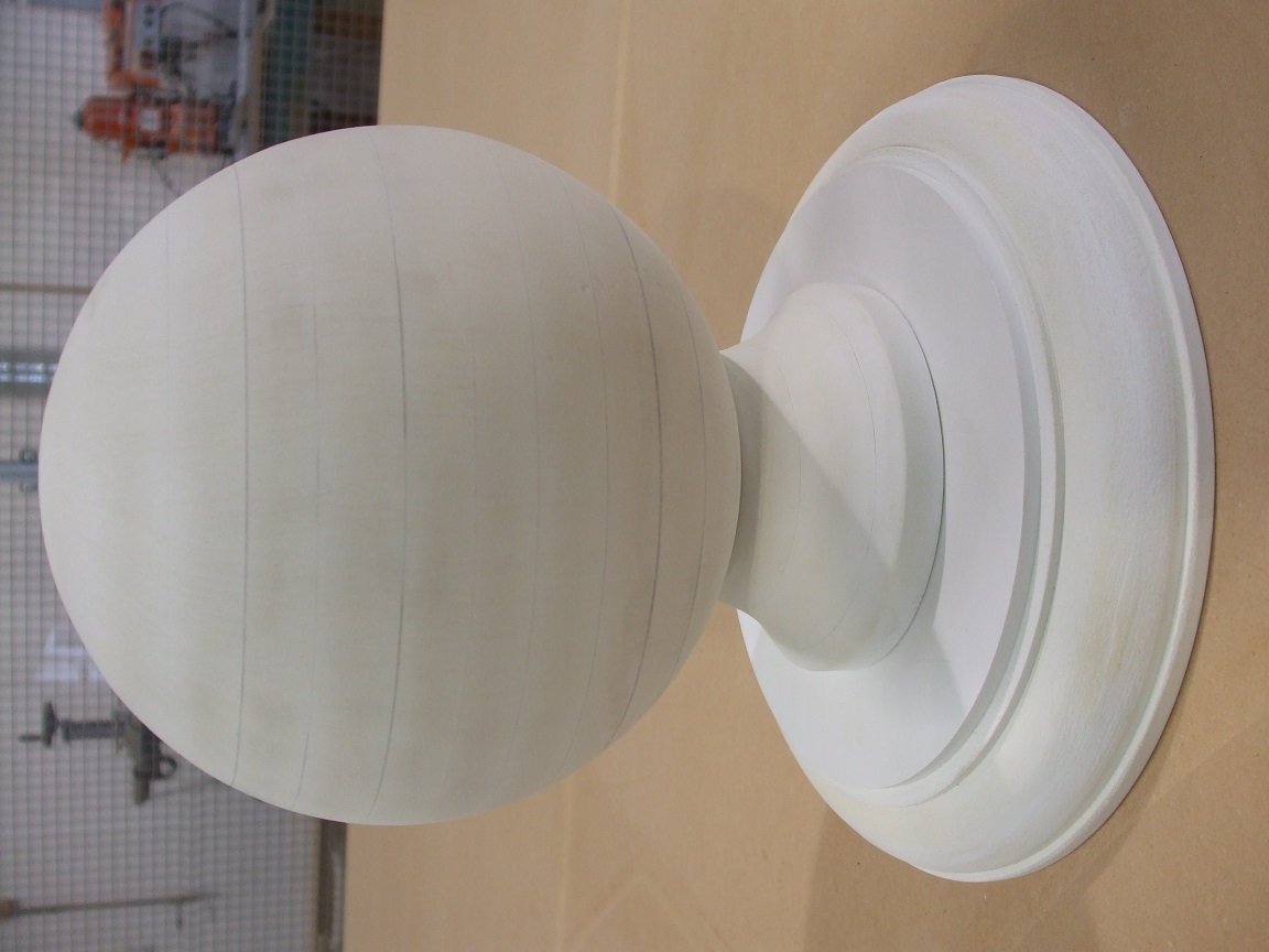

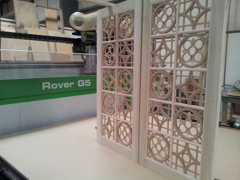

J Wilson  Member
Jason
I sent you a message back over at cnc zone. We have a Biesse Rover G and have been running code from Aspire for 5-6 years now with no problems. I can send you the post I am using that has been tweaked a bit. You would have to REALLY be careful and run some tests, though. Cesare at Biesse is a good man. They (Biesse) have always been able to help me out when needed.
John
